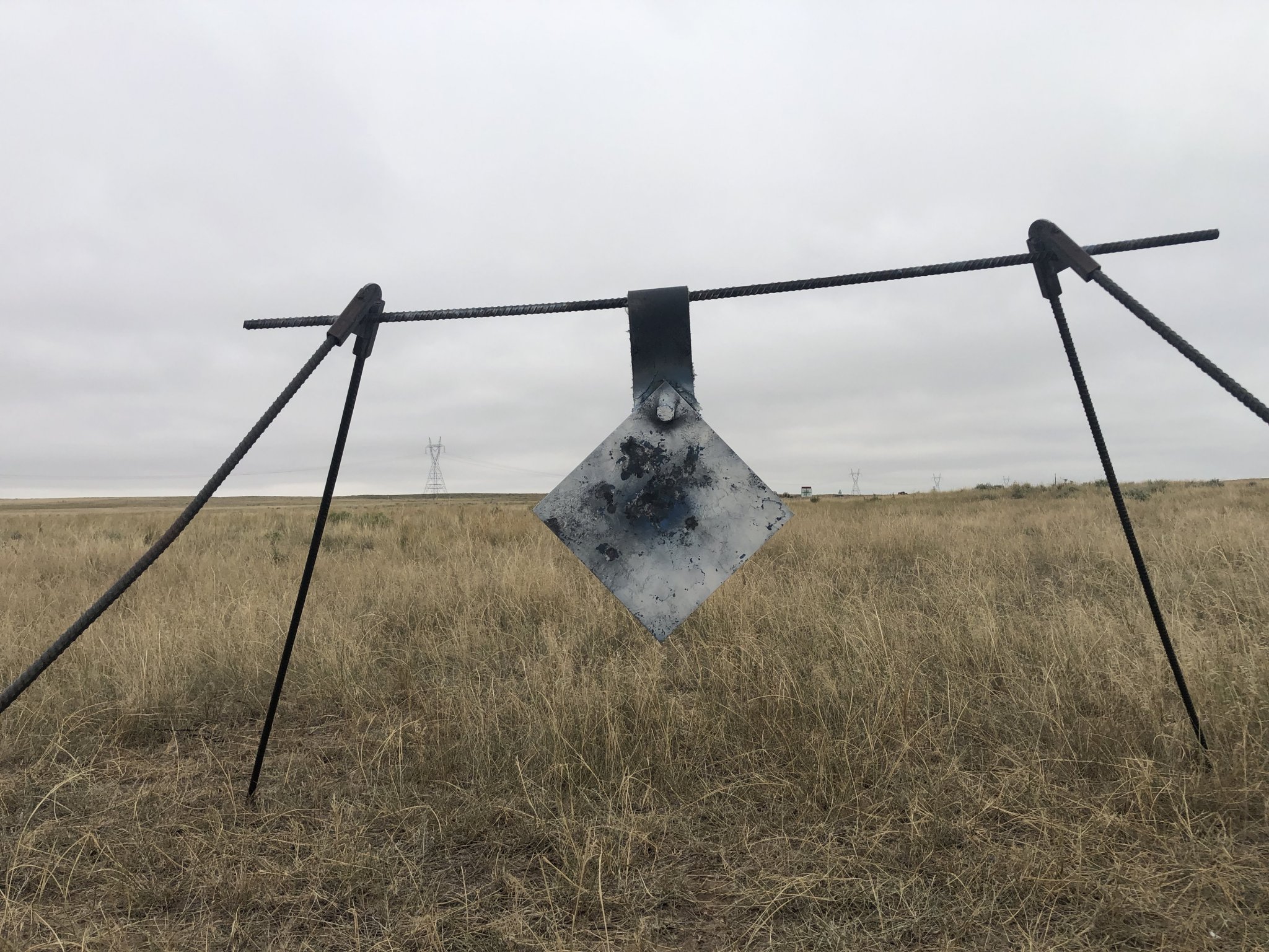

    The targets are AA Targets Rebar Stands with hanging diamonds circles or rectangles hanging on black straps. The targets are not painted and can easily blend into the terrain. In most 1x 6 stages, 4 targets are pretty easy to find, 2 are usually hidden in the bushes. You basically look for the straps because nothing else sticks out.
    This is on my range and painted, but picture this unpainted and rusty,
    So, find it, range it, engage it, on the clock for two.

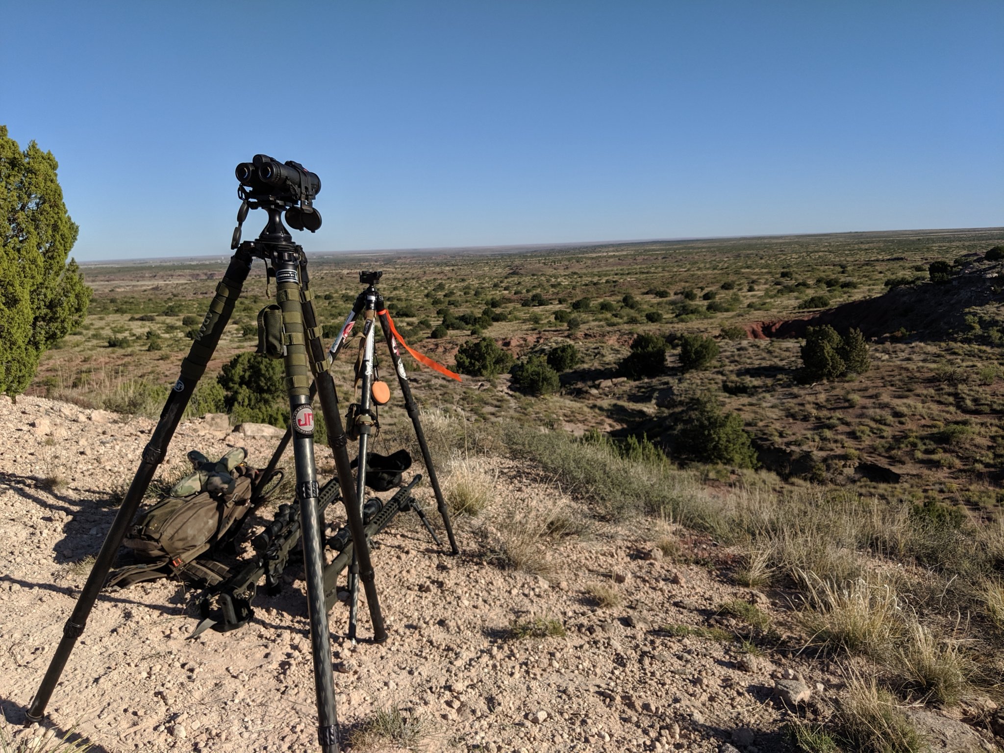

    LRF Binos,
    I used the Zeiss RF 45s and Adam used the Leica pictured above
    Ranging at the same time you find it is key, you honestly can have a ton of time, but most of the stages, you finish on the buzzer.
    The guys that shoot this often do really well because they can recognize the terrain and target patterns, this being my first event, it takes about 3 stages to recognize it at first then it becomes pretty standard, but the hidden targets are still super tricky.
    Binos are perfect for this

    A lot of guys are running Crux Tripods, they are bigger and heavier than RRS, but the Army is using them too
