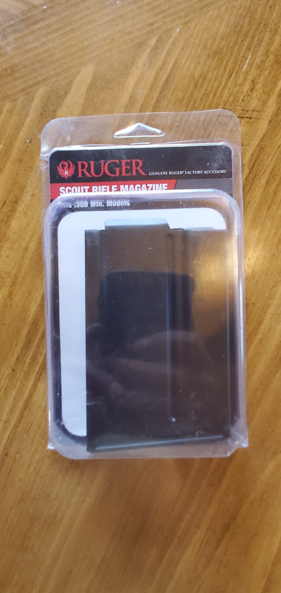

    They are the same magazine as the accurate mags but stamped with a ruger logo. Frank seemed to have good luck with them. The box is slightly narrower than AICS mags (from what I've read) from there it's just getting the follower moving smooth and adjusting the feed lips.

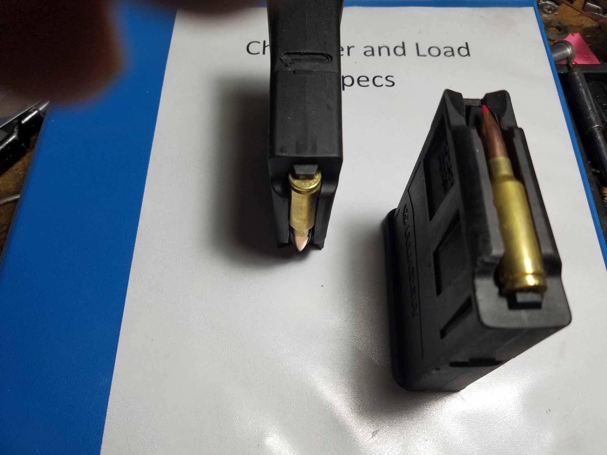

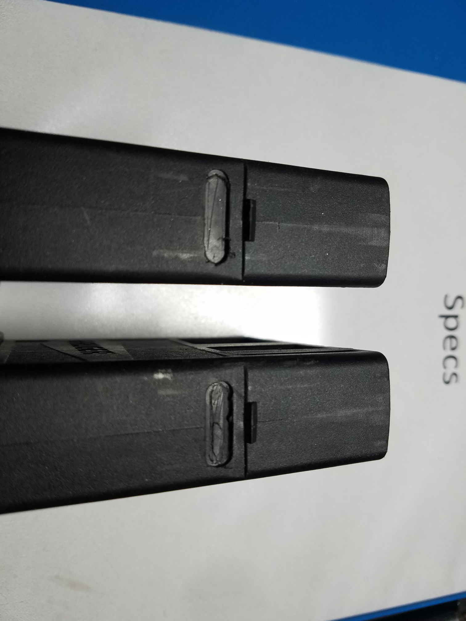

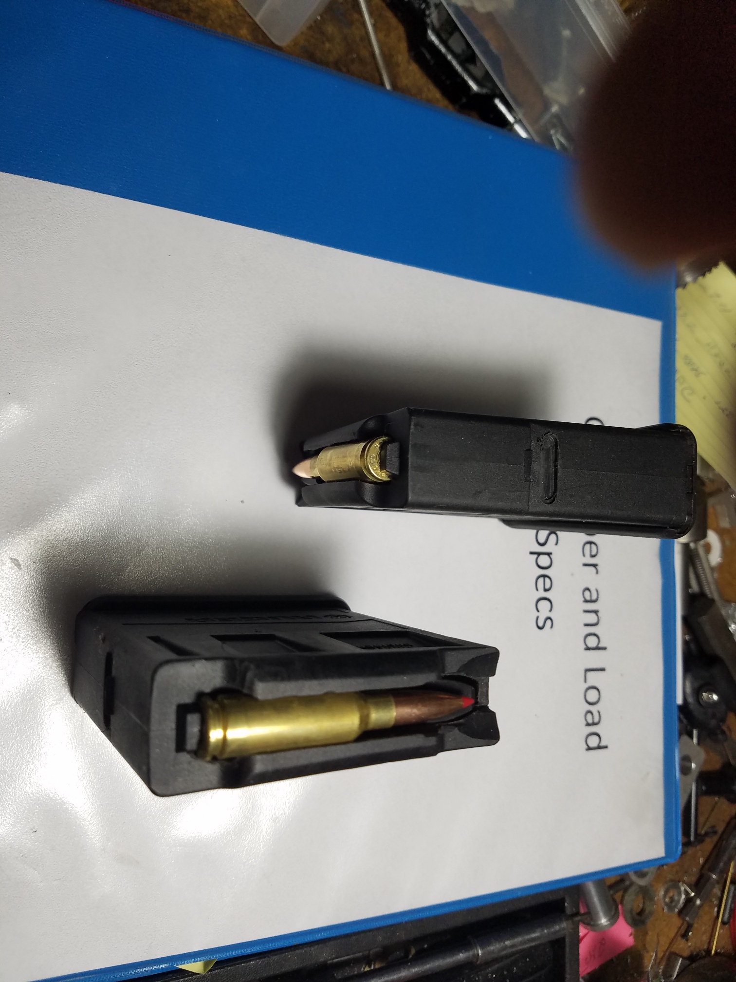

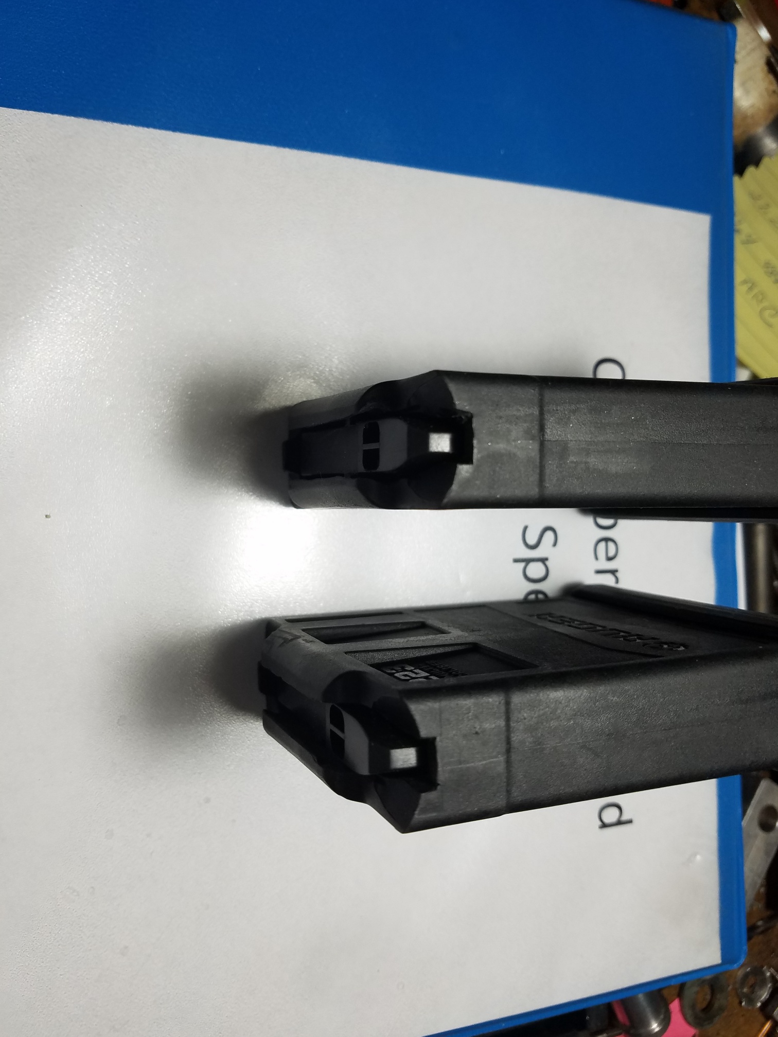

    I just got my ruger (accurate) mag in. Trying to investigate what makes these mags work for some as opposed to the MDT mags. My first thought was that the box may be narrower internally. Turns out, throughout the taper front to back the accurate mag is .040" wider. The feed lips are 1.30" +/- long and the MDT are 1.20" +/-
    I'm hopeful but if it doesnt work I've got a back up mag for $45. I'll keep everyone posted when I get further along.
    The other problem I have found is long freebore 88/90/95gr rounds run great in my MDT 6BR modified mag but short factory rounds like the 224V 75gr wont run, too damn short.
    Which, just guessing here, means feed lip length matters based on SAAMI ammo or long seated reloads. Interesting. Sounds like a interchangeable spacer for different length rounds might be needed. Or at least some way to seat the round forward or back in the mag.
