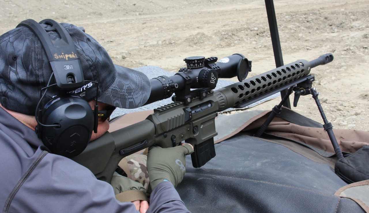

My Valkyrie is a JP Rifles, not a Seekins
