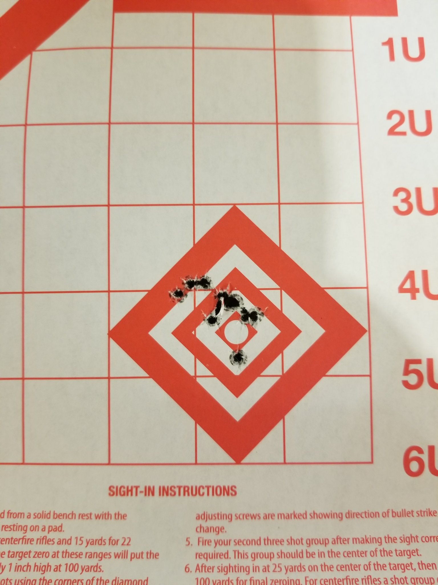

I have a Tikka T1X in .22LR in a KRG Bravo stock and a Quietbore Ti form 1 can on the end. I put the whole thing together about a month ago but didn't do much more than plink a few times in the backyard before today. I went to the range this afternoon and setup on the 50 yard berm. My first few shots were ~6 inches high and ~6 inches to the right. After getting it somewhat adjusted, I noticed that my groups looked like this. That's about 7 moa. I was not impressed.

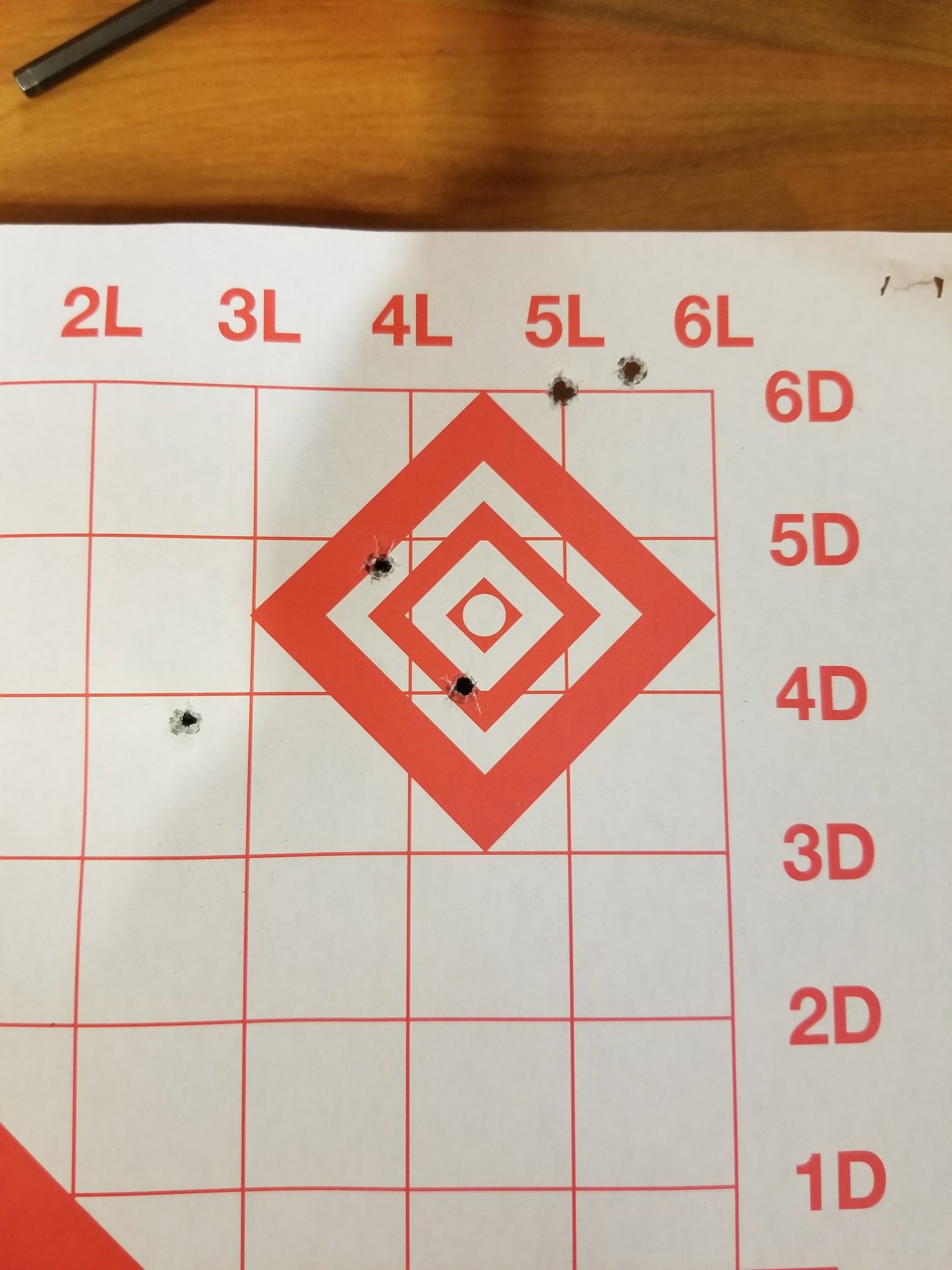

I took the can off, rezeroed (6 inches down and 6 inches to the left) and was able to do this, ~2 moa.
All shots are with CCI Standard Velocity, so not match, but not crap.
I put the can back on, confirmed that my groups went to hell again, and packed my bags and came home. I haven't taken the suppressor apart yet because I thought I would ask the brain trust here what to look for and I didn't want to destroy any evidence. I'm theorizing that my issues could be the following:
1) Threads on the barrel are not concentric with the bore (I don't want to believe this). I have no idea how to check whether this is the case.
2) Threads on the rear of the suppressor are not concentric. I also have no idea how to check this.
3) I'm getting a baffle strike due to my crappy basement drilling efforts. Should I look for clean spots on the baffles? Would a .22LR leave an impact witness mark on Ti? What should I be looking for?
I'm not an expert, but the holes in the first picture above all appear to be just as "round" as the holes in the 2nd target when I wasn't using the can.
Help, I'm all ears.

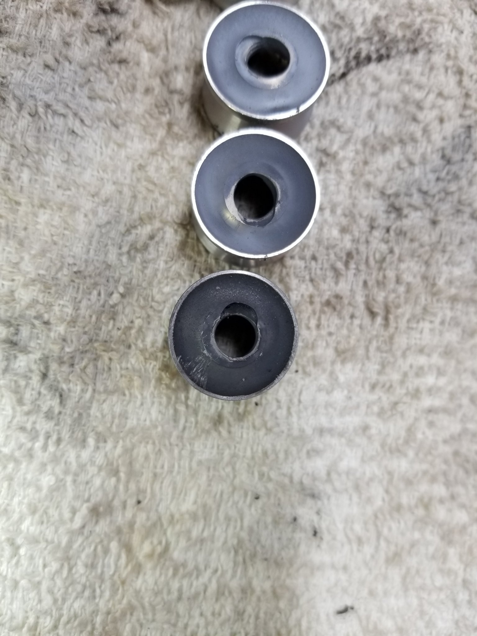

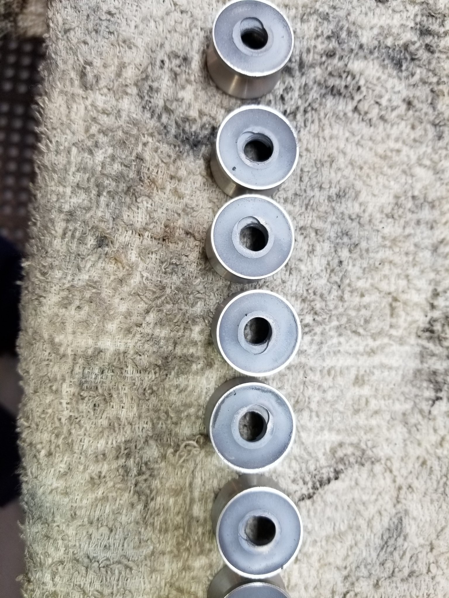

Here are the baffles, in order, bottom to top, from chamber to downrange.
I could not see any obvious lead debris, but my shoddy work is on full display. Ues, I did use the supplied drill jig, but I also broke 4 carbide bits getting the job done.
Should I get a drill press and redrill this set instead of using a vise and hand drill? Scrap these internals and get a new set? Can I reem out what I've got?

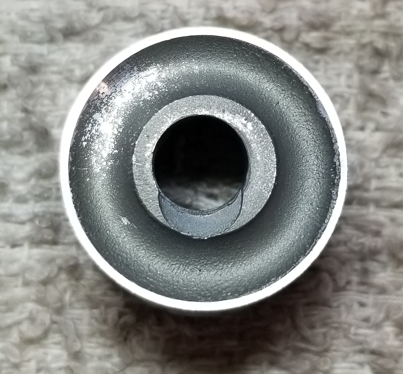

I think I found the problem....
When I was drilling my cups using the jig, my bits were getting dull and breaking. My vise was not full tightened down and was wobbling a bit. As they got dull, they were not able to get enough purchase to start a hole without wandering, and this is a result - an off-center hole.
Looks like it's time to invest in some new cups and try this again.
How did your drill bit "walk" in a self centering alignment bushing to prevent this very issue? Regardless if the jig was loose in your vice, the drill but cant go anywhere other than straight down because of the self centering bushing....

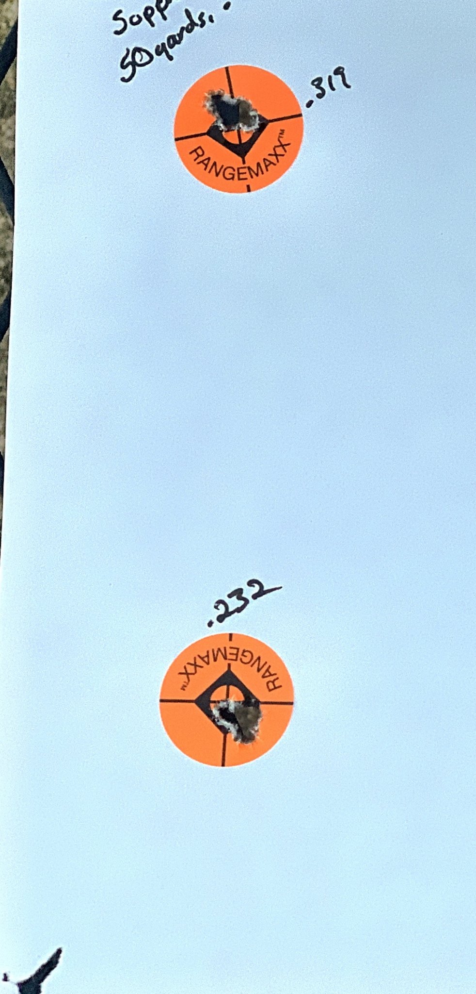

It has to be what you have found in concerns to the non concentric holes. My quietbore suppressor and tikka T1X shoot decent and I am confident in the quietbore product.
Below is my first outing with the combo trying different ammo. All are 10 shot groups at 50 yards. Look at the two bottom middle groups. Same ammo but with the suppressor and without the suppressor and the big difference is the point of impact shift. Only that one group was without the suppressor and all other groups were shot with the suppressor.
