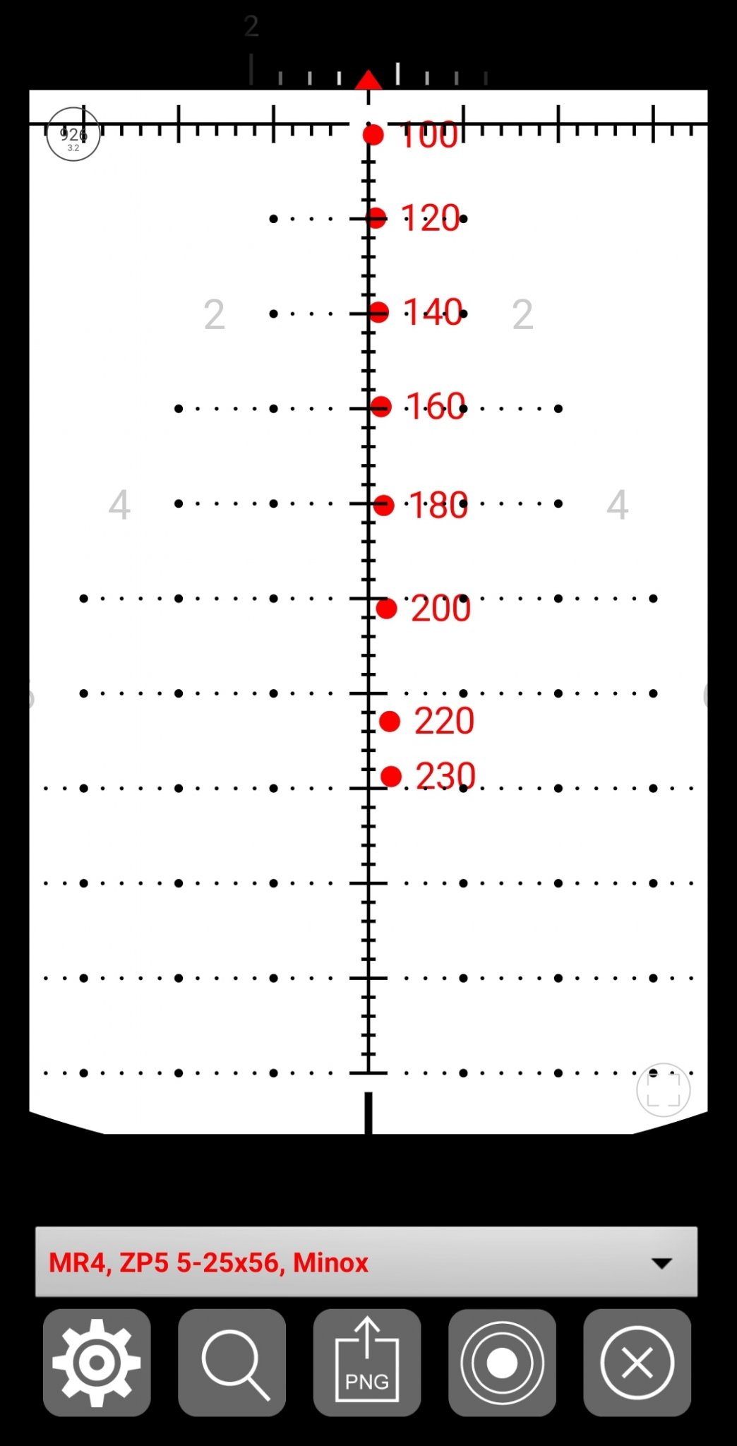

I have a thing for quick intuitive ways to manage data. The Speed drop factor is one of these that along with your wind number can be very fast and effective. But what about 22lr?
If we look at CF it works out nicely with each additional 100 yards adding 1 mil of drop but we all know 22lr is.... well slightly more. If we scale 22lr and CF trajectories its ×4-6 depending on CF cartridge used. E.g. 100 yards with my 22lr is the equivalent of 600 with one of my 6mm.
Our Speed drop factor formula is YARDS/100-DROP= FACTOR. Well if a 22lr is approximately ×5 then 20 yards would be the equivalent of 100 CF yards. Lets try YARDS/20-DROP= FACTOR like this!
Hey it kinda works! But does it pan out in real life? The math is not quite as intuitive but still very simple. Your dialing 1 mil for every 20 yards. In this example I will use 3.4 as my factor by slipping my turret to 3.4 mil and now dialing down to zero again. Now I dial my YARDS/20. E.g 160yd = 8 mil or 188yds = 9.4 because our minds find dividing by 2 easy just take the first 2 digits / 2 and then add a 0.1 for every 2 yards in our last digit.
Because 22lr all have very simular drop there is a simple shortcut to identify your Speed Drop Factor. Take 160yds/20-Drop-0.1. In our example
160/20= 8- 4.5mil= 3.5-0.1=3.4
This is a environmentally effected number so be sure to calculate it with your current conditions.

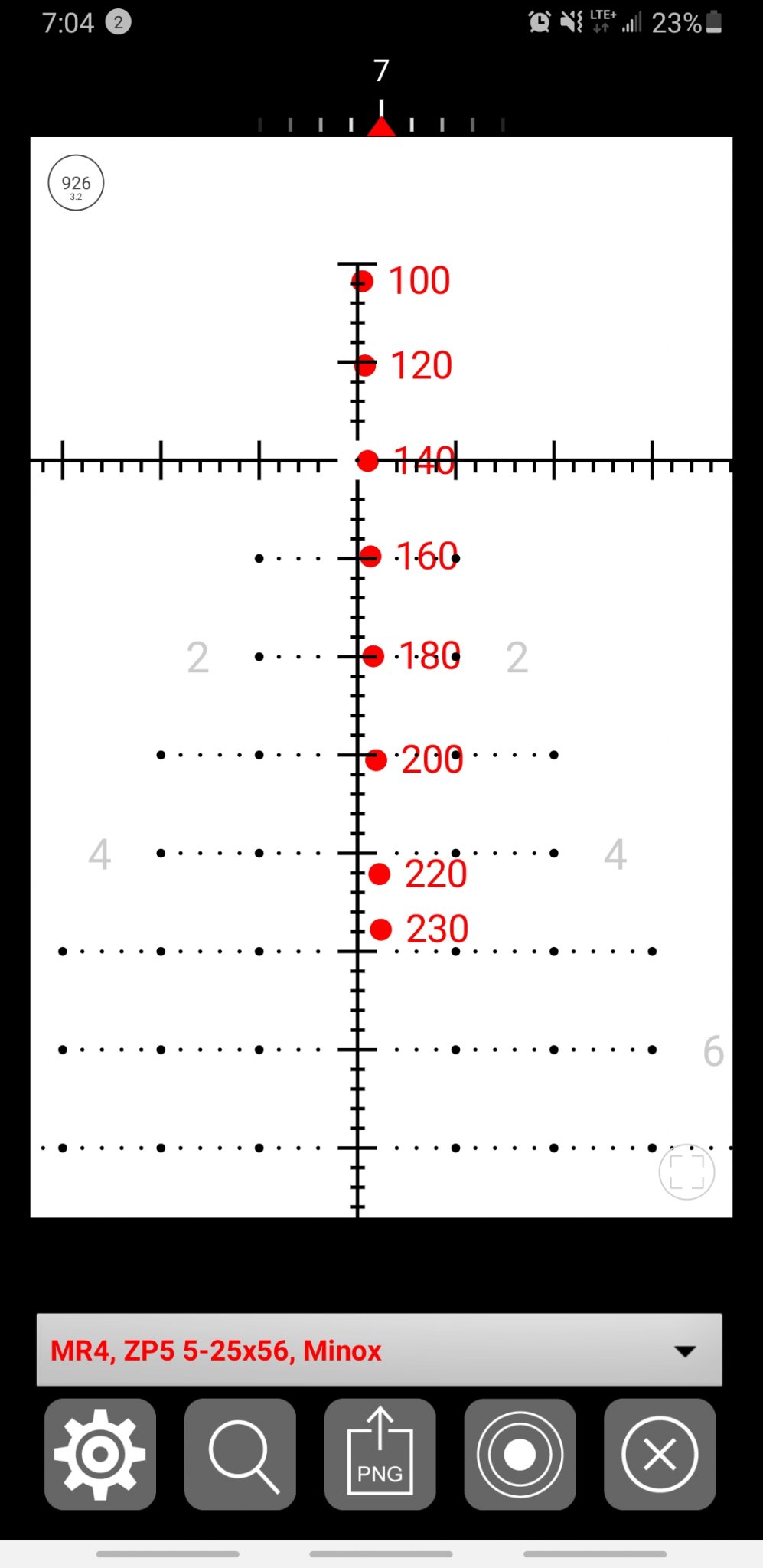

Now this begs the question if the Speed Drop Factor works what about a BDC? Absolutely it does. It runs along the same lines but here is the quick answer. Take 5- your speed drop factor. In our example 5-3.4=1.6 Dial up from your actual true zero (does NOT have to be 50) 1.6 mil or if you have slipped your turret to your speed drop factor already just dial up to 5 at first glance this appears to coincide with your 100 yard drop but this is not the case and will not work. Anyhow this is how it would look at two different temp with our example ammo.
20⁰c
30⁰c

It definitely does change over a day. You have to change your SDF through out the day. But the same thing applies. My SDF changes 0.3 mil max with the Eley I run. So very simple to account for.
Memorizing drop is a way that can work too but you still have the effects of environmentals to remember to add or subtract.
There is another method you can use that works well by adding or subtracting yardage based on a significant of environment change. You then run a BDC turret wrap. Both methods work better then memory on the clock.
All methods work better in CF just because of the apparent forgiveness of trajectory. Memorizing every 100 yards of my 6mm to have the same resolution with my 22lr requires memorizing in 15 yd increments.
In either case its gear towards larger targets of a hunter style match where you need to range. not PRS with targets in the low 10ths.
Wind can also be done very simply mentally with a 22 as well I'd say easier then CF but RF is my main matchs. The biggest thing is if a person know what all the effects can be.
