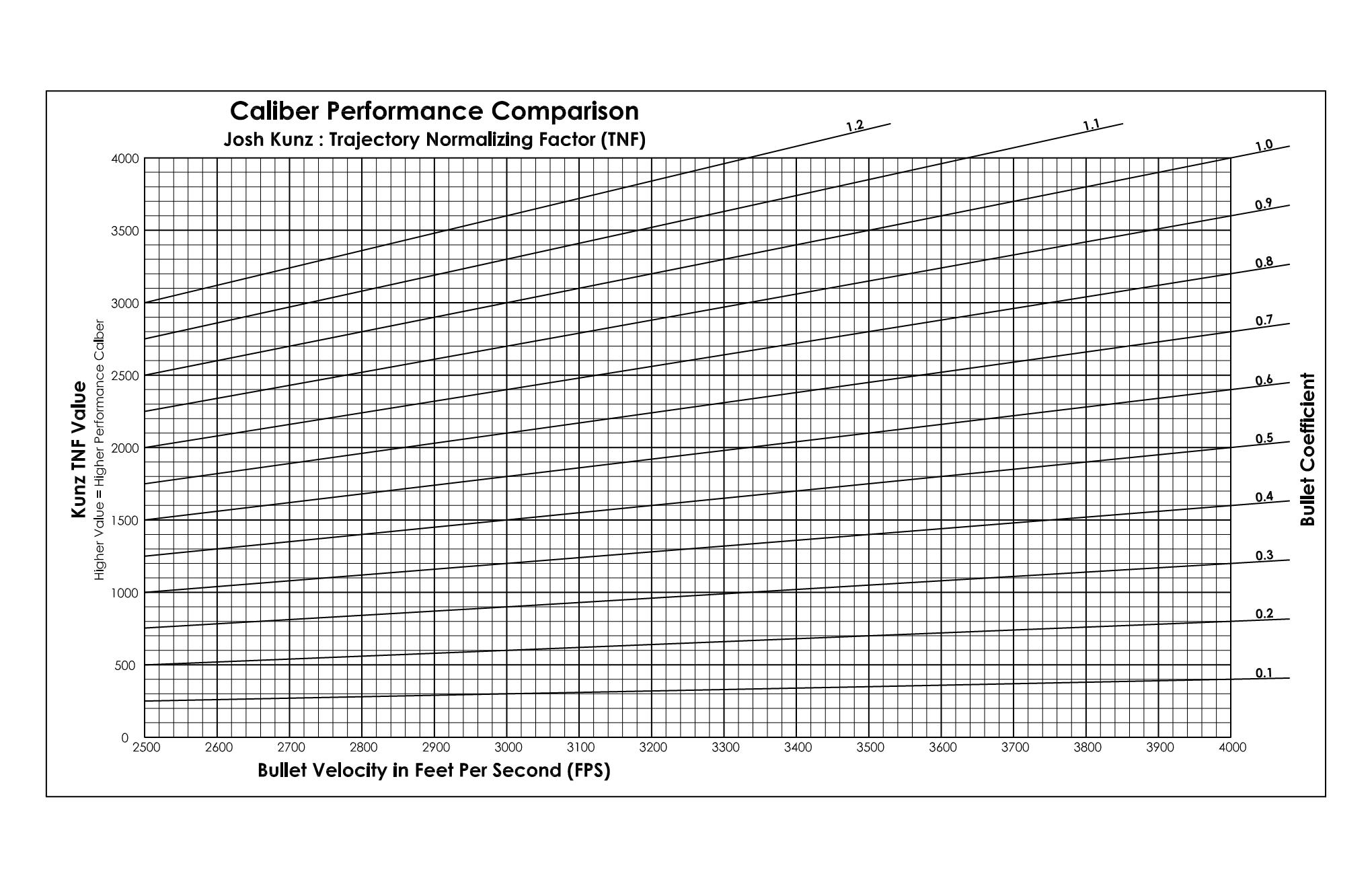

I know this a simple multiplication process, but, I wanted to use the method to compare several calibers and bullet and combinations a once. So, I create the below table to plot the location of the Trajectory Normalizing Factor. I have found this useful when having conversations with others about calibers and bullet selection.
Step 1 - Find bullet speed on bottom of page.
Step 2 - Move up page to your BC value.
Step 3 - See Trajectory Normalizing factor at the left.
Step 4 - Higher on the chart is better WIND performance
Kunz Caliber Factor Model (1) 8x11.jpg Kunz Caliber Factor Model (1) 11x17.jpg

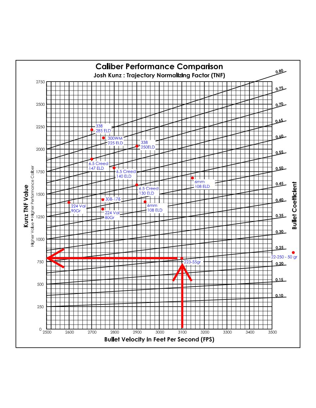

I am not sure these velocities are correct but here is an example of how I use this.
View attachment 7265917 View attachment 7265919

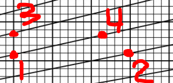

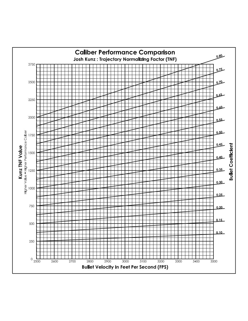

Here is a short part of the chart
Start at mark 1.
Mark 2 is 0.1BC less but you have to have 300fps faster bullet to match mark 1
Mark 3 is 0.1BC more and you have the same velocity. Mark 3 has better wind performance.
Mark 4 if the same BC but is 225 feet faster. Mark 4 has the same wind performance as mark 3.
Reading this chart is all about what you are wanting to change. change bullet for BC? or change speed?

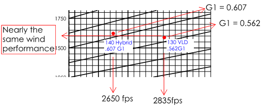

This is where Frank is coming from. His example from the "The Everyday Sniper Episode 249: Heavy Bullet vs Light Practical Application"
140s at 2650 compared to 130s at 2835 (this charts shows Bergers rather than Hornady bullets)
We also have to remember this is a shortcut way to evaluate the wind performance of a bullet. This chart will give you the jist... but not the whole story.

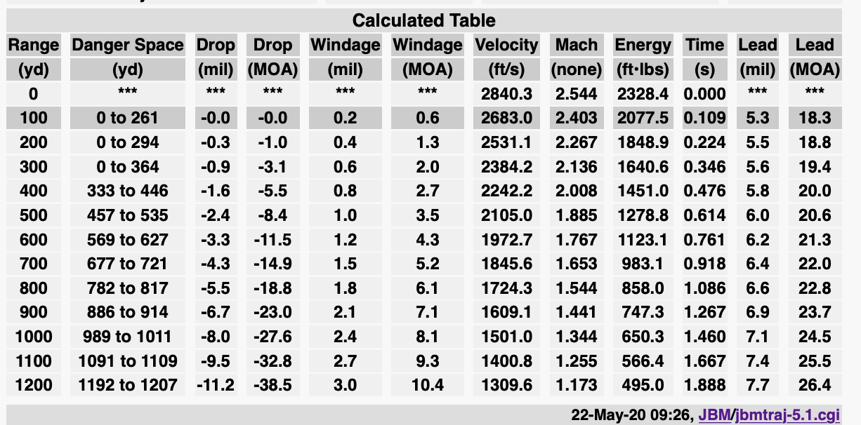

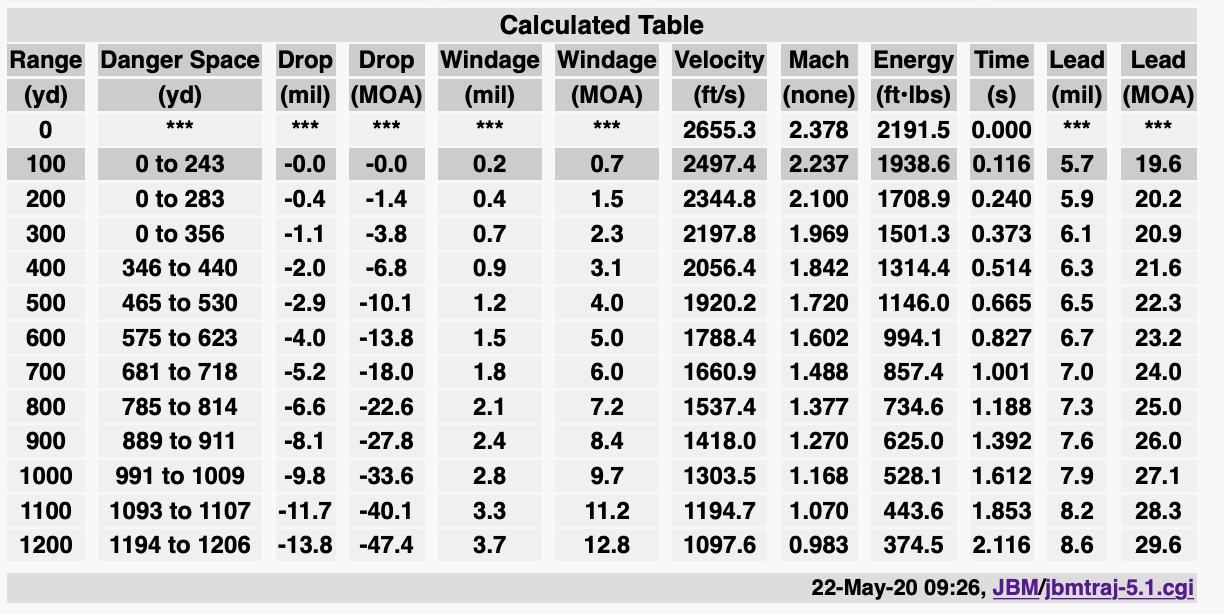

this demonstrates it perfectly,
140gr 2650fps
130gr 2835fps
Less drift, pretty close to what I noted in the podcast, and less drop, with a shorter time of flight.
I am 200fps faster at the intended target range, 1500fps vs 1300fps, the 140 is getting ready to cross into transonic. Another 100 yards or more and the 140s will start to fall apart.

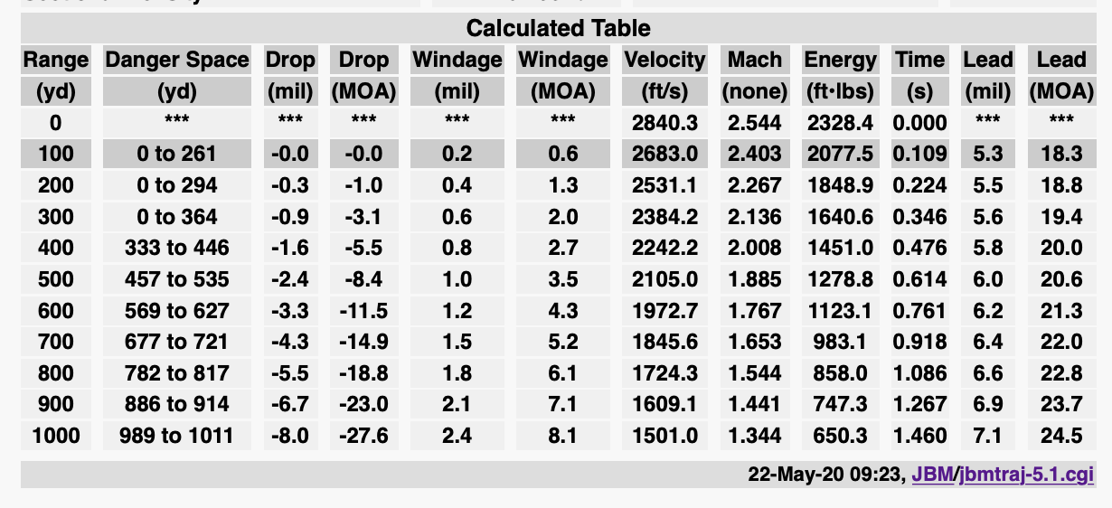

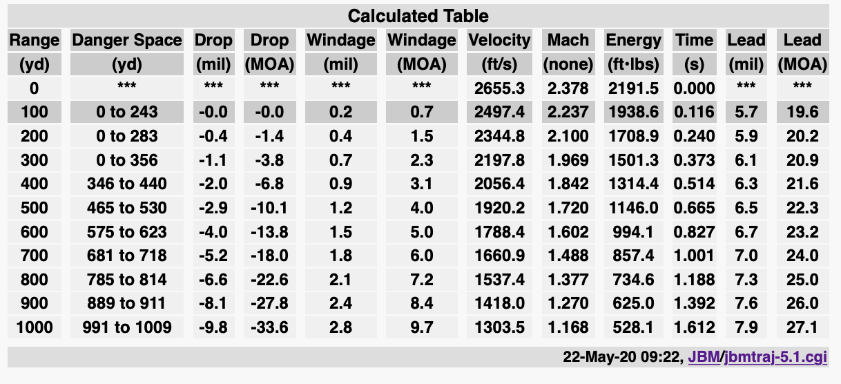

Here,
130gr 2835
The 140 is subsonic now at 1200.
