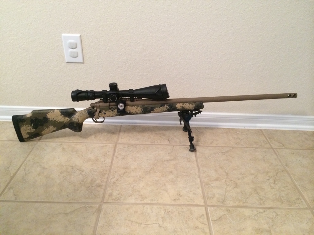

You mean like this?? [emoji4]
700 trued and built by GAP
Manners MCS-T with BDL mini chassis
24" Krieger 1/8 twist.
Thruster brake
