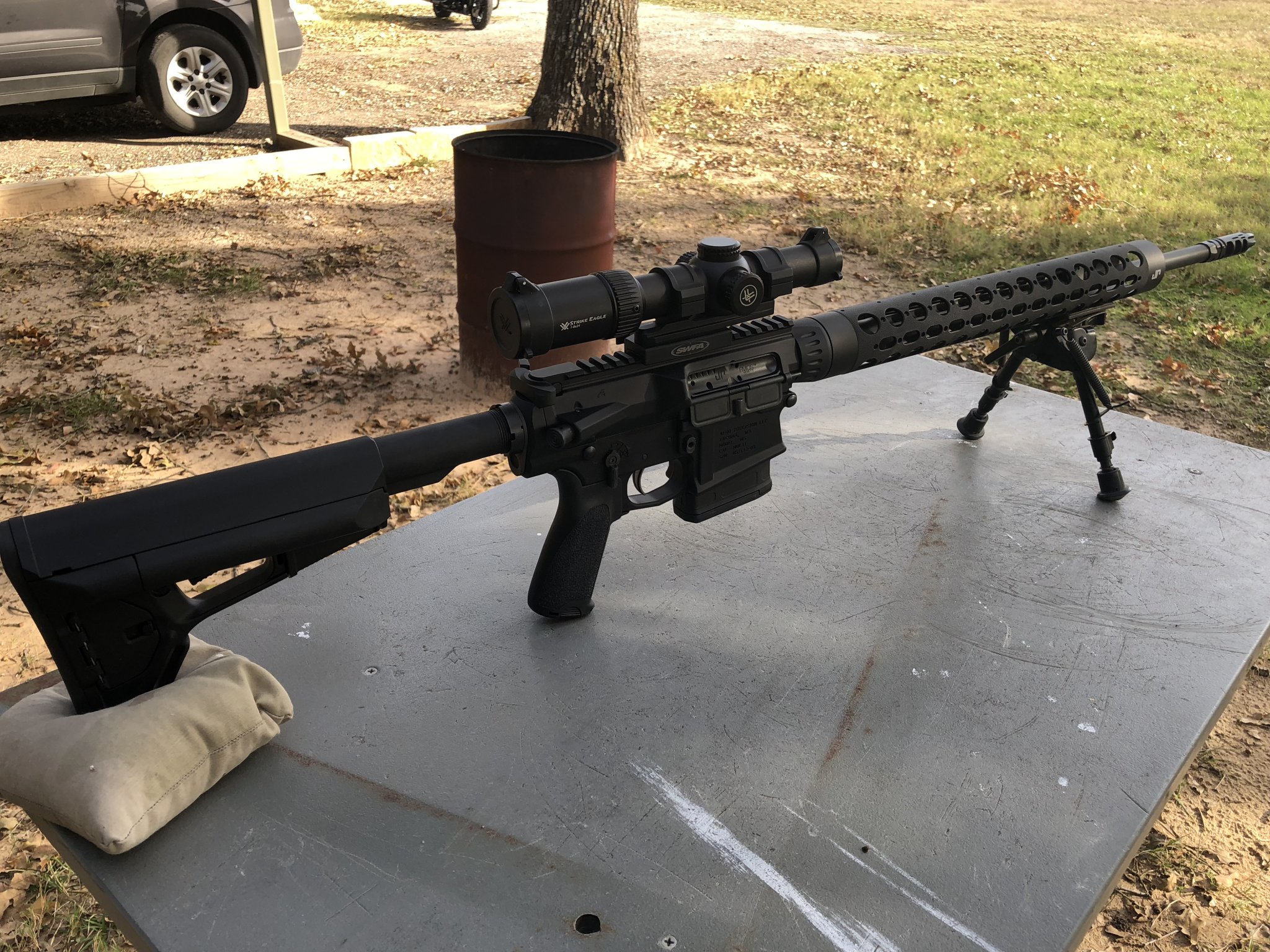

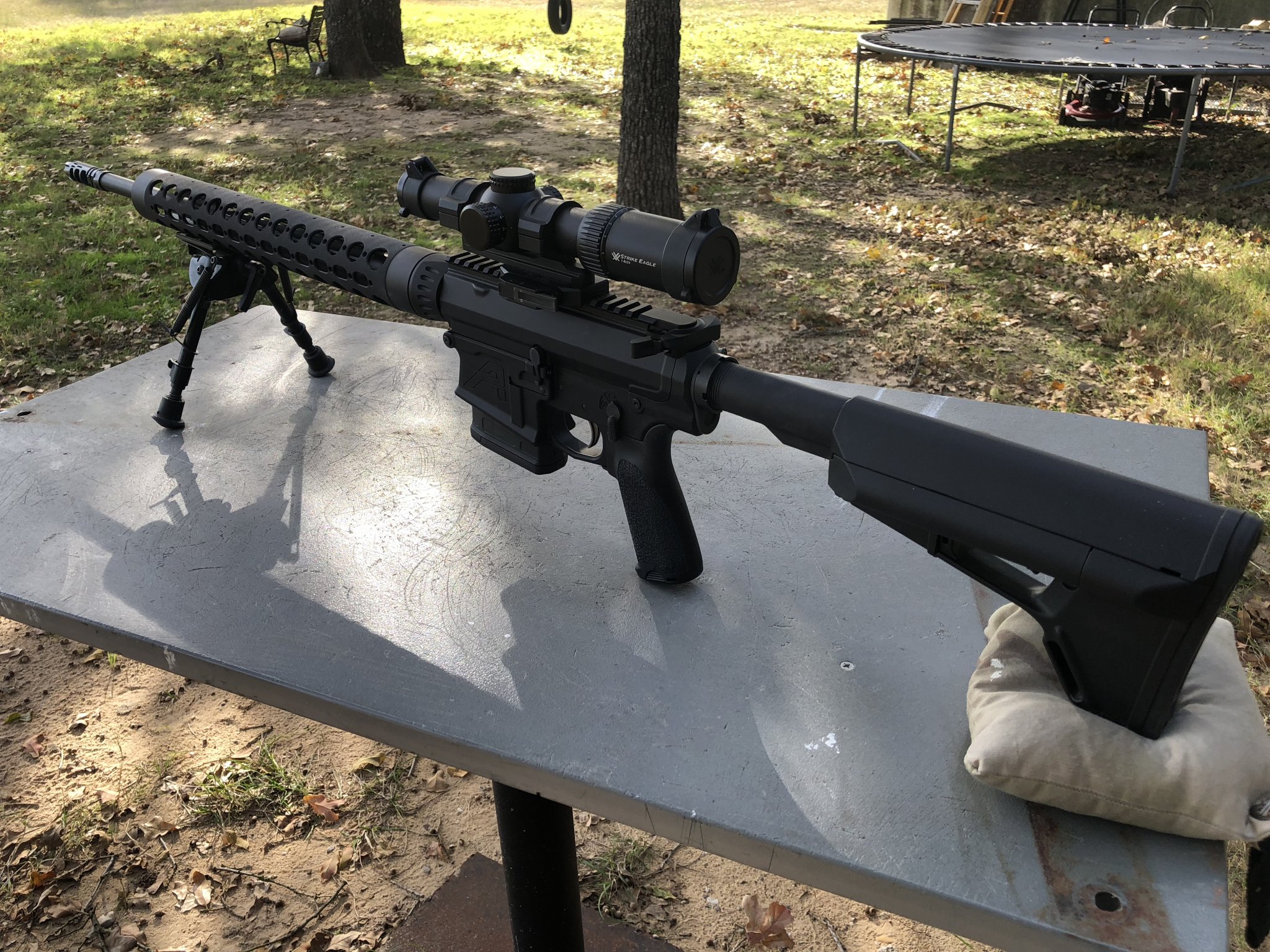

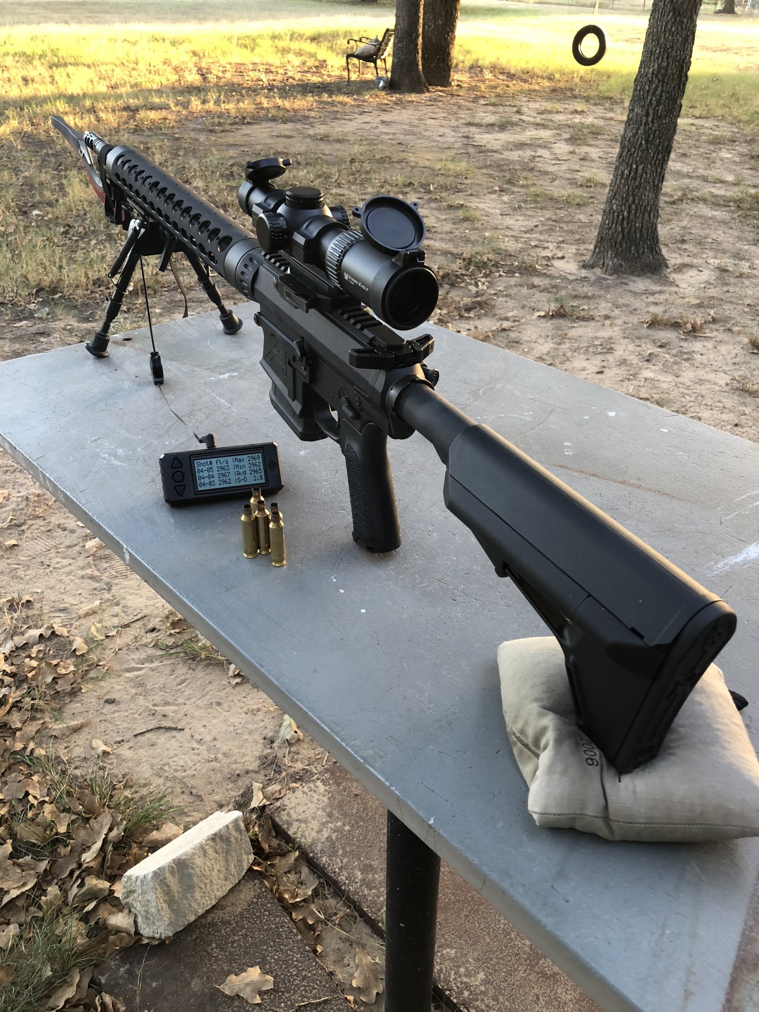

I hate to contradict the experts around here but I just finished building this 243 two weekends ago. I do not shoot factory ammo but have loaded 87 VMAX, 90 Scenars, 105 BTHP. I ran across a deal I couldn’t refuse on a Seekins Precision fluted barrel and this is the result. I’d say 243 Winchester is a coyotes worst nightmare, especially with light, fast varmint type loads.

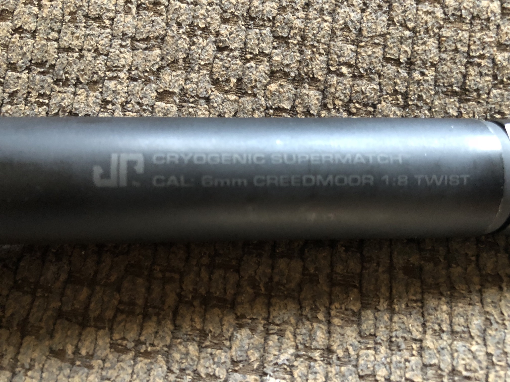

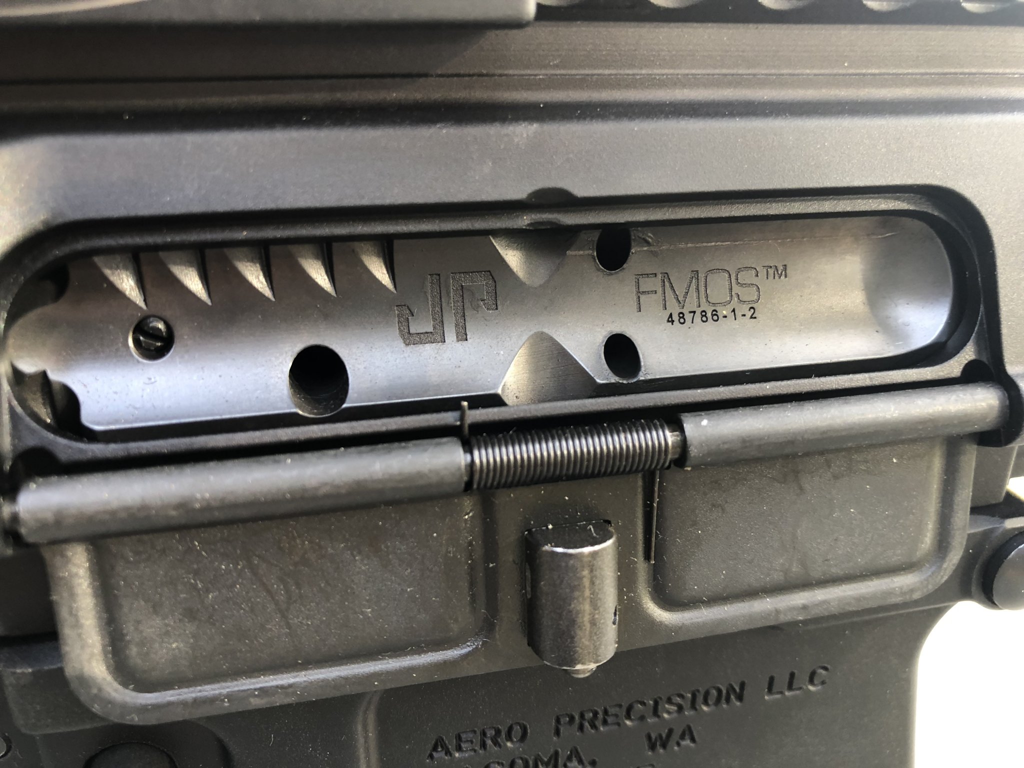

However, I also have two 6 Creedmoor uppers. This one a 22” JP barrel and matches velocity with exactly one less grain of H4350 than the 243. The other one is a 20” Bartlein from Craddock.
