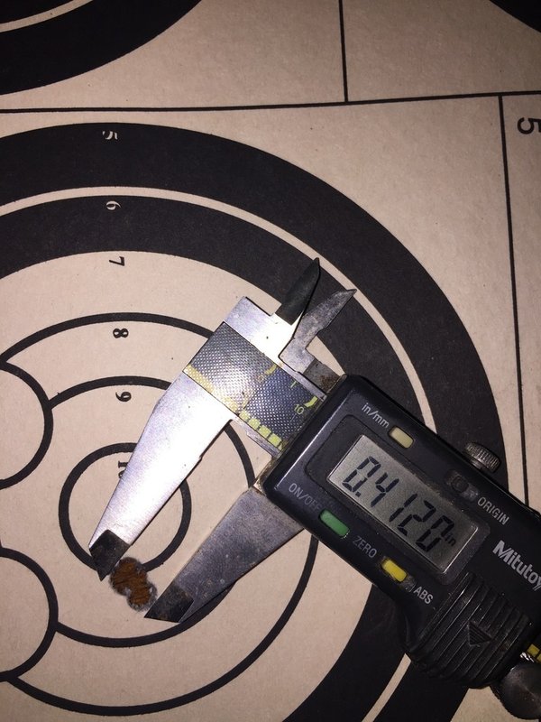

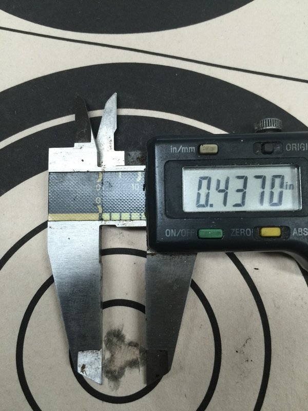

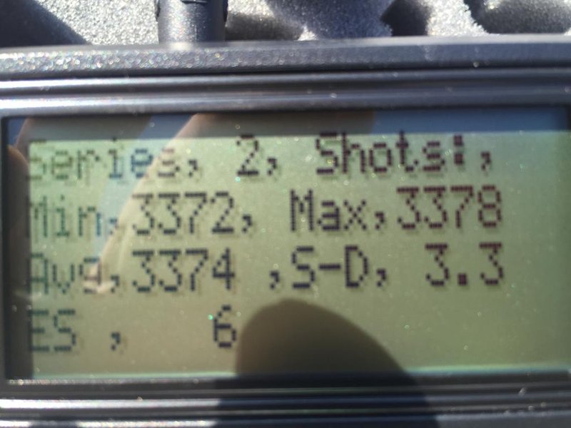

As a add to my previous. I was pushing 105s at 3400fps out of a 30" 8.5tw with RL26 but it was pressure with a heavy bolt lift. Found a real nice node at 3374fps but it was a hot load. I backed down to 3185fps as that was the best node with 44.7g of RL26. Single digit SD and ES. That barrel lasted 1300 rounds. I'm now shooting that same load 44.7g of RL26 with 105s at 3200fps on the new barrel with great results. Test target below. 5 shot group at 100y. I also tried DTACs with RL26. I got them to 3152 with excellent results as well(Info attached) but settled back to the 105s as I had 1000 more of those and I only shoot it to 600yds. Another side note. I tried RL25 with DTACs and found it to hold tighter groups with RL26 and the RL25 had higher SDs/ESs. Hope some of this helps.
L
105s
Series2Shots:5
Min3387Max3415
Avg3400S-D11
ES28
SeriesShotSpeed
213399ft/sec
223415ft/sec
233394ft/sec
243387ft/sec
253408ft/sec
