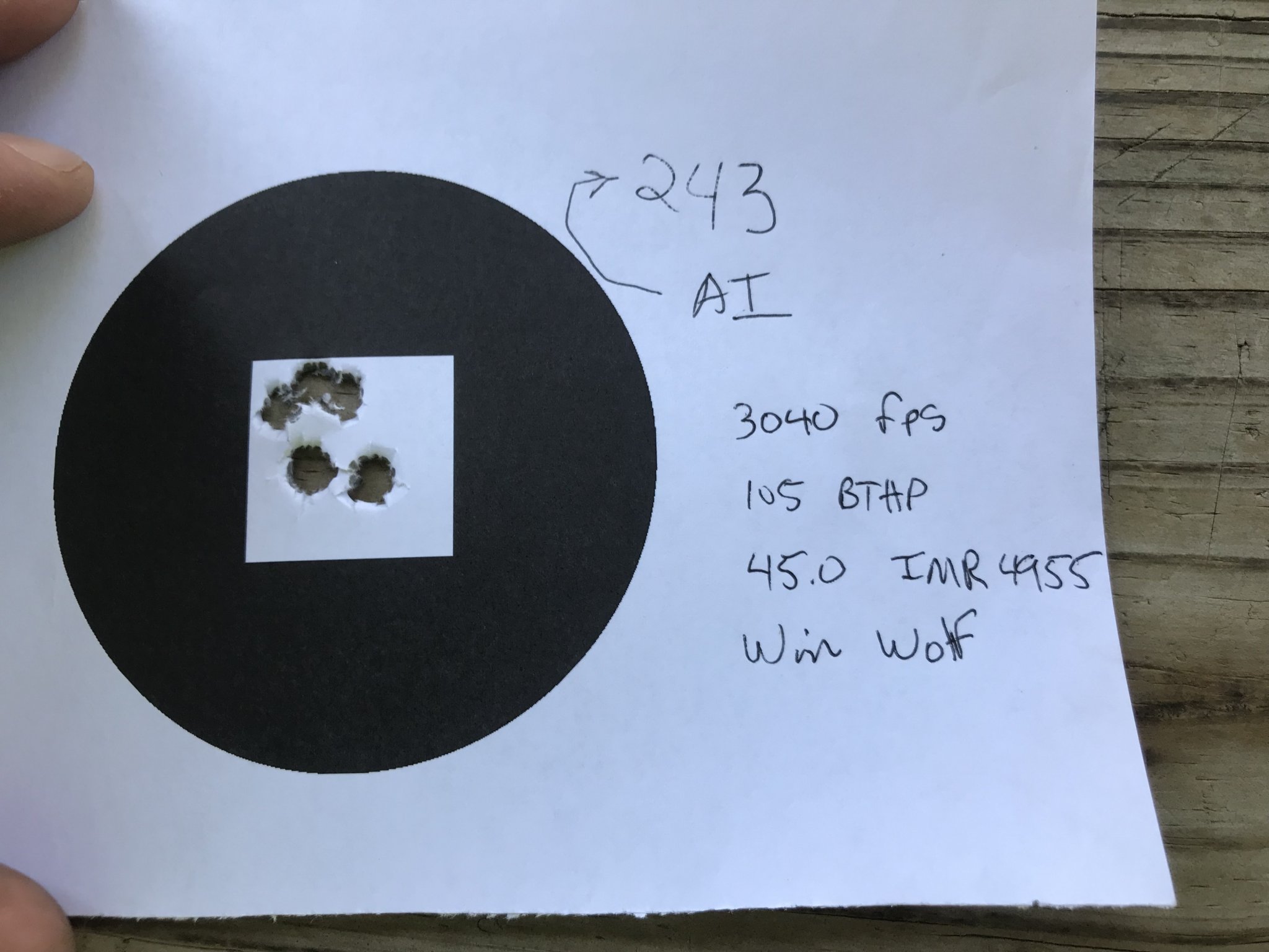

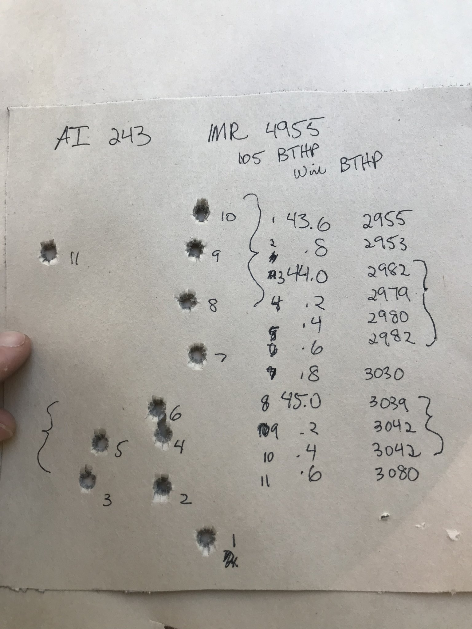

I did some testing and load development today.
This combination is going to work well.
105 BTHP
45.2 IMR 4955
Winchester brass
Wolf LR
3,040 FPS
The ladder test was done at 316 yards.
