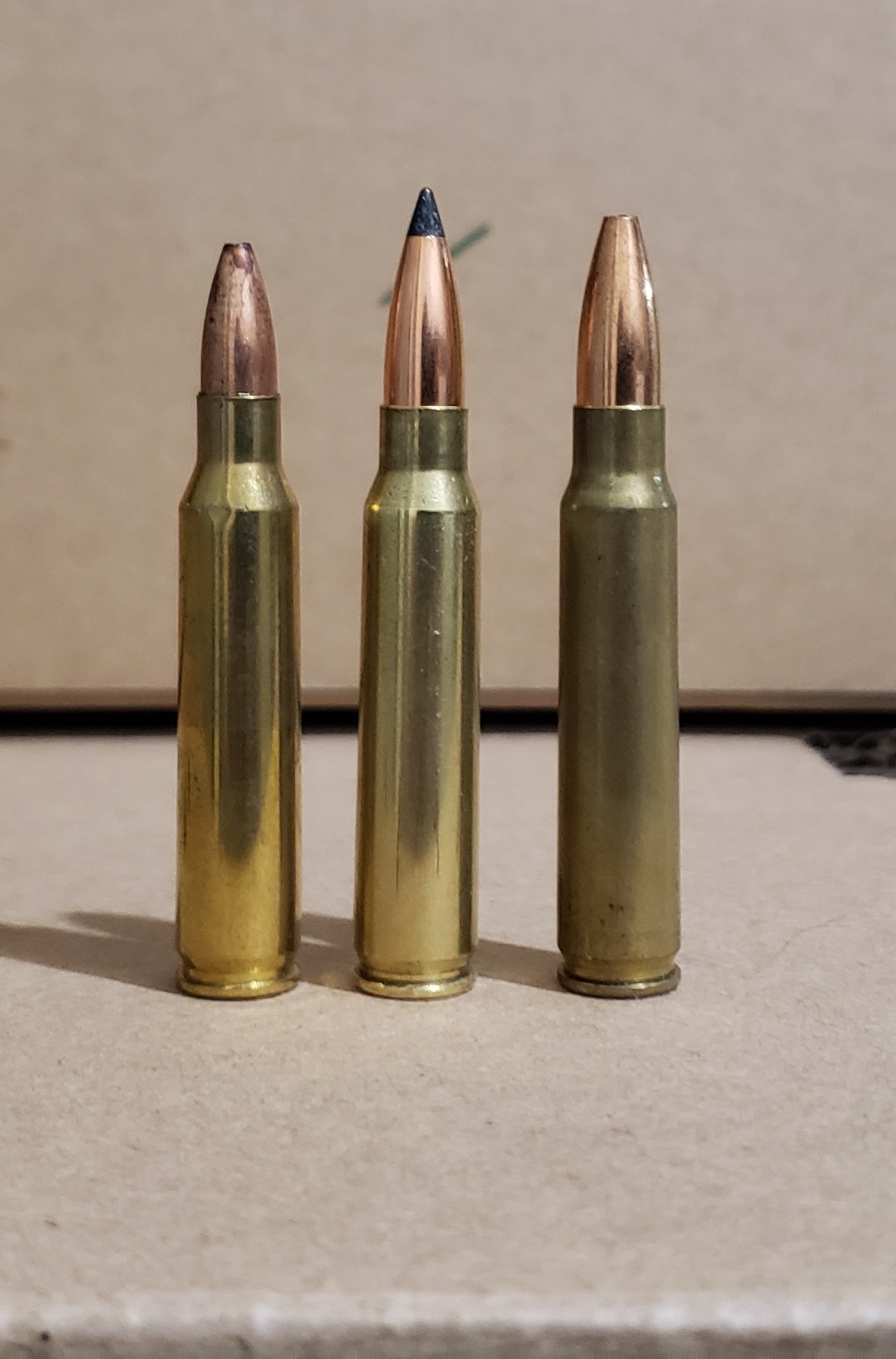

Theres also 6x45 which is the middle ground of 223 and 25-45. Better BC than 25-45. Heavier weight than 223.
I do not recommend all 3 because sorting brass is an absolute whore when the head stamp is the same. Seriously, only idiots have all three. I made the mistake of mixing all 3 in the tumbler once. Should have just thrown it all away. What a pain.
223---6x45---25-45
The 6x45 is for a bolt gun so the OAL is longer. The 25x45 is at mag length.
