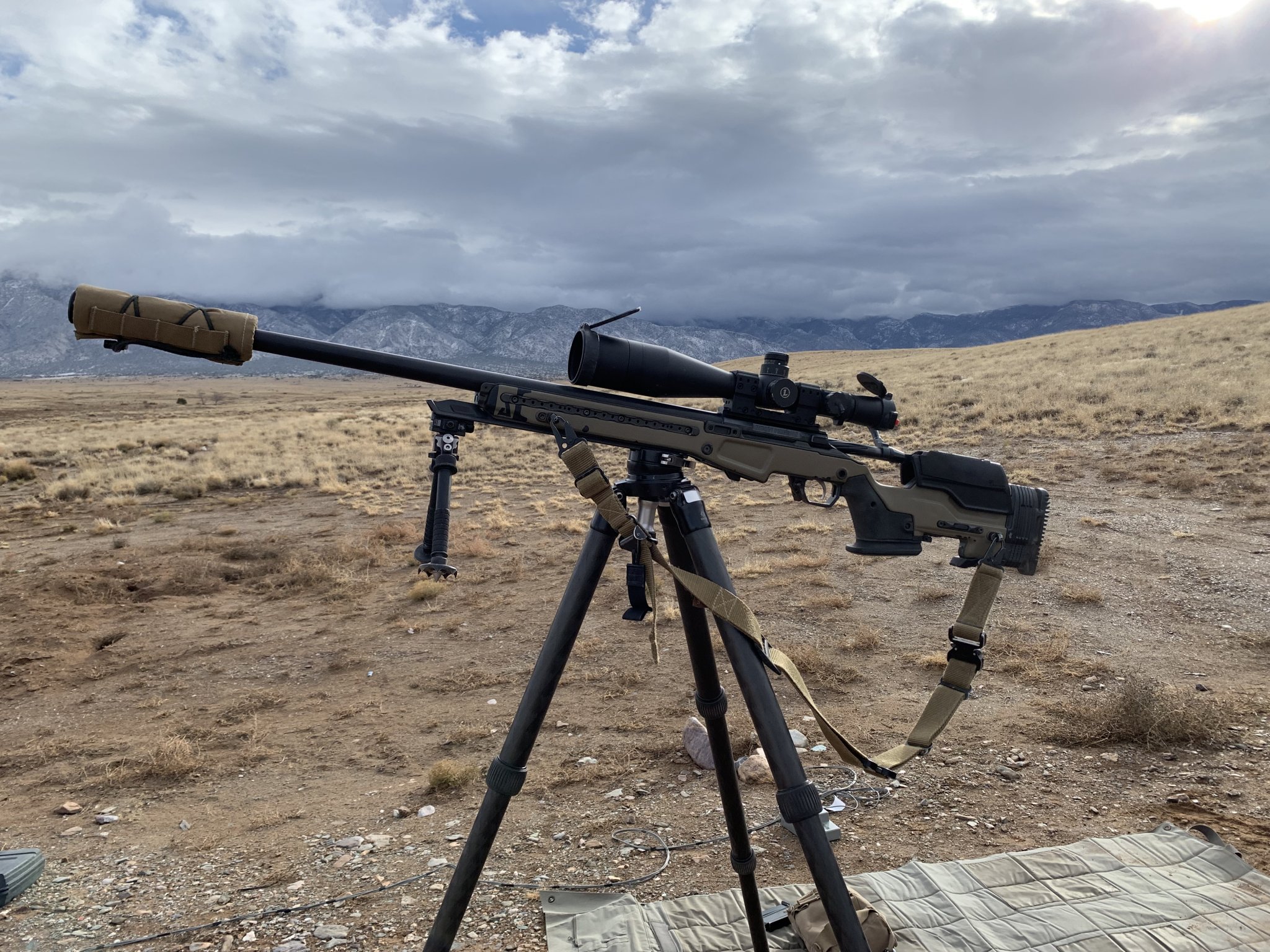

Barrel length is 25" hung on an Impact action in a JAE chassis......been my go to rig for a couple years.
Accuracy has been stellar thus far..... I've found the OAL length to be super consistent with none varying more than .003"

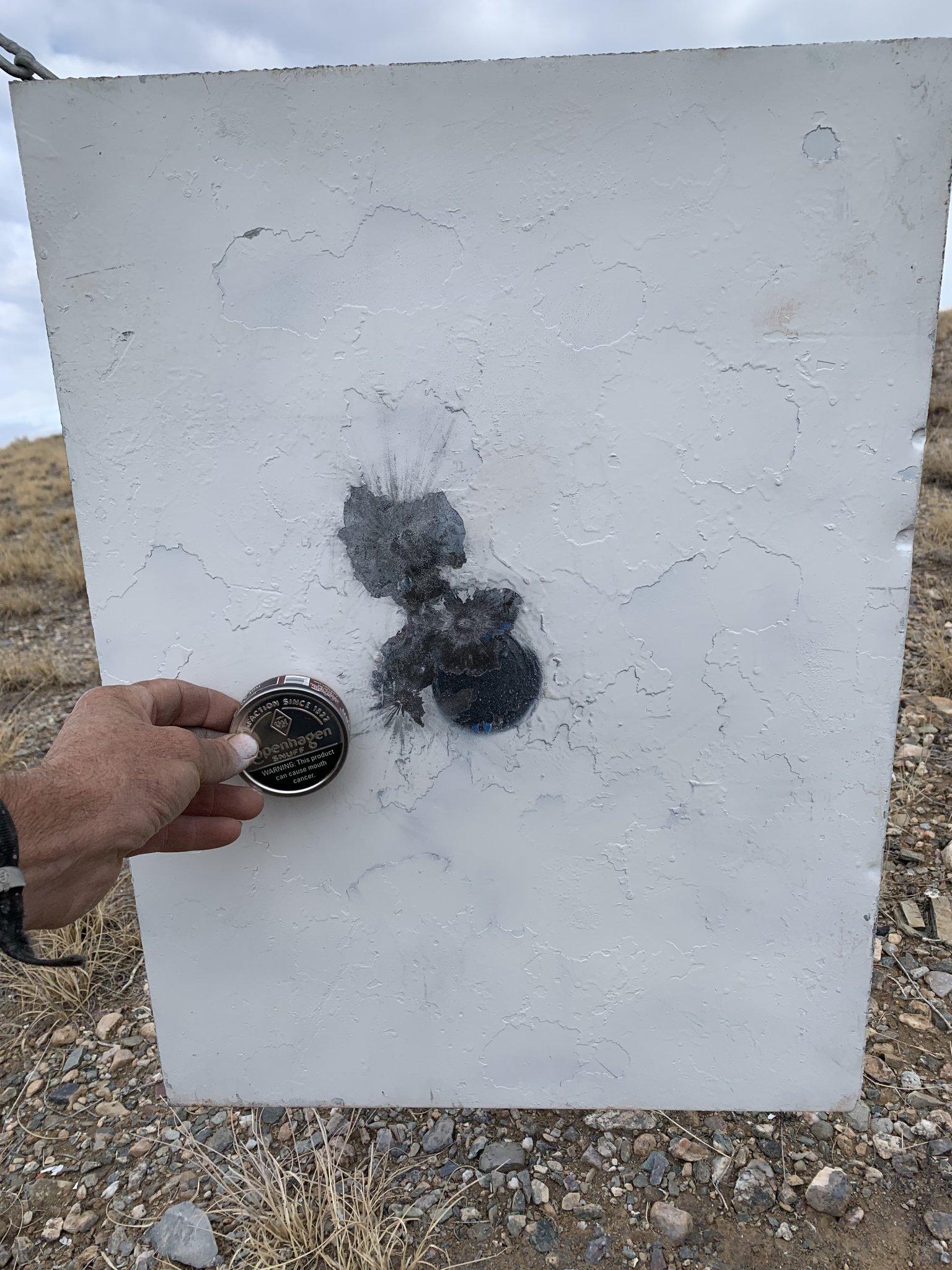

Here's a 900 yd group while I was validating ..... as for the paper, I was mainly shooting to chrinograph and not really focusing and it showed!
Going to go work it out tomorrow at distance and finish up getting her broke in...... feel free to ask any questions you may have about these 131 Blackjack bullets.../. I plan on shooting them quite a bit this next year.

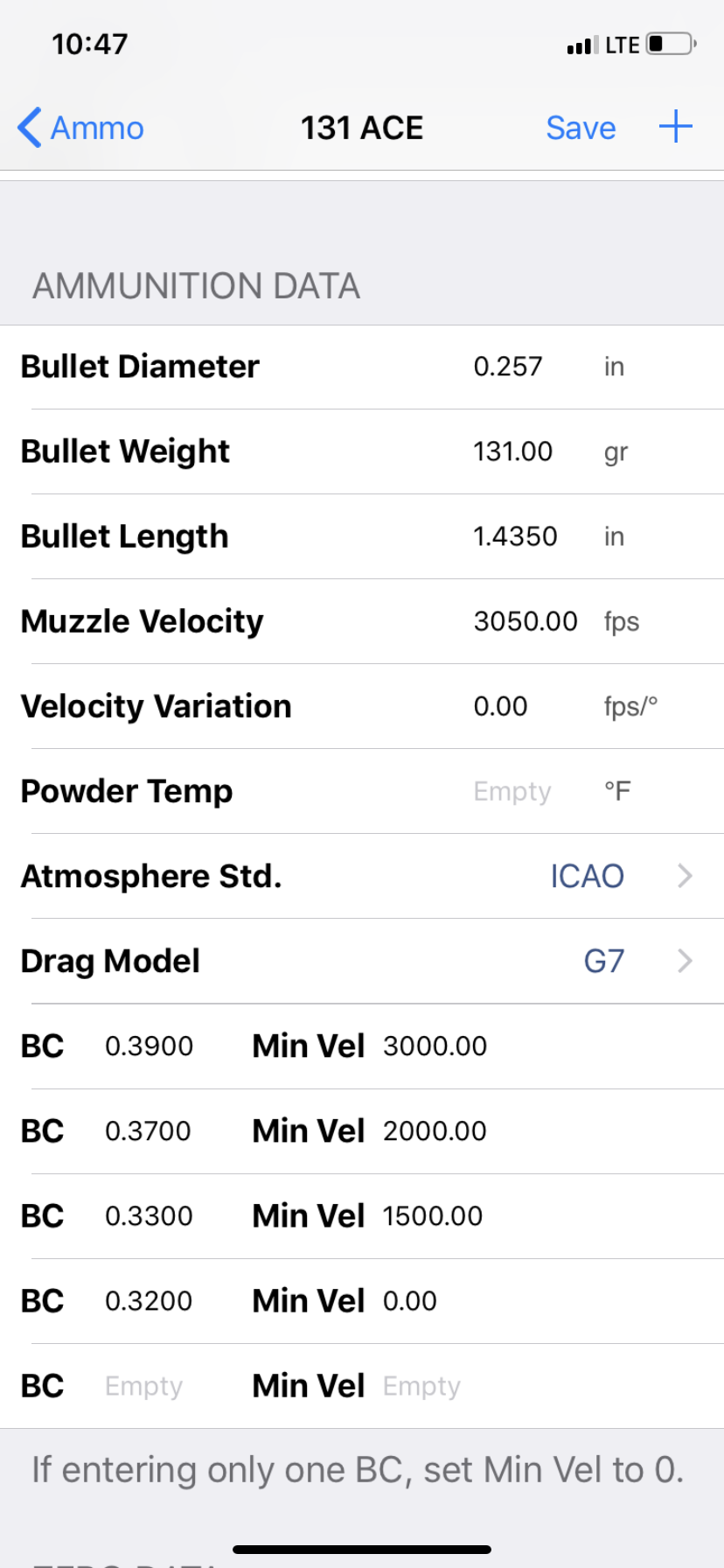

Did some more validation today, basically confirmed my previous thoughts...... would up using a banded BC is my shooter app on iPhone to line everything up nicely all the way to 1925 @ 18.3Mil
As for The Kestrel..... .350G7 is working great

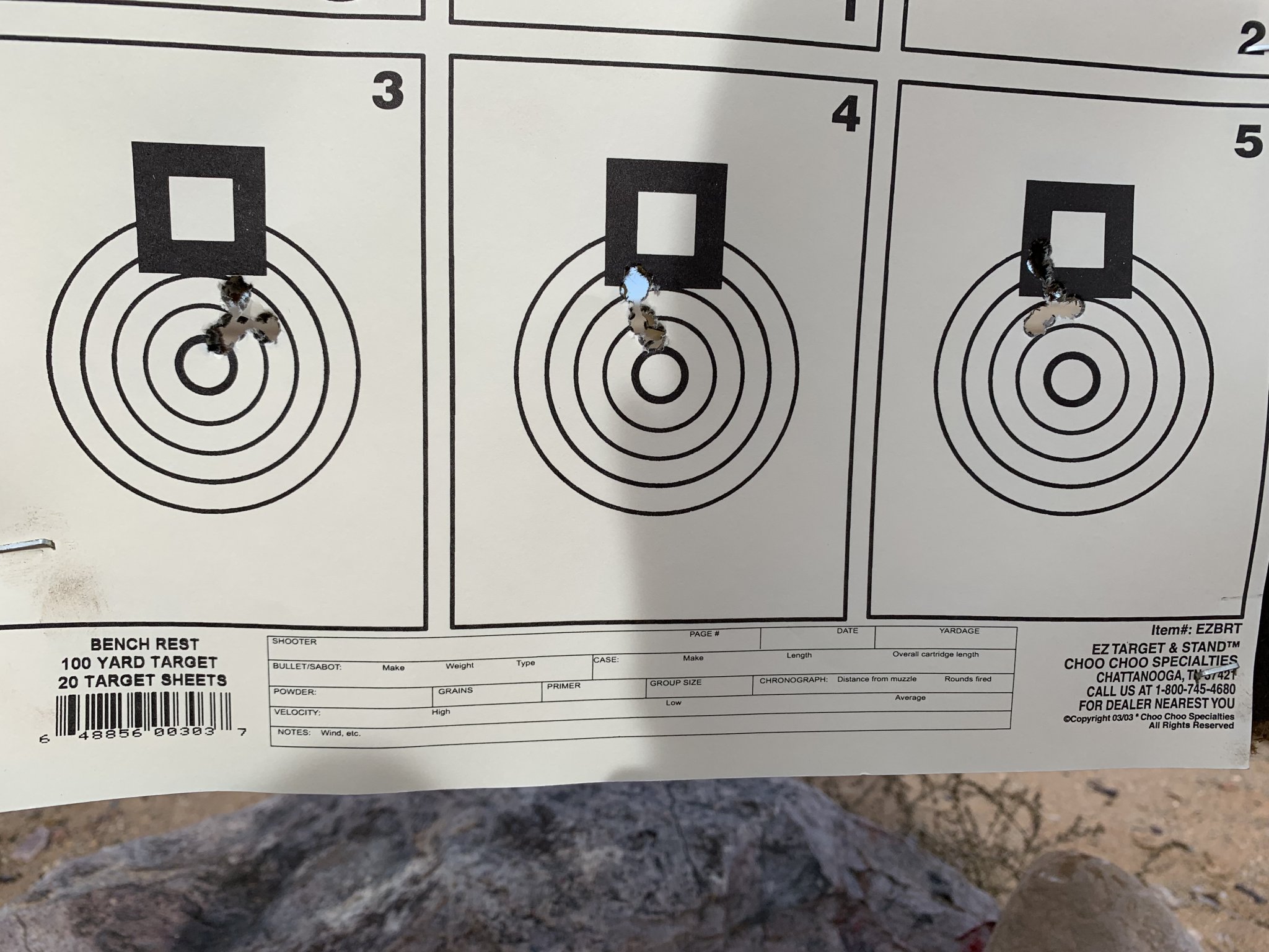

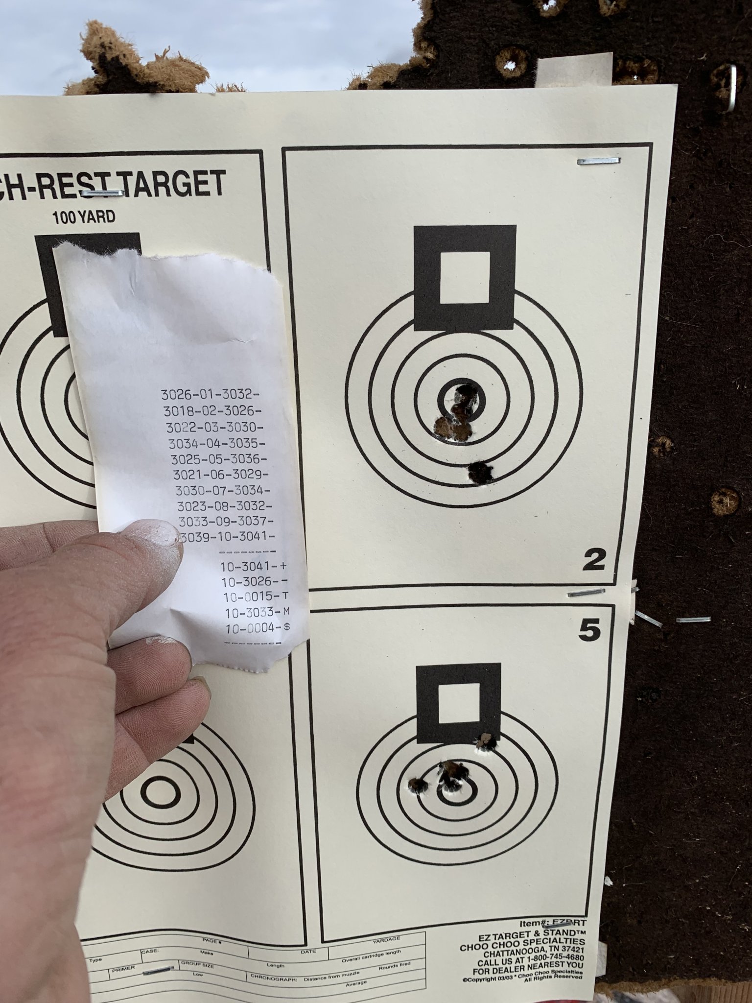

Here's three 5 shot groups @100, not perfect but they should work.

The 131 BJ ACE is a laser. I'm shooting it in plain vanilla 25-06 1:7 Remage @2925 MV no problem. That puts the G7 conservatively @ .330 at least. Impacts are impressive without saying. The more wind the more pleasure it is to shoot. Love the reaction and feel of the recoil. No brake.:coffee:
