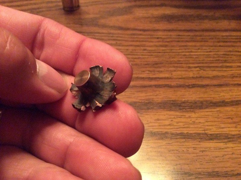

Our experience with Flat Lines, it started out with using the 256s in the 338 LM we had seen some very impressive speeds and accuracy with this combination but the 338LM got put away due to a 375 Snipetac and 375 VM2 builds and RnD.
We were very impressed with what we seen prior and our goal was to use the 361 gr. Flat line in the 375s - to gain a balance of attainable speed with a high BC bullet versus High BC and mass.
Our goal was to have a load that was
Accurate with very low ESs
User freindly on Brass
Loaded to handle the 90 to 100 degree weather without pressure issues
The 375 VM2 got parked and was a backup rifle
The 375 Snipetac was our primary focus
We ended up with a load running a easy 3028 fps with low single digits ESs able to handle the high weather temps. We were very happy with the preformance of the bullet and it is our go to bullet to this day.
At the 2017 King of 2 Mile the 361 Flat Line was the only bullet that busted up the paint on all of the qualifier targets including the 1660 yard Cold Bore after the two days of qualifying.
On the 1990 yard target we held an estimated 10 to 13" vertical on the 3 rounds fired. Very nice when dealing with the wind given to you while on a time restraint and under pressure.
Thanks Dan, Alan and Josh for a great product.
The 32" 9 twist running at a easy 3028 fps combined with a 80 MOA rail and the Vortex Razor Gen II MRAD easily gave us the capabilities to aim at the intended targets and still be able to dial down use the system and hit a 1" dot at 100 yards if asked.
We are looking foward to a even more exciting and productive year shooting in 2018 with the Warner products!
Shown above if the picture works is a Flat Line 361 gr. Recovered at a steel plate at 3040 yards while in Colorado prior to arriving at the 2017 King of 2 Mile - Still showing some good authority at 3040 yards hitting steel.
