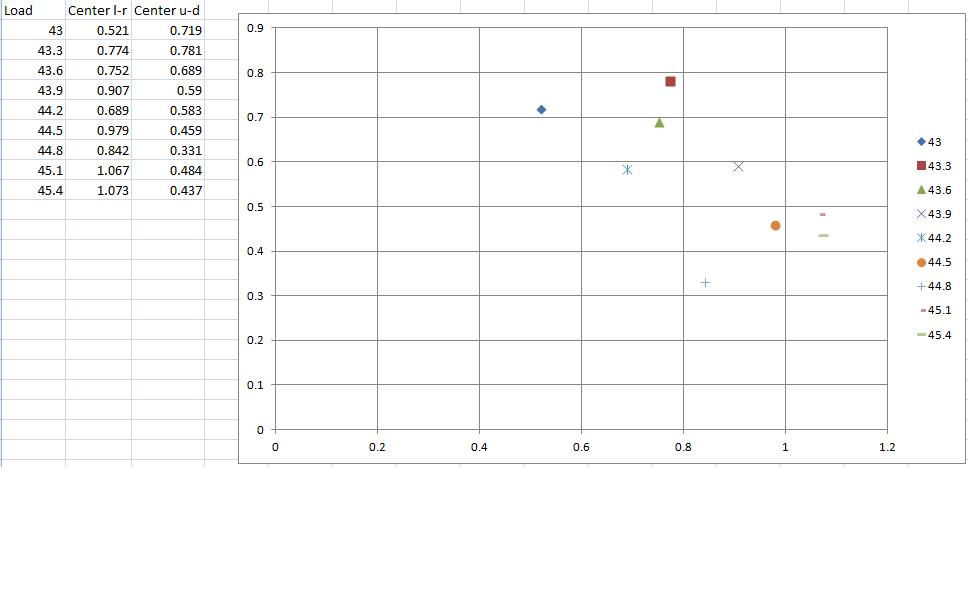

So they all seem pretty close, I did a graph like I normally do, I'll have to add that in the next post.
Ha! For a second there I thought you stole one of my graphs! Apparently we use excel the same way when doing OCW... At first glance it looks like a node in the two highest gr loads: 45.1 and 45.4. Did you chrony? I like to compare velocities with the group centers. Also I chart group sizes and velocity SD.
--- aim small miss small ---
I didn't, I have magneto speed and didn't want to take the chance of it effecting anything. That's going to change tomorrow I have another ocw to run with 140 amaxs, and will have the chrony.
To me it looks like 43.3-43.6 and 45.1-45.4 look to be nodes.
