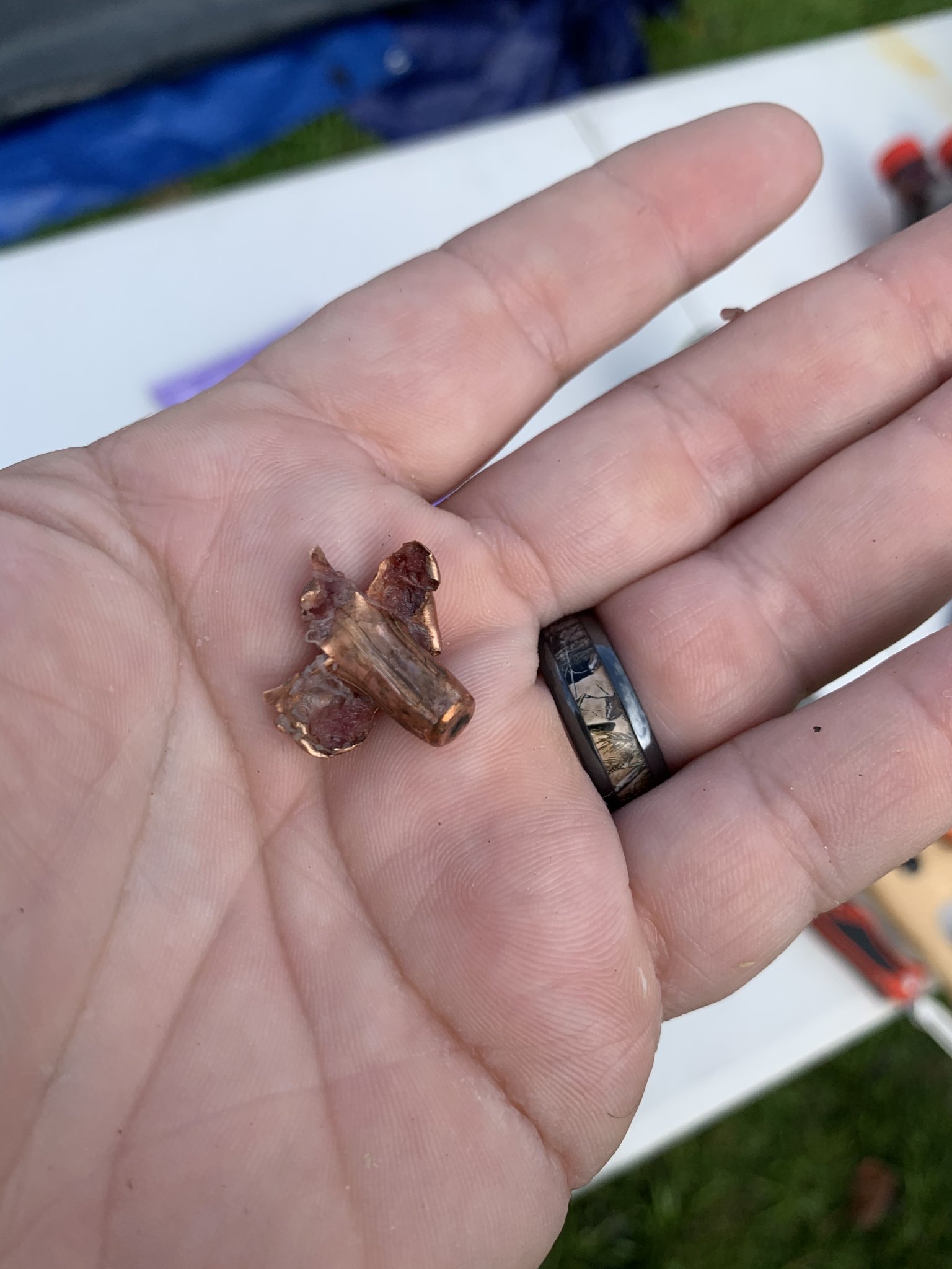

I would load up some 6.5mm 140 VLDs Berger’s and call it a day. That’s the only hunting bullet I’ll ever use after trying several. Plus they have a very high retention weight.
