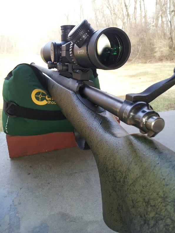

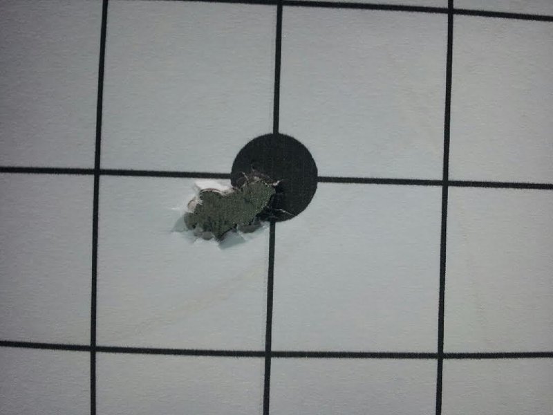

    My dad just finish a 26" Criterion Remage on a Rem 700 long action. Heavy Sporter Contour.
    It shoots.
    Norma 280 brass fireformed
    168 Barnes LRX (hunting gun)
    58.0 grains of H4831SC
    Who says you have to true remington 700's?
