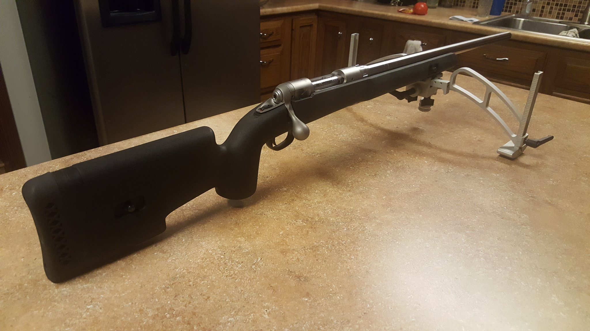

I just put a 284 Win together trying to test the accuracy of a standard savage action w a match barrel then swap it out for my bighorn and see what the difference does as far as accuracy.
Gun specs are:
Criterion match 28” bull 1-8 RHT
Trigger Basix sac-1 trigger
Oryx (MDT) chassis and mag (3.560)
shooting Berger 180 hybrids (have 180 ELDs and Berger 184 F opens to try next).
RL 17 @ 52.6 gr, Norma brass, BR2s, 3.273” overall length@ a .020” jump only depth tested.
only 63 rounds of load development so bbl is still speeding up. Have 7 rounds of 52.6 for a 3.4 s-d es of 7. I’m waiting on my rail and scope to show up so am shooting what was on the old savage and groups are all sub MOA but should tighten up considerably w/new scope. Velocity is @ 2,894 but will end up faster w more break in. All rounds fired at roughly 5k elevation and 21-32 degrees so haven’t seen any negatives from the RL17 and never shoot above 90 degrees.
I have almost always been a heavy bullet for cartridge guy with as much velocity as I can get but have other 7mms in 28 Nos and Rem Mag so am just looking for a very accurate load that I can utilize brass and barrel life on. I am shooting RL17 and know it’s quite a bit faster than H4350 and 4831(sc). I have 20 lbs of 4350 so will probably end up trying a load w that as well.
I’m looking for thoughts on a load or range that will give some longevity on brass/barrel life but still utilize the BCs on 180 class bullets.
barrel isn’t seasoned yet and will change but I haven’t seen any real pressure signs through 53.5 other than a couple of faint ejector marks which I get on just about every other cartridge I load for w exception of 223 and 6BR.
I decided to go w Norma brass as I didn’t want to expand lapua and deal w donuts. Does anybody else have experience w Norma brass? I tried to get Peterson brass but grafs is on backorder but if anybody has experience with Peterson brass I’d love to hear it... especially velocities between Norma and Peterson.
Overall, I’m loving 284 Win so far.. my first 21 shots were .3 and .2 gr from 47.0-52.6 and grouped like finished group most of them which is pretty unique over 250ish FPS spread. I can’t wait to get this dialed in!
