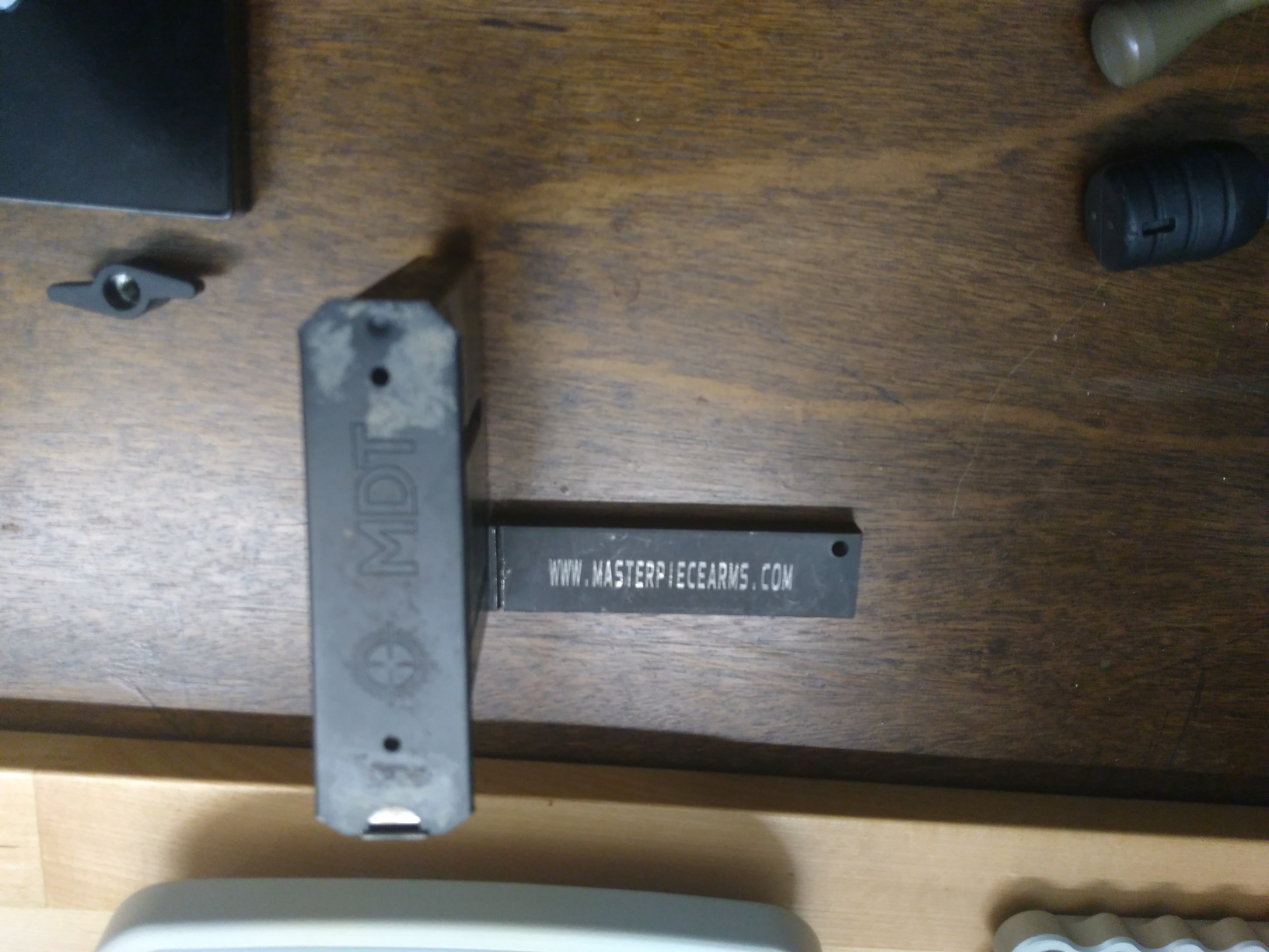

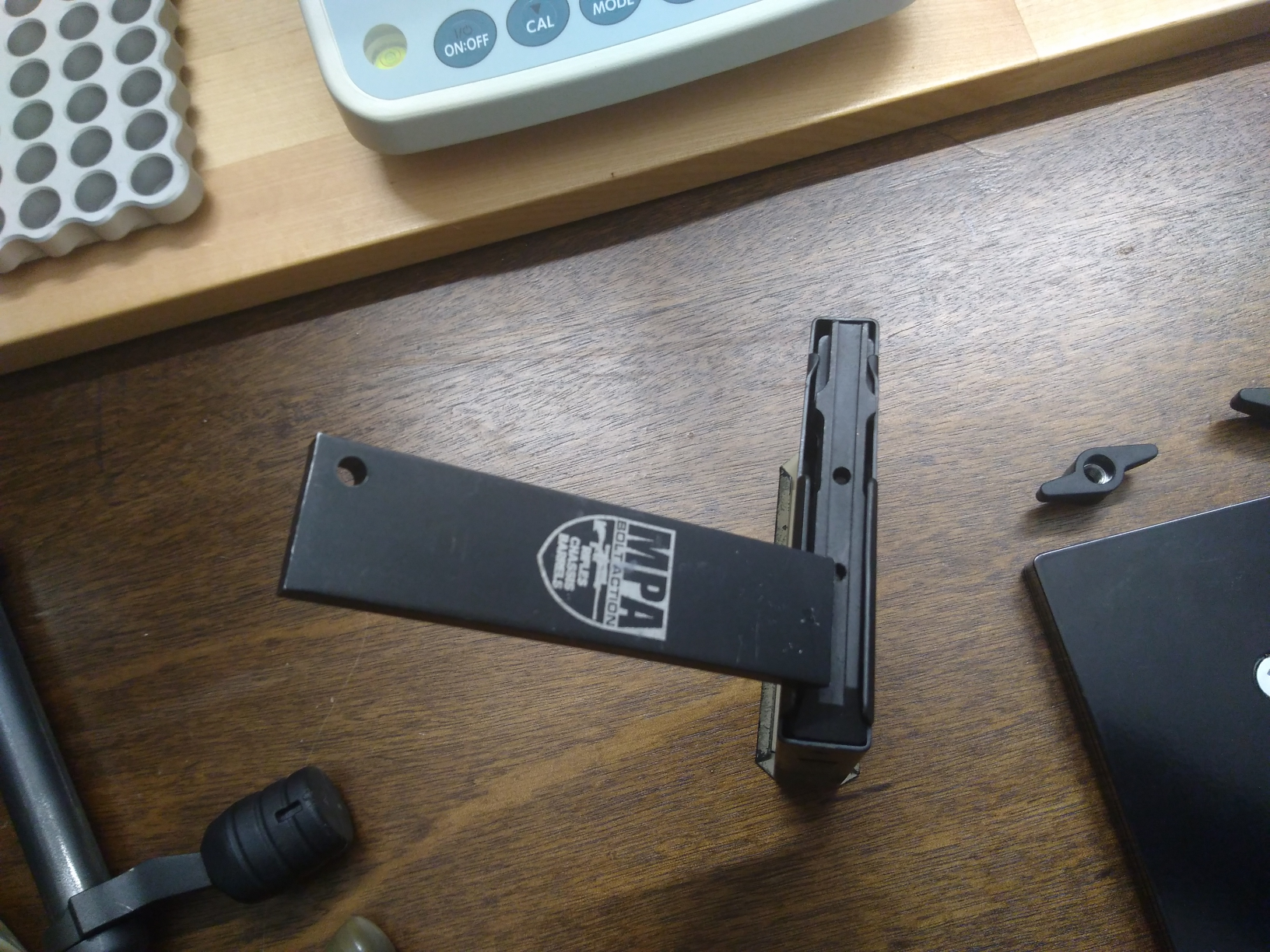

The MPA Feed Lip Adjustment Tool is just a hunk of aluminum with an angled groove cut in it....and worth every penny. It allows you to easily tweak the metal feed lips to precisely align that primer up exactly where you want it height wise...and get reliable feeding out of different sized cartridges. It is a must have for my range bag.
Unless they are MDT mags...their lips are thicker and don’t fit in the MPA tool😟
Works great on all my MDT mags.
Well...hmm....this might best be answered by @MDT_OFFICIAL or @MDT_Josh
Hey guys...are the 308 magazine feed lips thicker?
Nope, they should be the same thickness across the 12 round SA and 5 round CIP. Also, for the OP, you'll find that there may be some other issues running a "shorter" long action cartridge out of a CIP length magazine and stacking/feeding could be a concern. I can look into this more when I am back in the office, but the feedlip bending too should work across the board :)
Our sheet metal thickness is .040" +/- so you could also make your own bending tool with a check of aluminum and a hacksaw ;) Don't ask us how we know.
