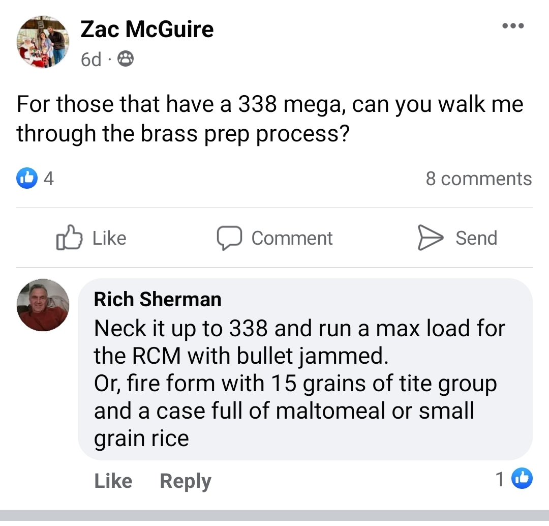

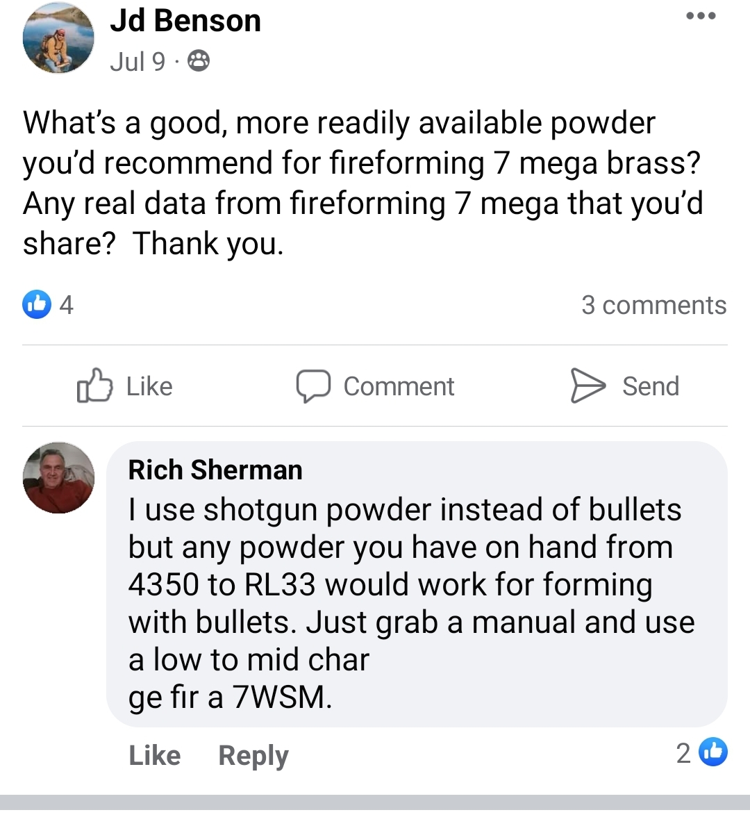

Atleast his advice is solid and consistent....
