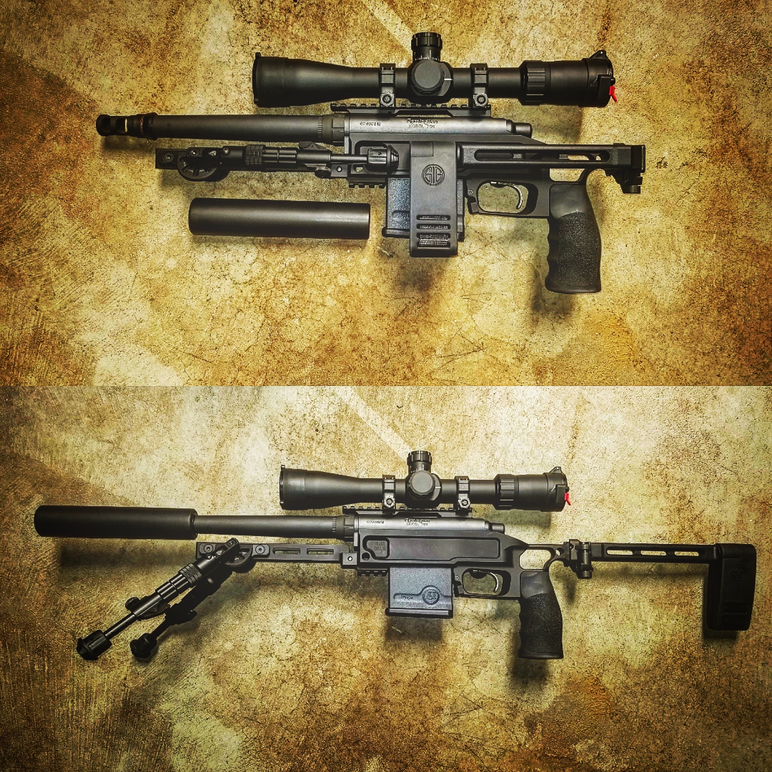

    This isn't an sbr, but it is my short barrel bolt action 300 blackout! I haven't done any load development yet but I have plans to this winter.
    *KAK 9 inch remage barrel
    *Stripped rem700 reciever
    *Black Collar Arms Pork Sword Chassis
    *Sig mcx brace
    *Badger Ordnance rings
    and 20moa base
    *Ergo Veritical grip
    *Weaver Tactical 2-10x36
    * SAS Reaper suppressor
    *UTG mlok bipod (don't laugh, it's pretty stable)
    This picture is off my Instagram page.

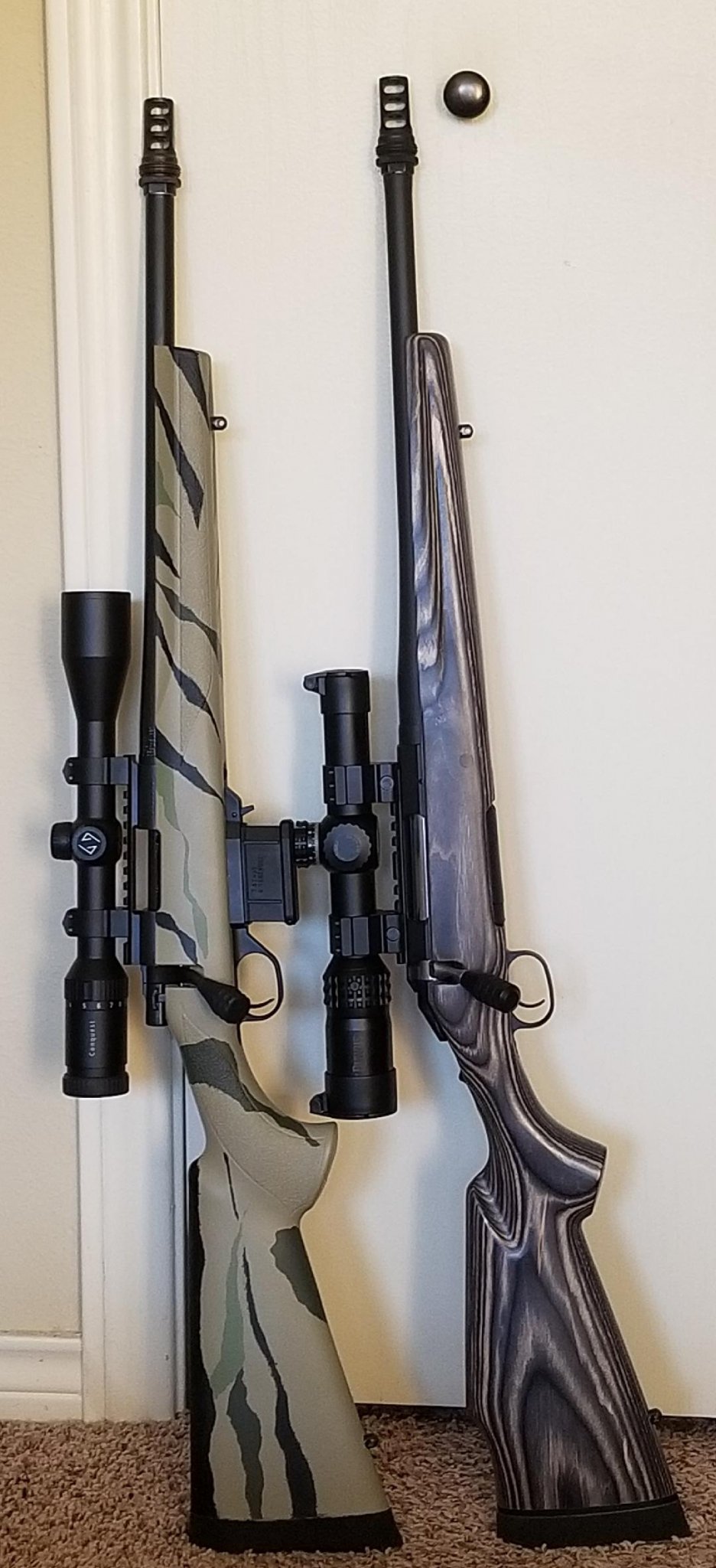

    Honestly, it might be my favorite rifle to shoot in the collection at the moment; light, smooth, and the (modded) factory trigger leaves little to be desired. If I really pay attention to my shooting fundamentals, it'll group 12x grain cheap-o steel case hollow points into a pretty consistent 1.25-1.5 MOA with the occasional sub-MOA group (all at 100 yards; I haven't stretched it out at all).
    I have another Howa mini that I had rebarreled into a .223 AI and dropped into a Boyd's Pro Varmint stock, and that, too, is an absolute joy to shoot. It, and a T3 in .204 Ruger are my prairie dog rigs.
