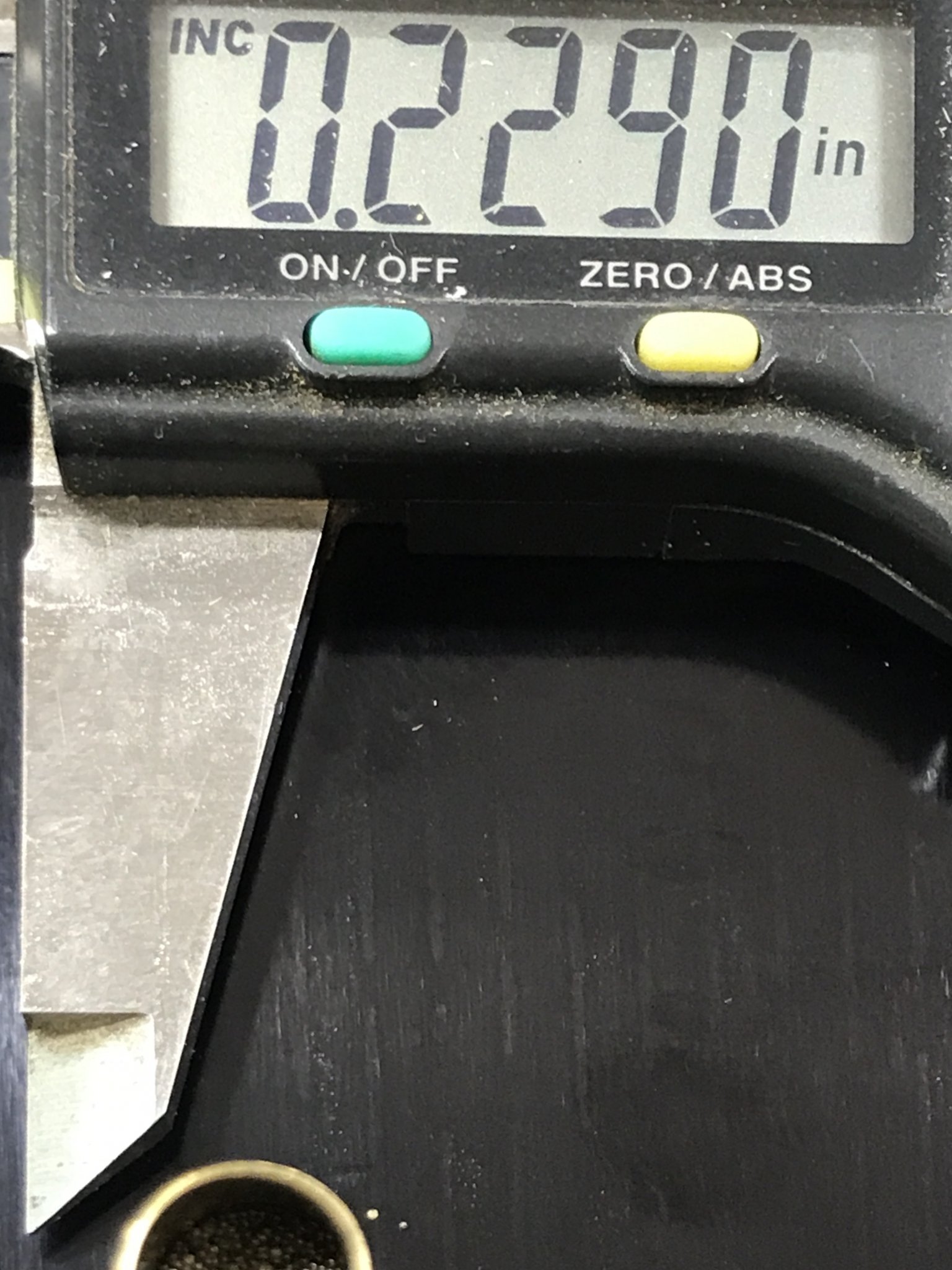

The part of the ogive that measures .250" has to sit behind the front guide rib on a 223 mag.
In my Pmags this means I use a 25 caliber comparator insert (.250" hole), and seat CBTO length of no more than 1.670".

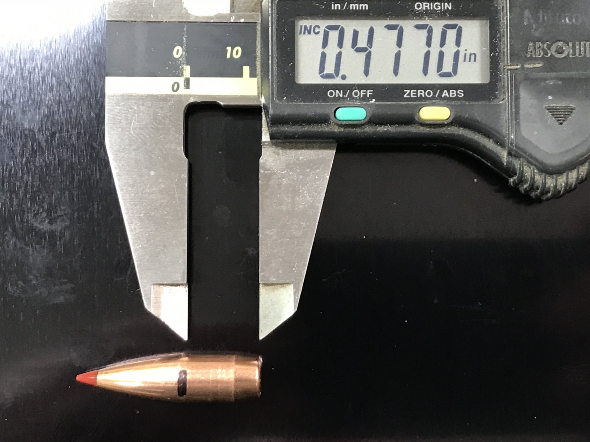

I would compare known, published bullet lengths (and weight) to the eld-m bullets you have and then try to work a comparable bullet seat depth (in the case).
(case length + bullet length) - COAL = Depth of bullet in case
This speaks to your case volume and how much you are (or aren't) compressing your load. Some powders do ok with compression, some not so much. Either way, if you start on the lower side of the listed range, and at a bullet seating depth (NOT COAL or CBTO) the same as a known safe load, you should, theoretically, be ok. There will be slight differences in pressures due to bearing length etc, but it won't be from compressing the powder. You can then work up and down to find the combinations that works for you.
This may take time and resources to figure out, but it is one way to figure it out safely for your rifle.
ELD-M = 1.195"
HDY IB (150) = 1.260"
(1.363+1.260) - 2.235 = .388" depth in case for inter bond
Now switch it around for the ELD:
(1.363+1.195) - .388 = 2.17 COAL
The ELD seated to 2.17 is similar to the HDY IB at 2.235 when talking about case capacity/fill/compression. There are slight differences in volume with different shape boat tails, etc, but for the most part, it is pretty darn close.

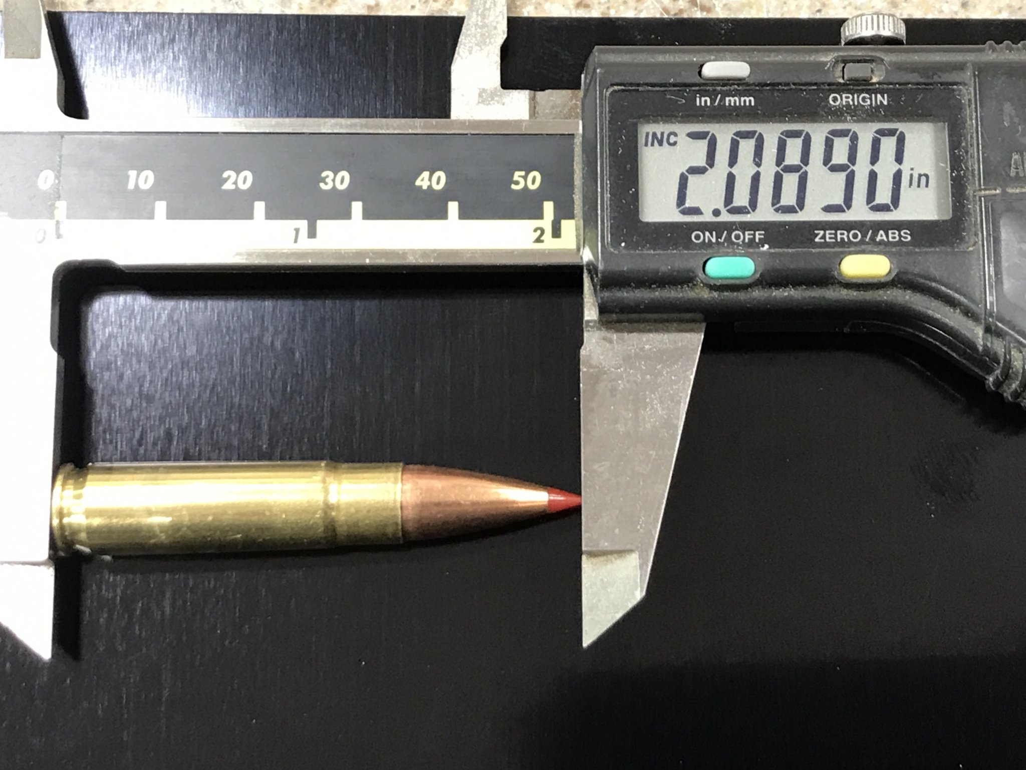

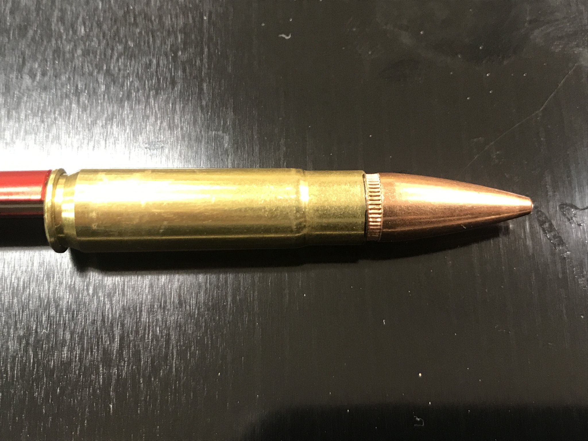

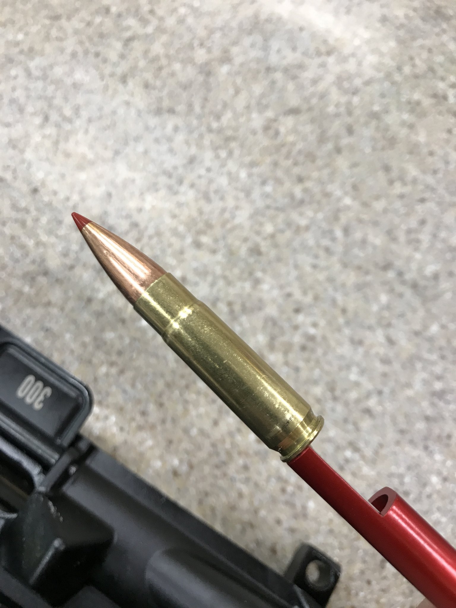

Sorry it took so long to get back to you all. I needed to time to document it correctly to get the proper help.
Here's where I'm at, and what I'm confused by.

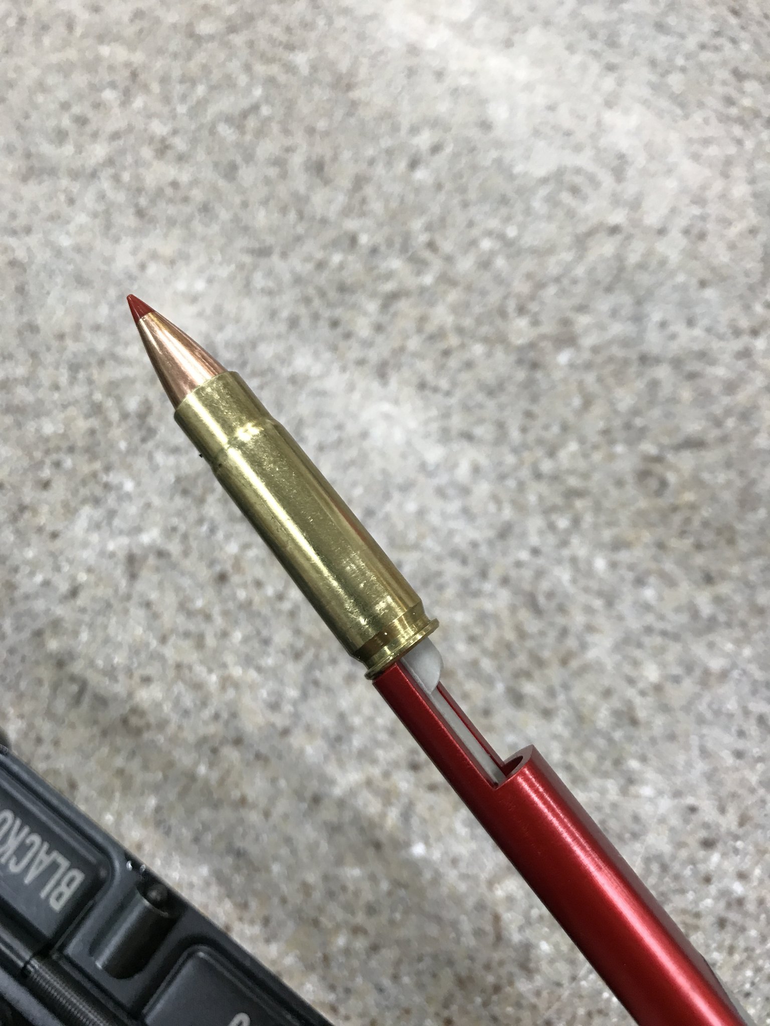

Took the OAL gauge and inserted a bullet, pushed it back a good amount and snugged up the thumb screw so I could insert it into the clean chamber.
Insert it into the chamber and loosen the thumb screw and then gently push the gray rod until it stops, with light tension. Tighten the thumb screw and remove it all. The bullet comes out still in the cartridge so I know it's not jammed into the lands.
The problem I get is that this OAL is really short by all documented standards. It's so short that the Hornady gauge still has some of the gray protruding that keeps me from measuring it accurately (see photo). See the small part of the gray rod that's sticking past the casing?
I manage to get it measured and it's showing :
The Hornady book shows the OAL using this bullet to be 2.110". That would put me at .020" into the lands (roughly) with the factory length.

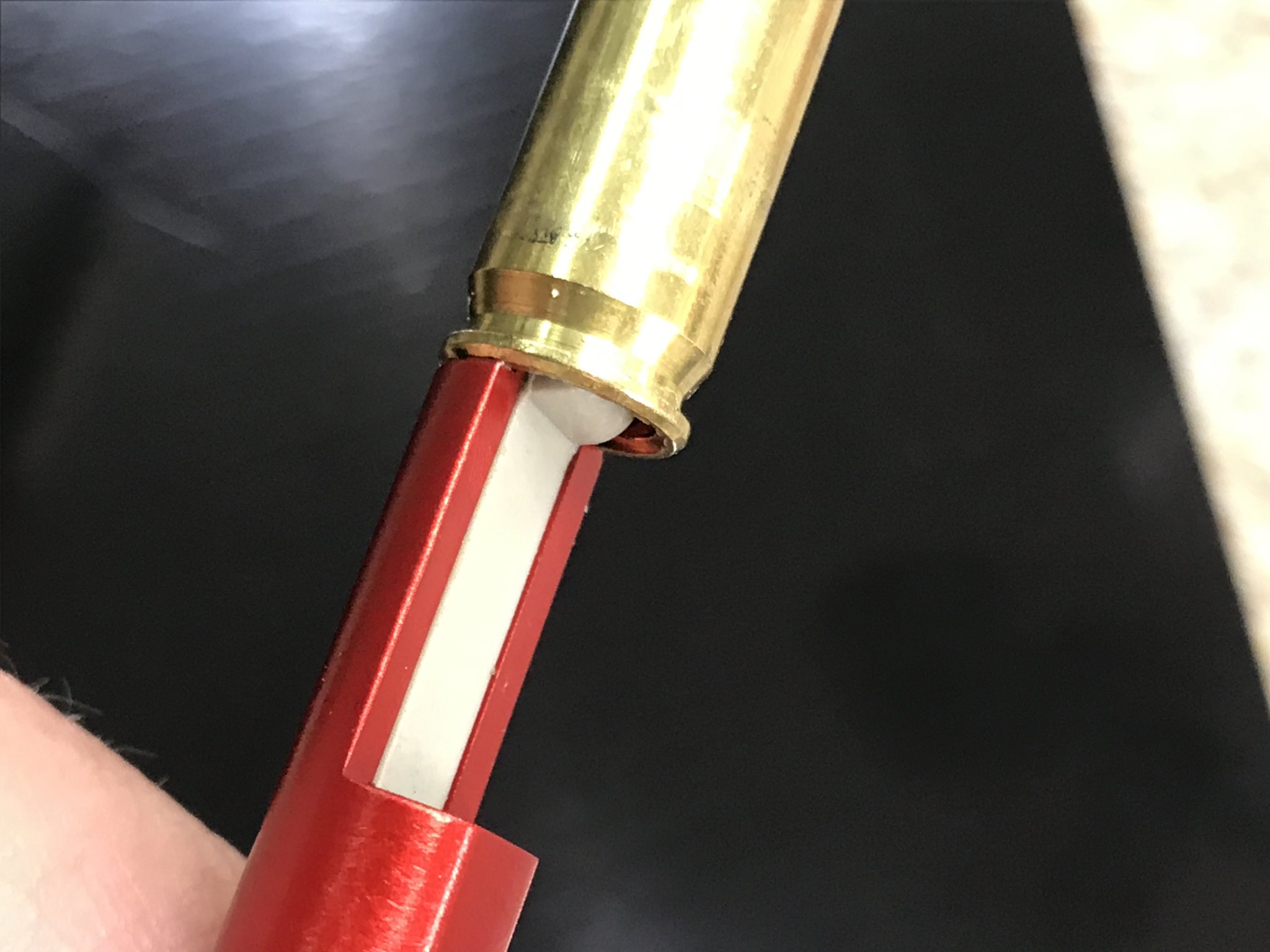

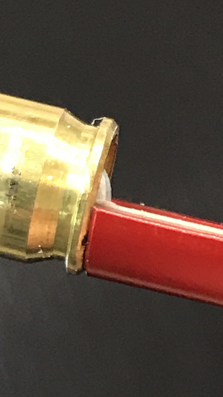

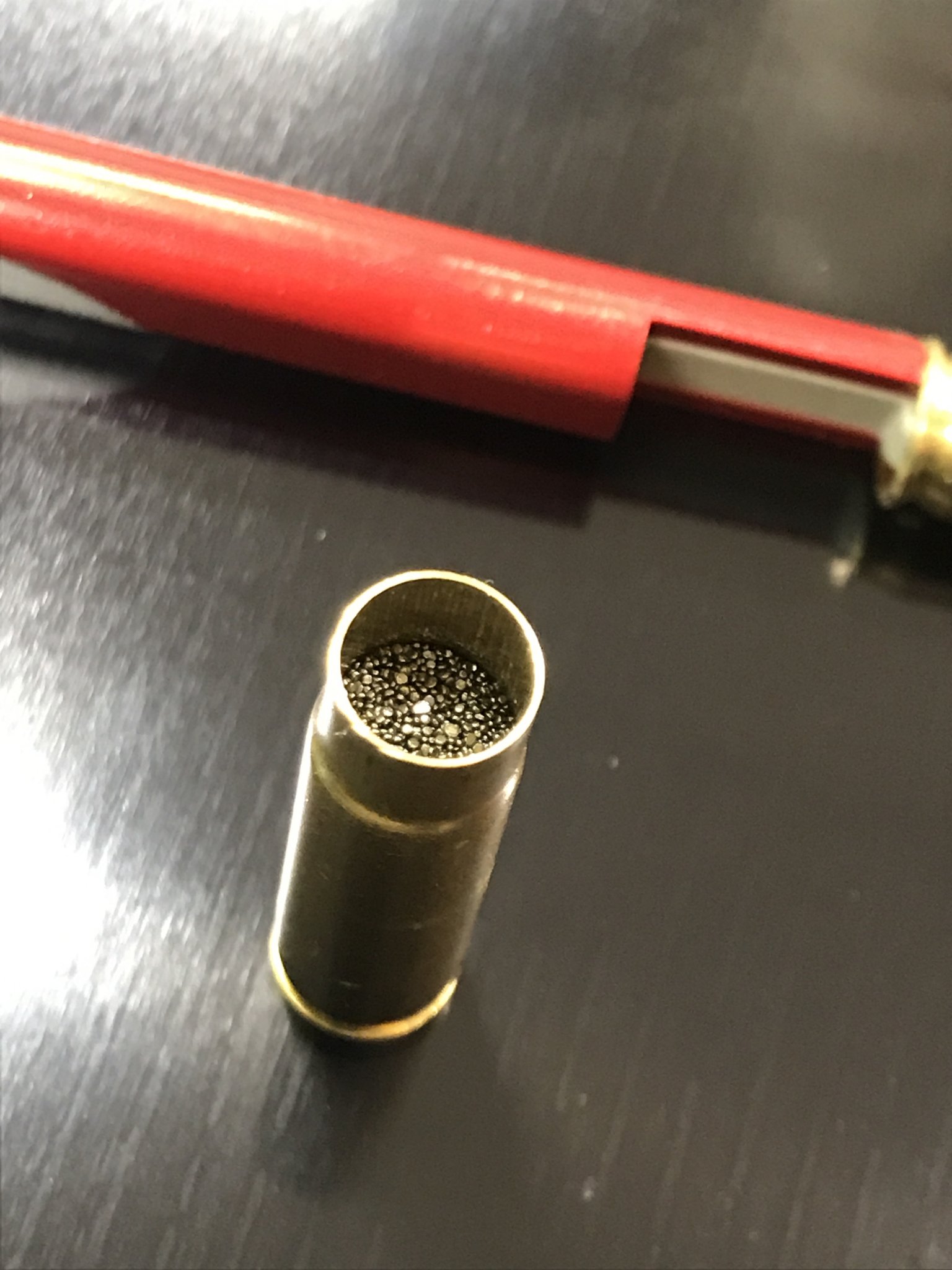

Here's the case with 18.9 grains of CFE BLK (amount comes from Hodgdon's site). You can see it's up to the neck.
However, here's how deep the bullet shows it should be seated, to be touching the lands, with zero jump.
Here's how much room I have (roughly) from the powder to the top of the case
That means I'll have to press it into the powder about .250". Doesn't seem right to me. I thought I wanted some level of jump, but even the Hornady book OAL has me into the lands +.02".

That load data seems to be consistent on the Sierra load data and the Hodgdon site, along with the Lyman, I think. I’m not sure it was Lyman but I had a guy at the place I got the powder look and he pulled out 2-3 books and all of them said the same thing.
Should the Hornady load length set the bullet in the lands? Because it does. The 2-3 other books showed an even longer length, putting those even further into the lands.

That’s what I’m trying to do. The questions I asked, with photos above show the length it needs to be to hit the lands and the full cartridge in the photo is a minimum load, according to no less than 3 loading sources. I have no problem abandoning this powder, I’m asking because I’m trying to learn. While trying to learn, and following guidelines by the manufacturers, I’ve run into question that I don’t understand, which is why I stopped, and am asking questions.
Should my bullets be loaded to jump or be in the lands, because all load data I see, with this bullet, puts the load well into the lands?
My first loads were with H110, and they worked but were well into the lands at the 2.110” OAL. I was also getting a SD of 40, which is part of the issue I'm trying to resolve, which is why I'm asking the questions.

OK, I'll make it real simple.
Do not load into the lands...especially with a semi-auto. I don't care what length the book says.
If it is into the lands for your rifle...then it is wrong. (Or your rifle is wrong.)
Do not compress powder to the point you are crunching powder kernels. I don't care what the book says. If you are crunching powder kernels, you are wrong.
If the minimum charge requires you to crunch kernels...then the book is wrong.

I don't think I'm getting the right measurement to the lands. I'm stopping at the very least bit of resistance. If I push further, the bullet OAL is about 2.280" which is in line with what all the specifications would be for the Max COL. I feel like I'm stopping short of the actual place I should be stopping, which is causing me this confusion. Is that's where the lands are, at 2.280", then it means there's a pretty huge jump when I seat that bullet to the Hornady recommendation of 2.110". One of the books the guy looked it up in (maybe a green book, Sierra or RCBS?) showed a COAL of 2.180". That would make more sense to me. That would be .100" jump instead of a .170" jump.
One point that I notice, if I set the gauge with the bullet in it at 2.180" and put it in the chamber, every time I pull it out, the bullet is still in the cartridge. If I put it to 2.280", every time I pull it, the bullet is in the barrel. To me, that's telling me that I haven't been getting the right measurement all along, I've been stopping way too soon.
That makes more sense, doesn't it?
Color it with a sharpie, see if your short measurement gives you imprints from the lands. Your long one will have imprints.
You can shorten a loaded round incrementally with the seating die and find the point where it stops putting the imprints in the bullet.
Did exactly that. At 2.110", I see no marks on the sharpie. 2.180", no marks. 2.280", I see marks. What I believe was happening is that I wasn't holding the back end of the gauge perfectly in line with the bore. If I wiggle that around slightly, it seems to allow it to go up to the place where it's more of a hard stop. I trust that's the place I'm looking for, correct? Not having ever felt what it's supposed to feel like, I stopped at the first sign of resistance. A little push further and it really stops.

If you look at the Hodgdon data closely, you will see that CFE BLK is not a powder that fits a 150 gr bullet. With a long bullet seating and a compressed charge the load develops only 33,500 psi. It is too slow and bulky to get good performance. The long COAL is to maximize case capacity. If you read the powder description its optimized for heavy subsonic loads. Hence the high volume.
Botton line is your bullet, cartridge and powder don’t play well together.

For me 19.4 gr with a 150 gameking was a great performer. It was right around 1800 fps in my 16" barrel I think (sold the rifle awhile back)
20 grains was juuuust starting to give me some pressure signs.
I was using 4227 powder loading supers with the barnes black tip 110gr. The case was full to the case mouth and seriously compressed. Never had any issues. I did use a string to pull the trigger the first time. 🤣🤣🤣

It looks to me, since my revelation about the length being wrong, the way I was measuring it, that with that powder (CFE BLK), the ELD's will work fine. The Sierra TMK's seem to be very similar and they are showing a OAL of 2.250". If I loaded them at 2.250", or slightly less, it looks like it will work fine and not compress the powder and work with that bullet. I'll use these until they are gone and then switch to something else.
