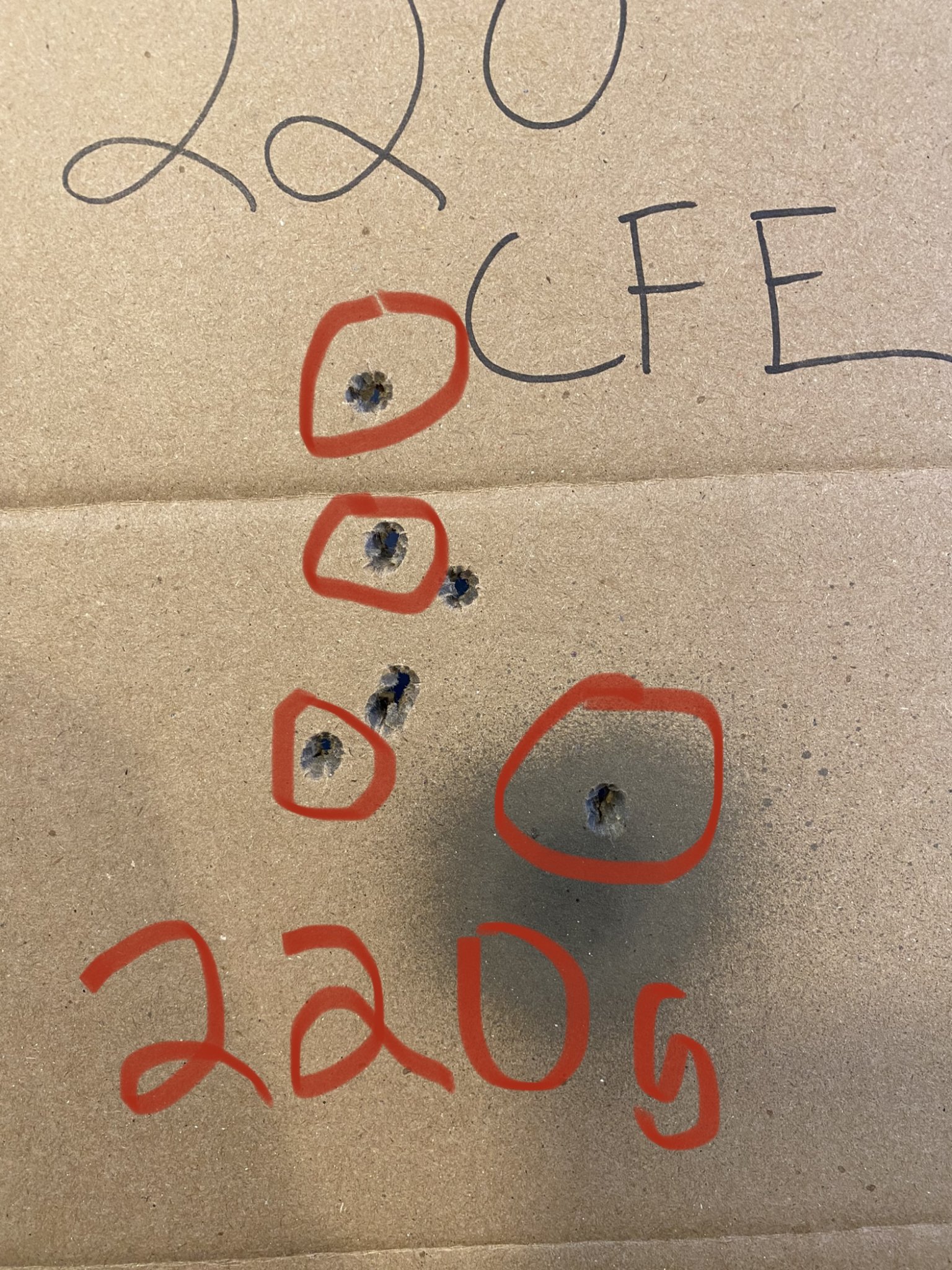

I have a Wilson combat 8” 1/7 twist barrel and I’m getting oblong holes using a 220g berrys bullet at around 975ish FPS using CFE black
First off, CFE black is complete dog shit. My SD is +/- 60 and yes, everything on my end is consistent. There’s zero powder I can even buy to try out. My buddy uses 1680 but I can’t find it.
The accuracy is great but the holes are oblong. Not tumbling but the bullet isn’t completely stabilizing. Could powder be the culprit? I had another 1/7 twist 8” barrel that I was having serious accuracy issues wjth so I ponied up and bought a Wilson. Accuracy issue is solved but now oblong holes.

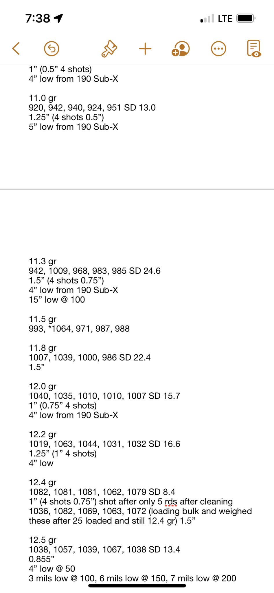

Here’s some data I got with Seekins 8” 1-7
Groupings we’re at 50 yd. No wobbles or keyholes.
69F 28% 30.07in
Berry’s 220 gr .300 Blk SP
A1680 powder various grains
BTO 1.6620

Range report.
I think the 220g bullet is to heavy for this barrel. I loaded them to 2.190 OAL and same results. I tried using 1680 pushing a 220g and I had the same results.
My best group was with a 208 hornady match bullet but I don’t want to pay .50 cents per bullet. I just ordered some 200g berrys bullets to see what happens.

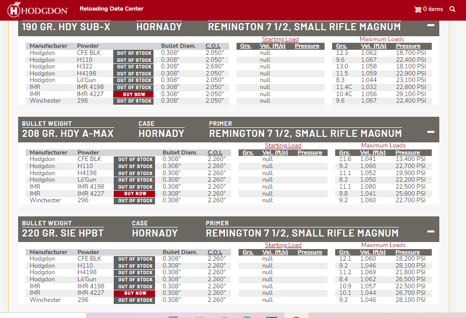

...hope you're not using a suppressor, you're risking a baffle strike if those bullets aren't stabilizing....
...IMR 4227, 300MP and #9 can all be used for sub loads, even LilGun and case fill will be low enough you can seat the Berry's even deeper, just be mindful of the feeding when seated deeper..
...Speer, Hornady and Nosler all have bullets in the +175gn-220gn range that are comparably priced to the Berry's, check out Grafs. The Hornady 190gn Sub-X bullets is only a cent or 2 more than the Berry's you've used.
Even 150gn FMJ's can be made subsonic...
