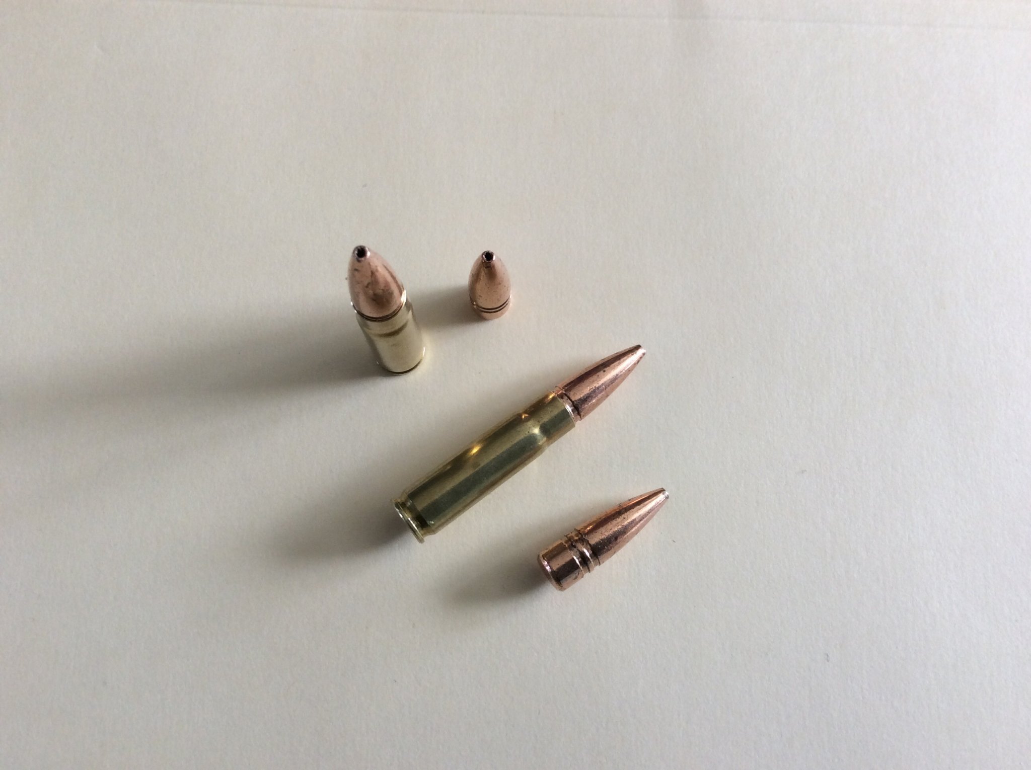

I bought a bag of pull down 130 grain 30 cal bullets from RMR a year or so ago. They described these bullets as: 308 130 gr, Mark 319, sost, otm. For barriers, windshields, etc. May be solid copper, have not cut one apart to verify. I have shot a couple dozen through a Ruger ranch in 300 BO, suppressed. LC brass, win primer, 19.2 grains 1680 powder.
I shoot the Hornady 190 grain sub-x over 11.7 grains of 1680 ( shot in AR and Ruger)
I shoot the Barnes 110 grain Tac-Tx over 19.2 grains of H 110. (shot in AR and Ruger)
I shoot the Nosler BT 125 over 18.5 grains of H 110. (shot in AR and Ruger)
I run a very heavy buffer, gas block is NOT adjustable. Bolt does lock back on an empty mag. Your mileage may vary, work your way up.
Picture attached of the pull down RMR bullets

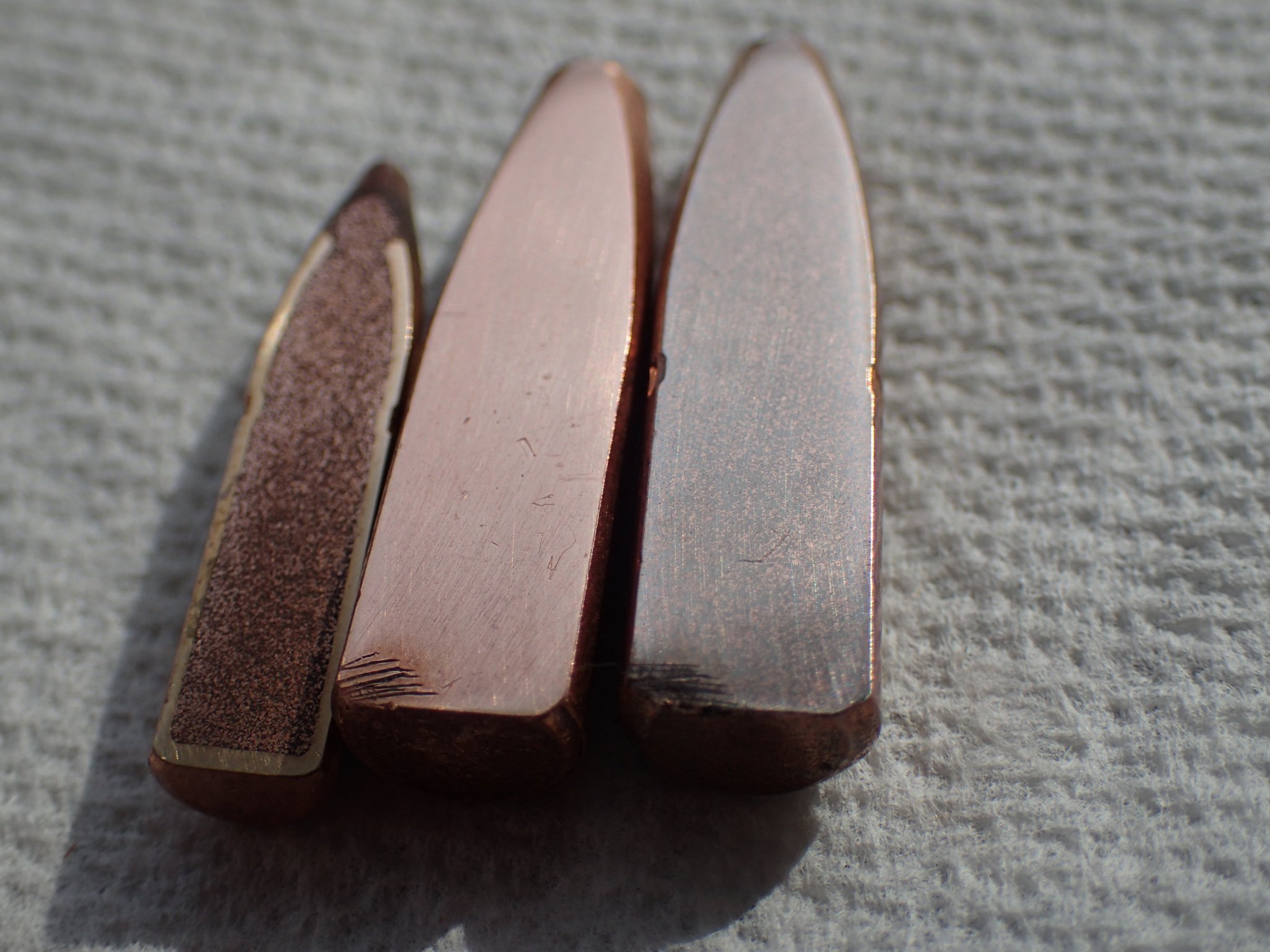

I got distracted with other projects but think I finally have this sorted (kind of a stream of mistakes and mis-information) so this is mainly for future searchers on this bullet.
Not having found any specific load data I decided to cut one of these "copper" bullets apart to see (try to understand) what the alloy was. With no cannelure groove I was kind of suspicious of them being full copper)
They cut like all copper with a hacksaw but when the cut pieces were smashed on my anvil with a hammer they became dust and small porous pieces (definitely not an all copper bullet.
These were marketed and sold as a copper bullet so that is just not true. They sure looked like solid copper but definitely are not.
So with a little research I found this frangible bullet along with recommended load data. The recommendation is: __ Use Hodgdon load data for a 168gr. jacketed bullet.
I did similar tests. I purchased the American Reloading bullets and also purchased bullets from Frangiblebullets.com. .
I ground down both bullets in our analysis lab at work after hours and determined the construction of the two are not the same. After grinding down the bullets 1/3 way (like filleting a fish) I sanded and polished the exposed metal core surfaces and looked at them under a microscope.
The frangiblebullets.com bullets are made of some copper powder plus some other binder or other grey metal powder mixed in. (It has the copper powder graininess appearance but some lighter grey metal colored stuff mixed in) It makes the bullets more brittle. The AmericanReloading bullets seem to be made of more percentage of copper powder. (The appearance is all copper looking with minor graininess.)
If I pinch the Frangiblebullets.com bullets with large wire cutters, I can get about 25% through it and the bullet will break/fracture apart along the cut line. The AmericanReloading bullet is able to withstand almost cutting past 40% and it does not fracture. I wasn't strong enough to get it to fracture but with better cutters I probably can. Under the microscope, I can scratch small particles off the Frangiblebullets.com bullet but have more difficulty scratching particles from the Americanreloading bullet. The Frangiblebullets.com bullet has a cannulure and the AmericanReloading.com bullet does not.
In addition, the brown tip .223/5.56 bullet Americanreloading sells is a thin copper jacket elongated "cup" and filled with powdery copper mix and the tip pokes out the opening of the cup to form the tip. In the photo:
AmericanReloading.com 223/5.56 bullet on left,
AmericanReloading 308 copper bullet in middle,
FrangibleBullets.com 308 bullet on right.
