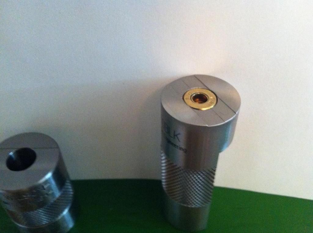

I have an AR in 300 blackout.I am reloading some 2x fired (once as 223/556 once as 300blk) cases. I think I might be paranoid as it took me forever to fix a stuck case issue in my 223/556 AR.
I full length resized with my hornady 300 blackout die and also backed out the neck on my RCBS small base 223 die and ran it through that as well.
I take both my LE Wilson case gauge and my sheridan engineering slotted case gauge.
I then seat a CCI400 small rifle primer and load 17 grains of h110
http://sierrabullets.files.wordpress.com/2013/07/300-aac-blackout.pdf
my intention is loading 5 rounds in .1 intervals between 17 and 18.1 using 125 SMK HP
I intended to load 60 rounds but I stopped, because of something curious
It is under length

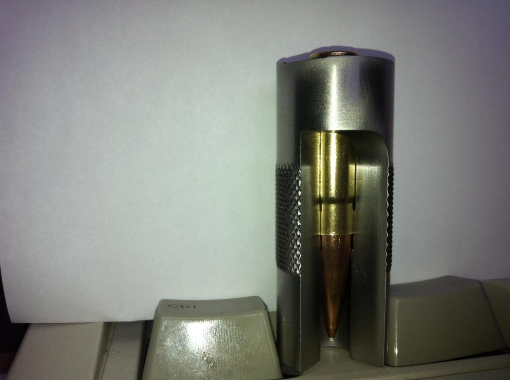

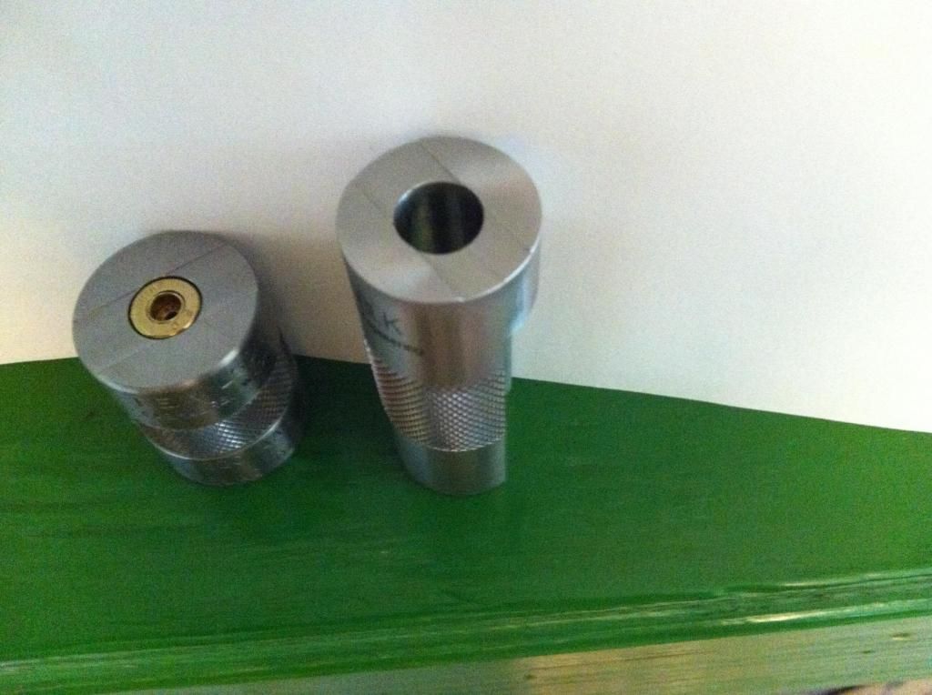

But it won't go flush in my Sinclair slotted case guage

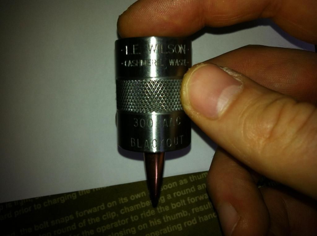

Of Course it seats great in the LE Wilson gauge. I had issues with the LE Wilson gauge causing stuck cases in my 223 AR 15, which is why I have both an RCBS small base die and a set of sheridan engineering slotted gauges
I plan to buy an extra firing pin at the next gun show so I can grind it down so I can cycle rounds through an AR to check.
Am I being overly paranoid? I just don't want to comeback from the range pissed off about a stuck case.
I have 5 rounds loaded.
Should I carry on?
Am I overly paranoid?
As bugs would say I am a maroon, so clue me in guys!
What brand of brass are you converting? There are a lot of brands that have thick case walls that end up being thick necks when converted and they do exactly what your loaded rounds are doing in your slotted case gauge. There is a big thread over on 300blktalk with all the good and bad brands of brass to use. There is a reason I only use LC brass because it has zero issues with thick necks once converted.
Wilson gauges have their place, but they ARE NOT a loaded round gauge since the ONLY thing they measure is headspace and to a lesser degree trim length. They are bigger in almost every dimension than the min SAAMI spec. The Sheridan gauges are cut to min SAAMI chamber spec. If your brass passes that gauge it will function in every rifle(save for any that have tighter than SAAMI spec chambers like some CMMG chambers).
I would check the thread on 300blktalk and see if the brass you are converting is on the bad list. If your brass is passing the Sheridan gauge unloaded, then thick necks is what I suspect.

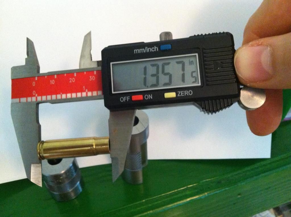

If you can measure the brass thickness of your necks that would help. Also the neck size of your loaded round. You can compare these to the SAAMI print out and see where your dimensions are off.
Check your neck thickness .Hard to tell in photo but it seem to be hanging up on the neck .If it fits the Sinclair gauge before you load the bullet its either neck thickness or crimp. What Brass are you using ? 300 blk forum has full specs and a list of brass that is GTG and some that needs necks turned.
Logic would dictate that it is neck thickness of the case.
I have the el cheapo harbor freight saw, but my current reloads were made from brass that was previously cut and sized.
I have had good luck with Freedom Munitions brass, which is reman but shot great.
I have half a dozen fired cases from factory 300 brass, but I was saving those for subsonics.

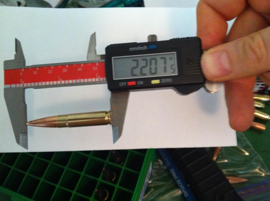

I had the rounds to an coal of 2.24 and had the issue so I shortened them to more closely match the Sierra PDF
Everything chambers....
