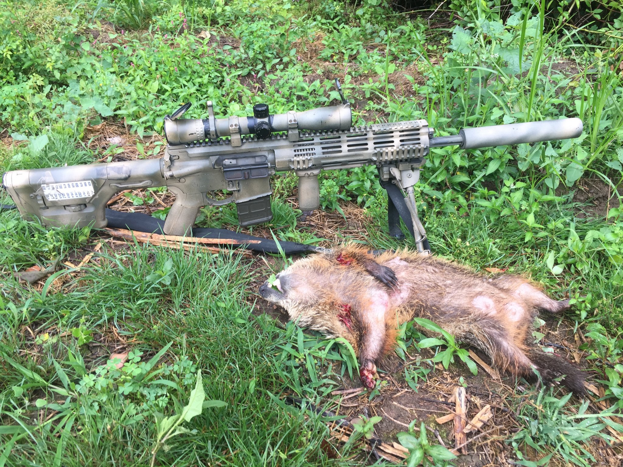

.300 blk out hunting bullets

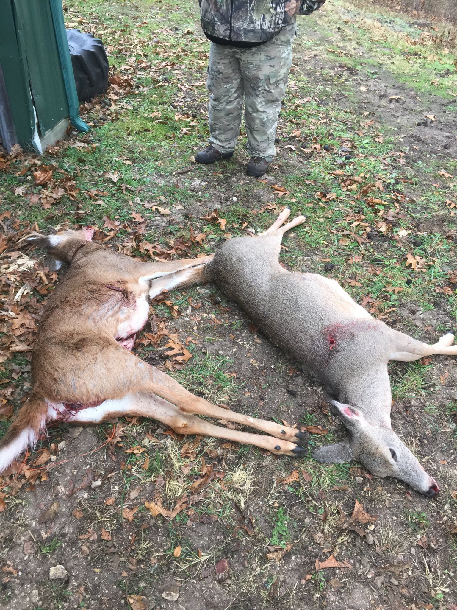

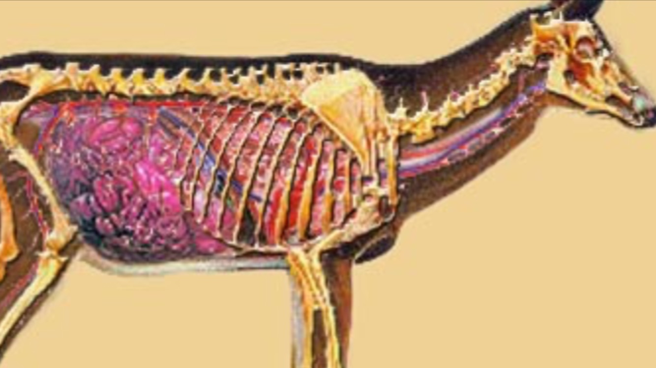

Must be mutant deer. Ribs and skin aren't very thick.View attachment 6944325

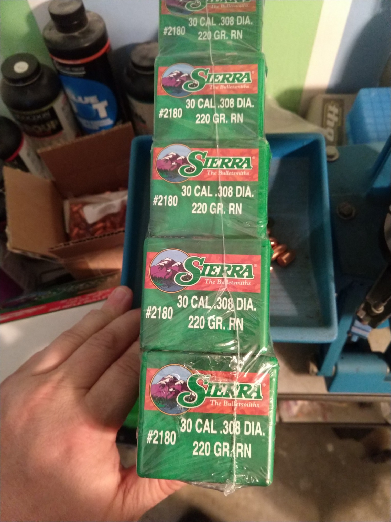

So I tired of the banter and went to the range with my 300 blk.
Off to a good start with the 220 fbrn rounds, no tumble.
Some tweaking of crimp and powder between 11.8 and 12.1 is needed in the next loads.
Had a couple "crack" at 12.0 but did not run my can to confirm yet.
As normal I pull one shot, in a hurry.

2 .300 BLK 220gr SGK
I’ve killed a half dozen with a .357, several dozen with a bow, more than chronic wasting disease with 7mm Mag and .30-06. My dad pretty much ONLY hunted with a 30-30, and killed more than you can dream. I have three Boone and Crocket deer from places in Missouri that don’t typically have them, so eat a bag of dicks ya dumbass. Killing a deer isn’t difficult at all. A 9mm our of a Glock will kill one with proper shot placement. Any cartridge that will penetrate, and preferably pass through, will kill. 220gr moving 1,100fps under 100 yards kills them deader than a doornail, no opening or mushrooming necessary. A .30 caliber wound channel is quite sufficient through the lungs ant the heart to end them quickly and ethically.
I used to think a 5.56 was too small to kill a deer. I was wrong. I hunt with guys who stack them, like the guys who hunt with a .300blk. Are you better off shooting a 180gr @ 2,800fps? Yes. Will a 220gr moving at 1,100 still kill? Yes. In fact it will almost always pass through on a broadside shot demonstrating its adequacy.
My state is full of deer. We don’t have the tough, armored ones that you do where you need magnums to kill them. In fact ours are so weak you can kill a trophy buck with an atlatl.

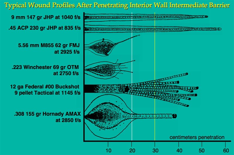

This is wrong. Temporary stretch cavity is very real, and comes into play above ~2200 FPS if I recall correctly.
300 Blackout subs have a reputation for being ineffective because the bullets used are not designed for those low velocities. Treat them like a FMJ pistol bullet and shoot accordingly.
I was a corpsman and I can tell you firsthand that a FMJ pistol GSW is a very different thing than a rifle GSW. Pistol bullets make holes, and have only crush cavity wounding.
Exsanguinarion internally and externally is why people and animals die if it isn’t a CNS hit.
Exactly, and temporary stretch cavity (basically, bloodshot meat is TSC in my experience) leads to more damaged tissue and more blood loss. The exception to this is lung shots. TSC ruptures alveoli and facilitated bleeding in the lungs, basically suffocating the animal in its own blood.
I’d have no problem shooting a deer with a subsonic 308 bullet, but let’s not pretend that doing it is a plug-n-play affair like sticking a soft point .243 in the boiler room.
I would read the book I referenced. It tracks with what I’ve seen, and with an incredible amount of battlefield knowledge saving soldiers who were shot, including every corpsman I’ve ever talked to and some who’ve worked on me. We’re now arguing degrees. A rifle will do more damage than a handgun, period. But it’s still the hole, and it’s just a bigger wound channel kills faster than a smaller one. It’s insignificant next to there being a hole or not. Hence, a .30cal hole in any animal will kill it if it bleeds enough/keeps bleeding as an arterial hit will, also period.
What looks good on paper doesn’t track, and flesh does not behave like jello.
The amount of hydrostatic shock from a temporary cavity isn’t very significant. Yes, it makes the wound channel a little larger...most like a .223 turning into a .45 rather than 1” or 2”s, which is what it sounds like you think if slow bullets don’t kill.

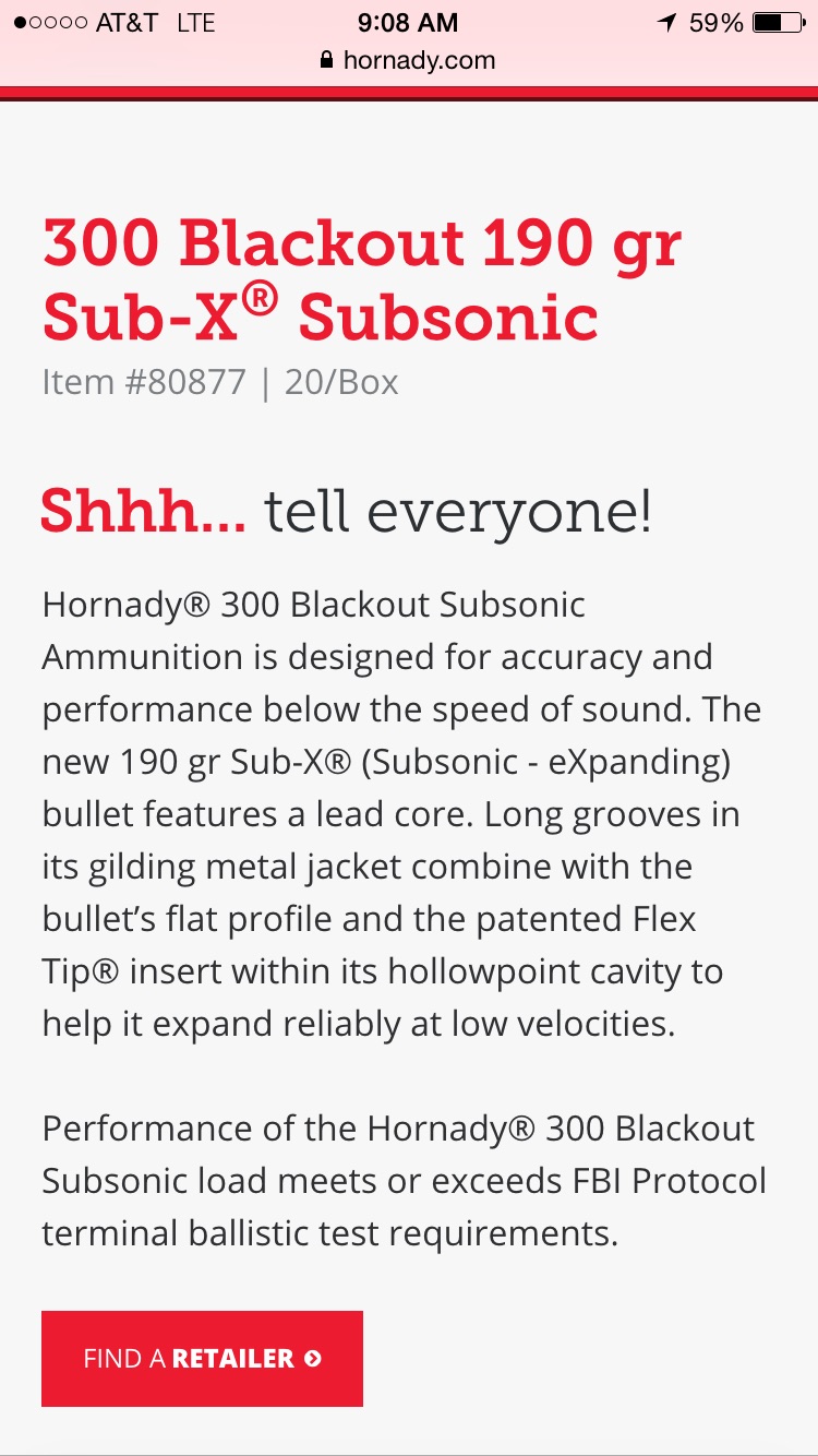

I have done a lot of reading on 300blk sub sonic hunting. I do mean a lot. I have come to three conclusions.
1. Choose a bullet designed for sub sonic speeds. Lehigh and Maker are the only two that come to mind, but I know there are a couple of others. I know Hornady has one, but I am not impressed with what I have seen in individual testing. Expansion is low and it tumbles, I am not into bullets that tumble.
2. Keep your distance close. 50 yards and in, but some will stretch it to 100 but that is to much in my opinion.
3. Keep it off the shoulder, treat it like you are bow hunting. Aim for the heart/lungs.
It is still loud, there is testing of how loud the bullet impact is down range. It is not for everybody. Many will find it pointless, or have done it and wont do it again, and some do it all the time with success.
The main thing, is just know the limitations of what you are shooting.
Reactions: Fig and oldfatguy
