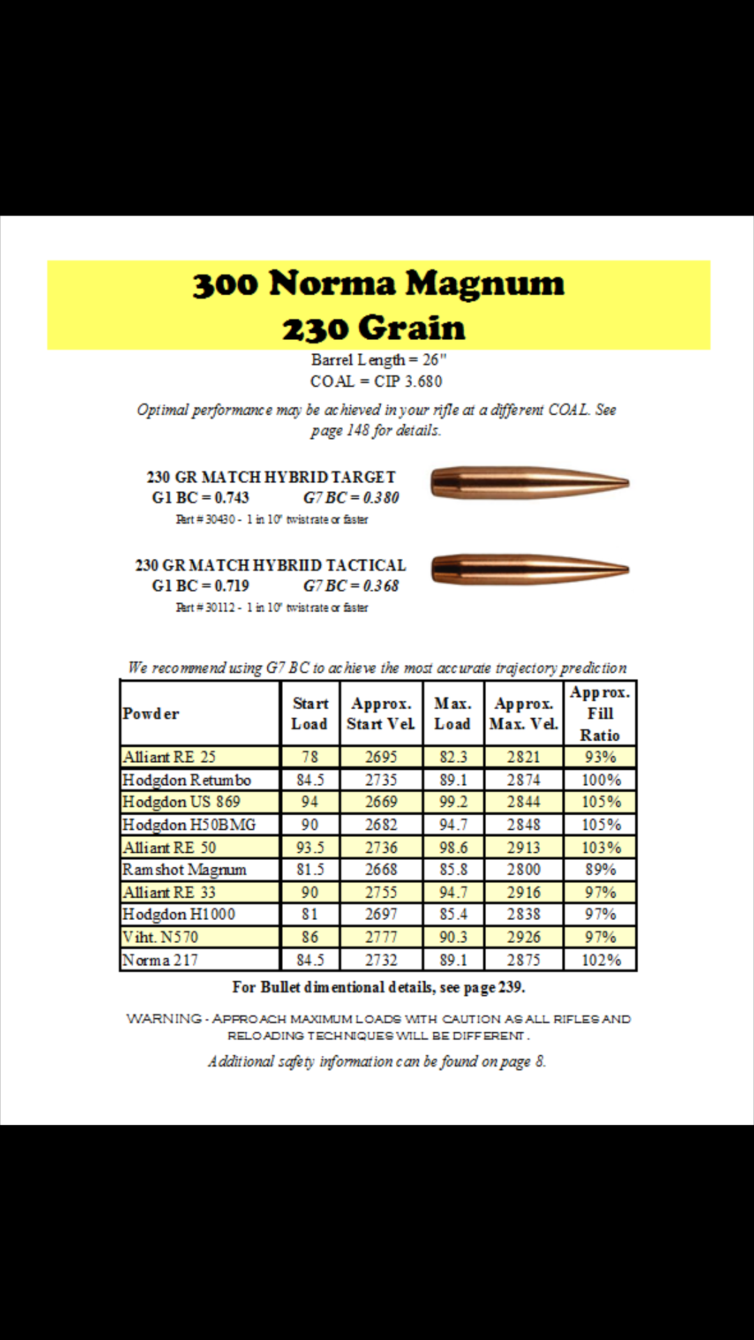

I've seen this Berger load chart before being circulated online and its not in my latest Berger manual. I also have seen various comments that say its way off and dangerously high. Maybe its just the Retumbo numbers that are high, I don't know. At 86 grains of retumbo I'm experiencing 3000 fps with a 25.5 inch barrel which is 125 fps over what this chart says I should be at 89.1 grains retumbo. I don't see too many people talking about going above 3000 fps so I'm not going to push above that without other solid sources of load data.

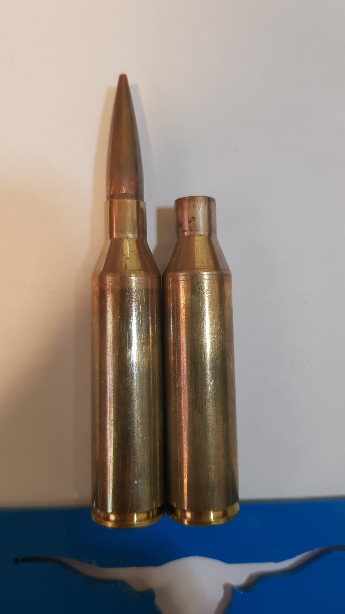

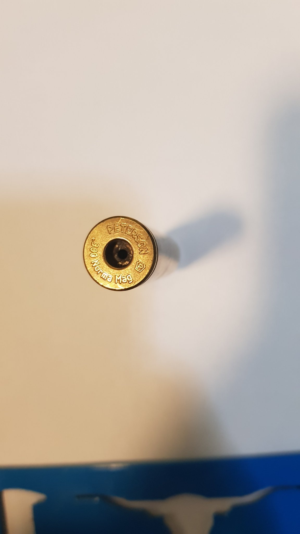

@mtwalsh367 Did you come up with a reason for the pressure signs? Under minimum load? I've just had the same issue with 83 gr Retumbo, Federal 215 primers, 230gr Berger VLD .020" off the lands. I used Peterson brass. Fired one shot at 2808fps and have clearly visible marks from both the ejector and extractor. I'm hesitant to continue with my load development at this point..

I'd have thought. 020" would be an adequate amount of jump. The bullets seemed to feel the same as other cartridges I've loaded for, perhaps a little tighter, ill do some mesuring... The primer remained intact, just a little flat.
I'd have expected to get a much higher velocity seeing as the pressures are high enough to leave an imprint of the bolt face. Could I possibly be on the edge of a secondary explosion effect?
I'll get back to you with that information in the next few days as I'm not near the rifle at the moment. I'm hoping there is no massive difference! Rifle has only just been assembled. I'm not sure if it is related, but subsequent chambered rounds have rub marks on the bearing surface on the ejection port side only. I chambered a round with finger pressure and then closed the bolt on it to eliminate pressure exerted by the ejector pin and extractor claw as potential causes on chambering. It still occurred. This didn't happen on any of the dummy rounds that I made up while finding the lands. Not sure if something may have caused it when I fired the overpressure shot. Any ideas? It may not even be related? Can post a pic if needed.

Not sure if I can find it, but Berger has came out and said this data is not right, too hot. I browsed their website and cannot find a revised version. A call or email to them may yield some better info. I do know going off Quickload for 300 Norma can get you in a bind quickly too.
If it truly is .020” of headspace that will give you your excessive pressure signs and ejector wipes. Or the brass is out of spec....
If you want to be sure find someone with headspace gauges if your Smith is not local.
I’ve had this exact issue with a particular rifle that had a jacked up chamber. Headspace was .020” too long.
Personally, I’d have the chamber fixed by the smith who did the work..... if you trust them to fix it

I contacted the smith and told them about the issue. I've sent the fired case to them as they are not local for their inspection.
Gunsmith got back to me. Peterson brass is .016 short and has the incorrect shoulder angle. Now I need to find a load for some cheep pills to fireform my brass. Any suggestions?
