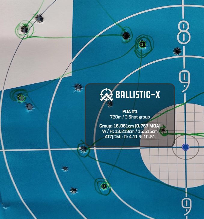

Fire formed today a bunch of remaining Hornady brass. With StaBALL HD 78.8 grain charge. Got good ES/SD less then 30/10 fts.
Still having average if 900 m/s (2952fts) probably gonna keep it as I love the result.
Tuned with barrel tuner the group to get touching group, believe can be tuned even more after fire forming and more effort. 100 meter.
Then went to 720 m (787 yd) range and confirmed the groups on paper, having really stable vertical and horizontal deviations.
( We use bullseye camera to record each shot )
With this results so far, gonna keep this charge just find some brass can handle the load for more cycles.
