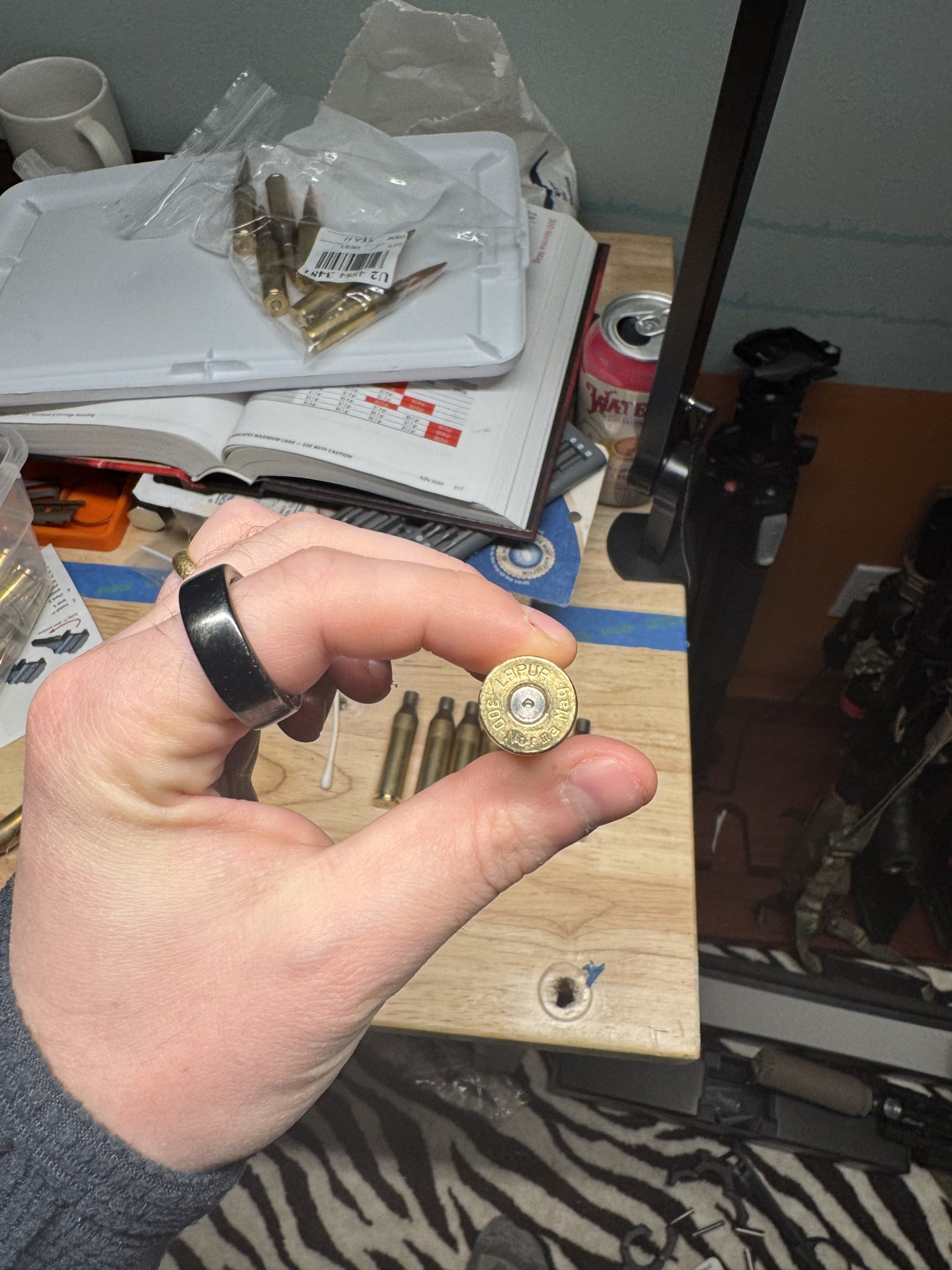

Is berger’s recent data super hot or something? I know their original data was ridiculous. I was inspecting my brass last night in greater detail and noticed this ejector mark. This would have been the 88.0 gr load. Couldn’t see it at the range, only saw the ejector mark under absurdly bright task light and then the brass angled.
I was getting flatter primers at 8% below max, so my assumption is the primers (federal 215m) are just softer.
I will be dropping my charge, but just curious about berger’s data. This is 2.2 gr below their max for the 215 berger, 1 gr above hornady 212 bullet max. However, lapua has a higher case capacity than Hornady and I’m seated longer.
Berger listed a book max with lapua brass and N570 of 90.2gr. Originally several years ago, I know their book max was like 92+ or something wild. Since it was revised downwards, I figured it was more in the ballpark, but maybe it’s still super hot?

Virgin brass, first shots through this barrel. Haven’t run through sizing yet. I’ve never sized lapua brass first firing.
Virgin brass, very common to see ejector shadows from the case expanding to the chamber for first firing. Get everything formed, and that'll not happen anymore. Lapua brass is quite short to the Norma go gauge.

Another datapoint, didn’t see any ejector marks on lower increment powder charges. My BR was super easy to load for, this is the first magnum I’m loading.

Are you getting any bolt lift or any other traditional psi sign? How much is the shoulder moving forward from virgin to once fired? If the shoulder is moving a lot, that'll cause the ejector mark and flat-ish primers. Size 5 cases 002 bump(if it's needed) maybe less. And go shoot them same charge weight. If it has pressure, back it off. Let the rifle tell you. Lapua 300 norma brass is tough shit, reading the case head is prob a bit too late and pressures are already very high by that point.

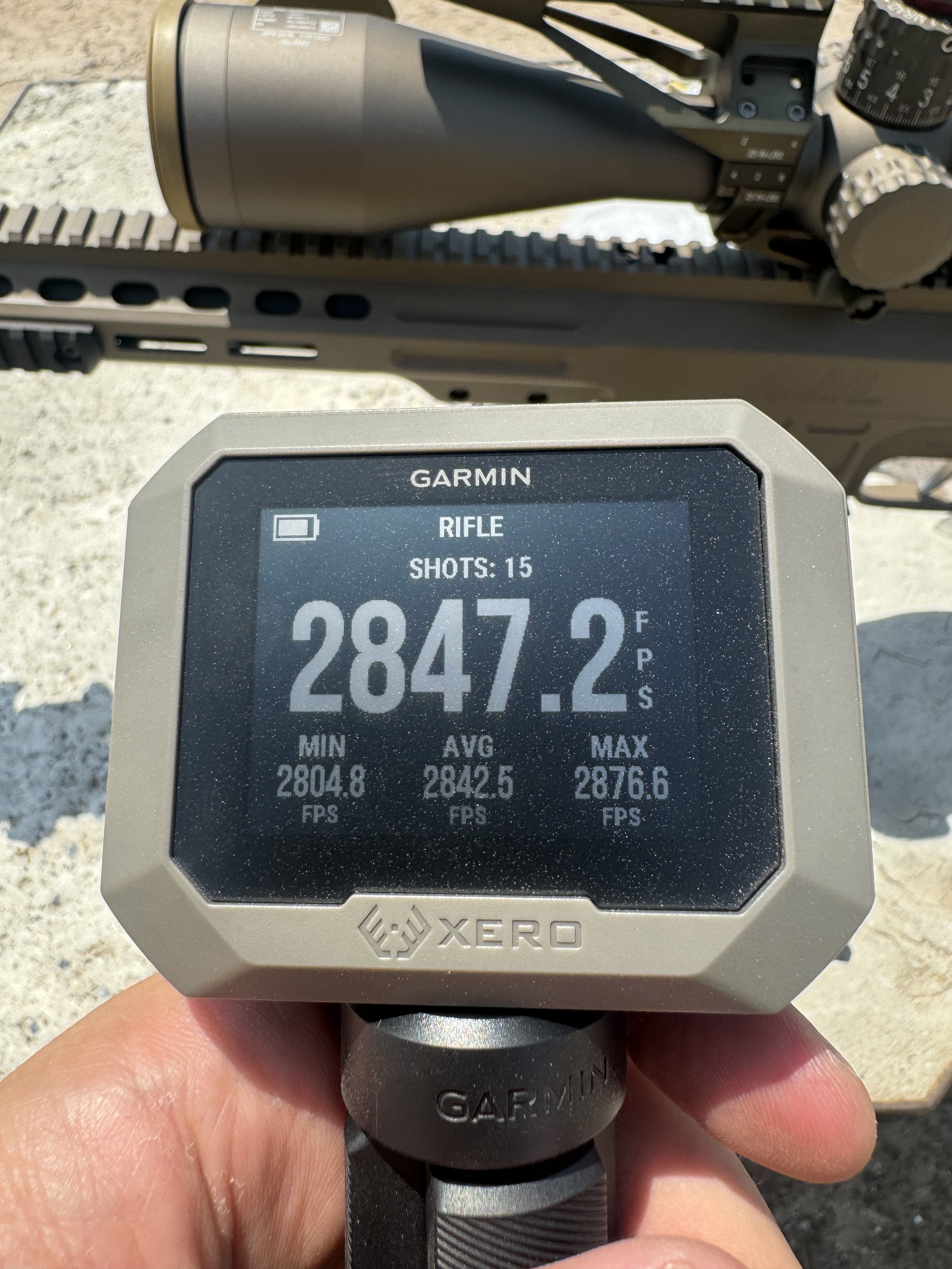

Anyone on here shoot any 300 Norma factory ammo? I just got the same MRAD and got this for MV on the first range outing with 230 grain Norma Golden Target factory ammo. Seems slow to me, I know the barrel is new but still
Reactions: Balor
That's about what I've seen in my rifles (not an MRAD). Between 2850 to 2900 fps.
