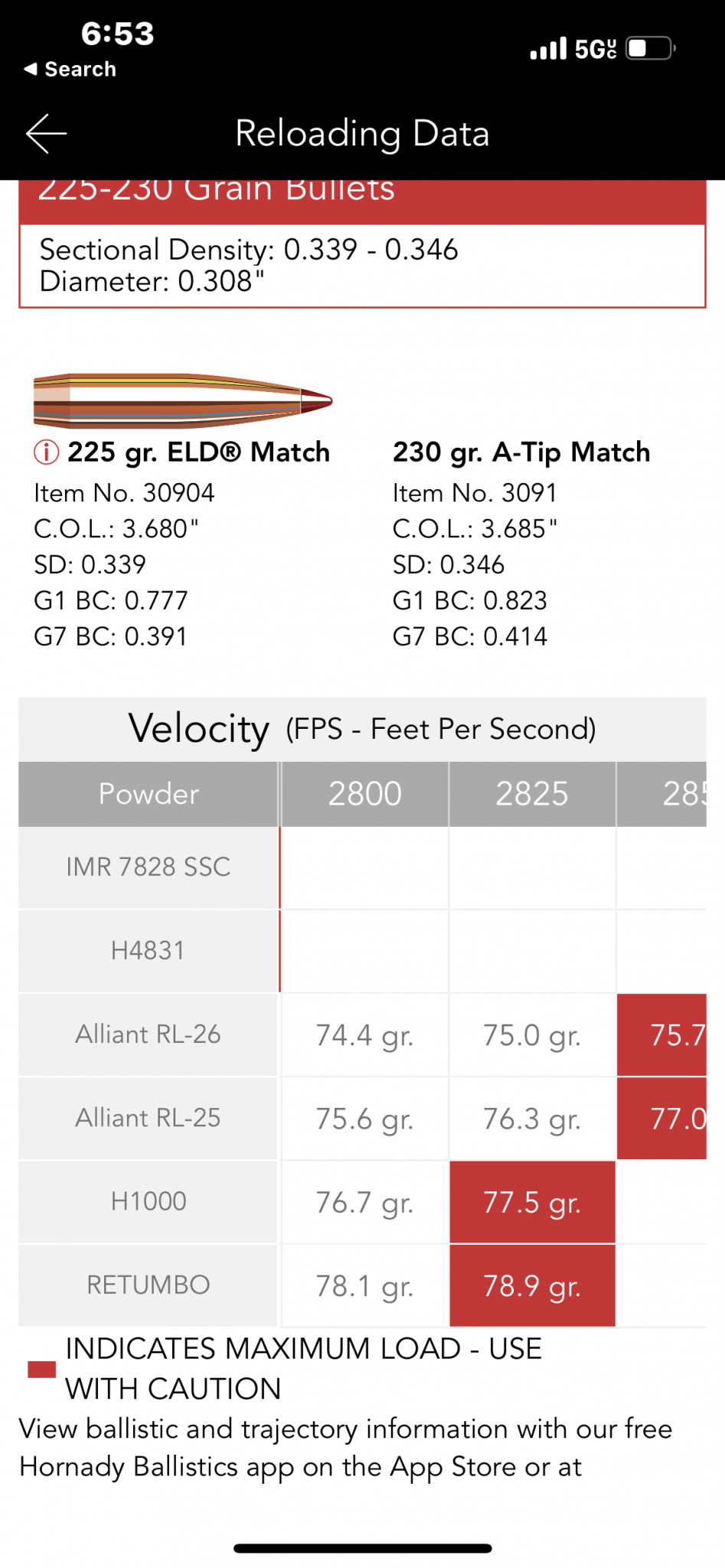

I trued the h2o capacity to the average 95.42 in the app and played with the burn rate to match the velocity
Hornady book states the 78.9grs as the max charge, hodgdon is much lower then,
