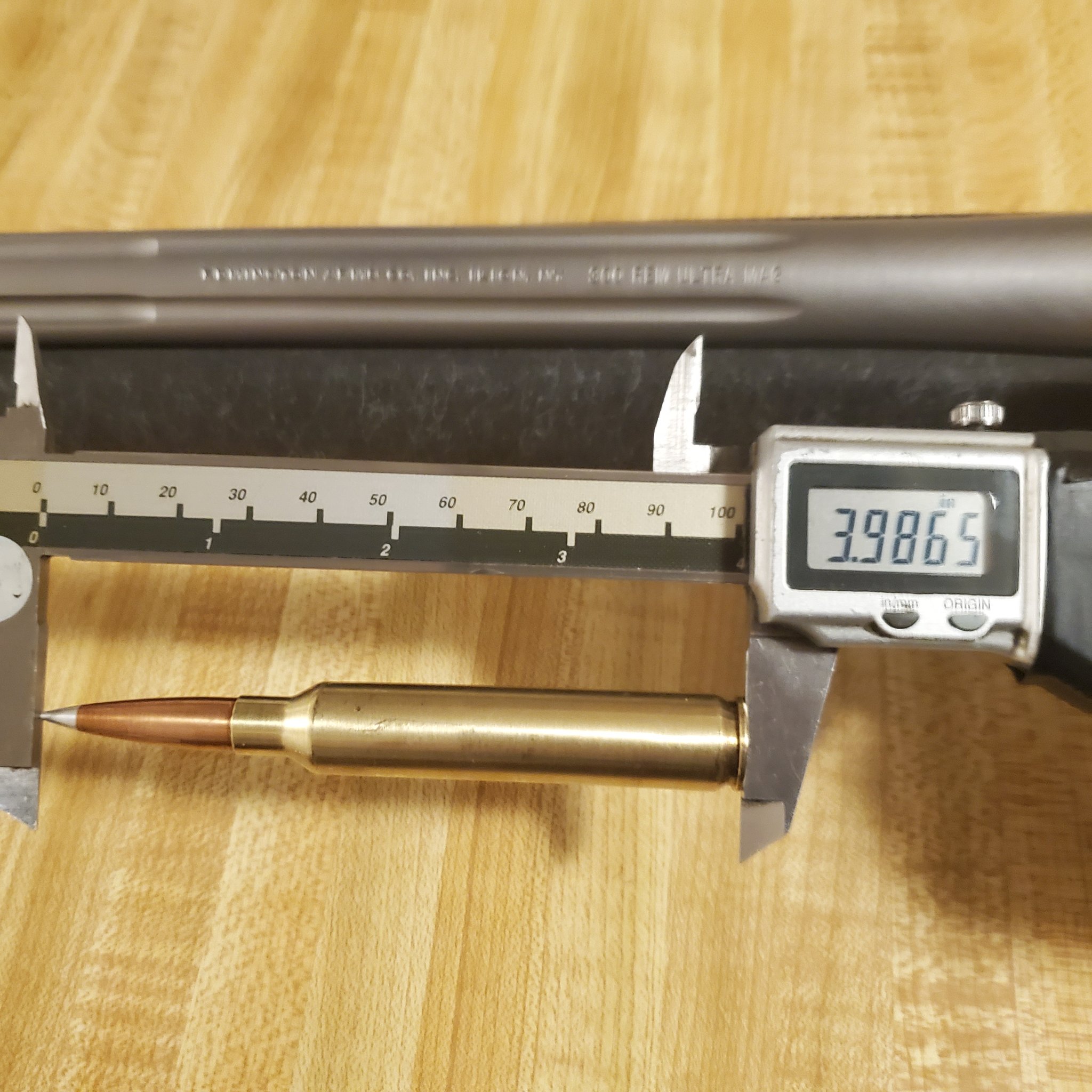

    Here is my factory Rem Sendaro, I milled the reciever and bolt stop.
    Complete with altered 4.020" magazine to run 250 gr Atips with 101 grs of powder at 2985 fps in the factory 26" barrel...

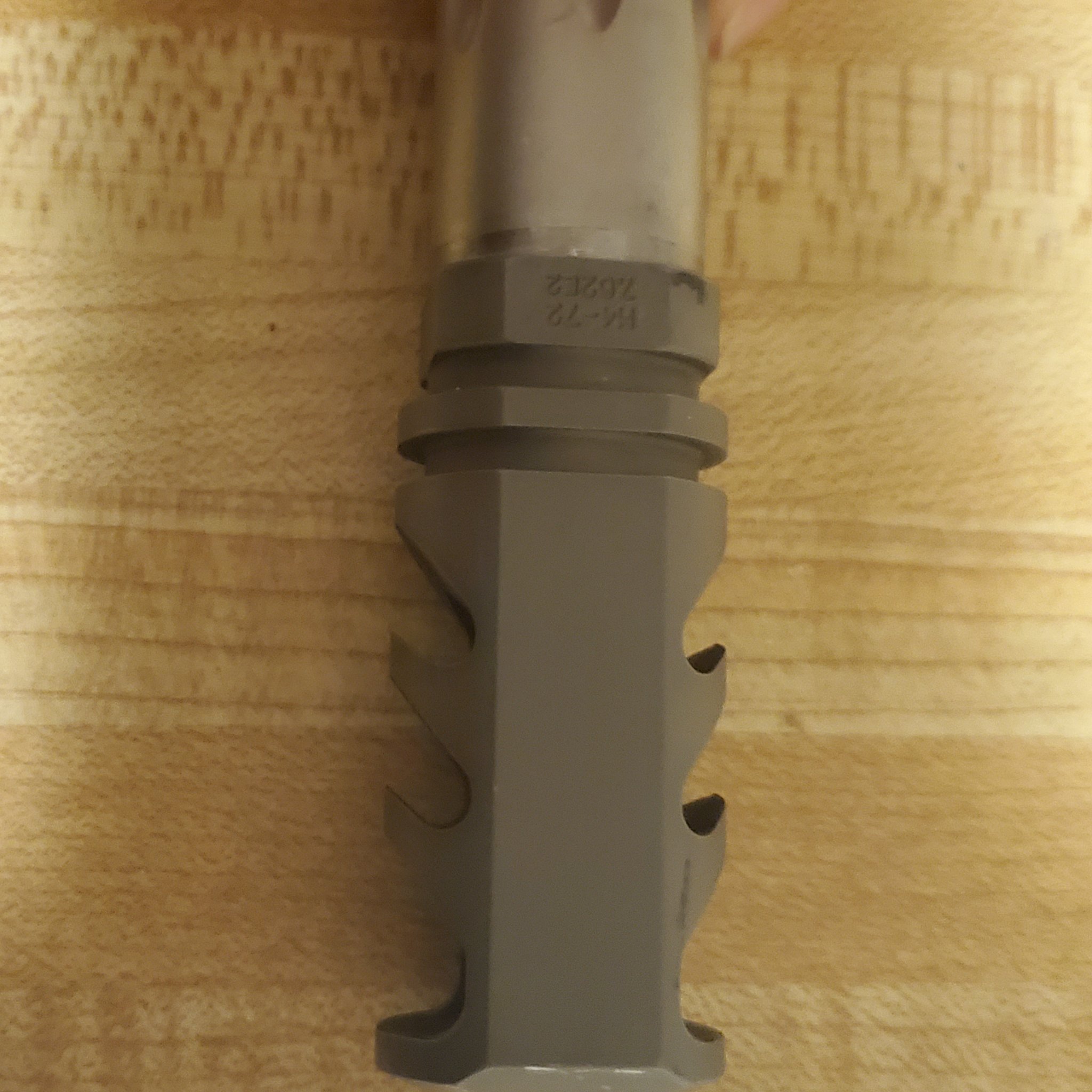

    I also threaded the barrel for a muzzle brake, that allows one to shoot alot of rounds in complete comfort from the prone...it does push a blast back at the shooter, but that can be ignored after a few rounds, with a huge reduction in recoil. It's a Precision Armament M4-72.

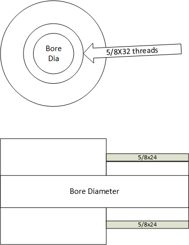

    Really, cause the female end gets thicker to create a larger shoulder. Not that hard really, but for you probably impossible to understand. But they picked an easier/better solution. Now go back into your cave!
    You can’t cover a 5/8 diameter with a 5/8 diameter. Draw it out. Show your work.
    Not exactly what you two are discussing but a course thread can be cut (lathe) over a fine thread of the same diameter. The major diameter remains, it's the increased depth of the minor diameter that makes it workable. It's not the picture perfect, shiny, smooth thread that gets the oohs and ahhs but it can work, and it's not bad. A quick glance won't see a difference. The further apart the pitch the better it works.

    I can see it in my head, and I can draw it to see it with my eyes. There’s no need to waste machining time and material. It would work better than trying to make a female/male adapter of identical diameters though.
    What does that even mean? “A very large second diameter”. 5/8 is 5/8 is 5/8. What is this “second diameter you’ve referred to?
    You can’t have a male 5/8 diameter and a female 5/8 diameter occupy the same space, without having nothing there at all. There’s no material left.
