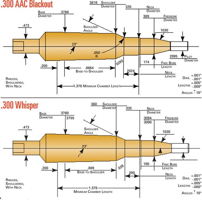

    Can't seem to locate a print online anywhere- I thought it was CIP but I don't see it there.
    Customer sent a Savage barrel in .300 Whisper to be rechambered to Blackout, need to figure out how easily this cleans up.

    It's not hard to rechamber. Screw the barrel in an extra 40 thou / 1mm, chamber and headspace. Good to go (from memory, triple check the print above, but basically one barrel turn will do it.)
    Thanks, I'll check this out.
    If I deepening .04 or so, I'd need to face the breech that amount (presumably) to get the .125 or so case head protrusion.
