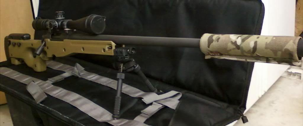

Well I got the 300whisper together her are some pics. I put it in my other AICS because I wanted to try out the AI223 mags for feeding issues before I got a bottom metal. They feed like a dream and now I need to order a CDi bottom metal for my B&C stock.
Rem 700 trued
Weaver 3-10x Mil/Mil scope
EGW 30moa base with TPS rings
Douglas 1-7 twist SS 16in barrel
Worked factory trigger
threaded 5/8x24 with cap for Cyclone
working on loads for 220SMK,240SMK and 208Amax

Re: 300 whisper finished and updated Roscoe 260 pics
The whisper action was donated from a 17 fireball so extraction is greatly improved over a 223 action and with the AI mags it feeds great
Very sharp! Question: I'm looking at building a bolt gun for .300 whisper and would like to use a 700 action, but have heard they have trouble ejecting. Did you run into this issue? Am also looking at a Howa action but I'm still several months out from starting.
If you do build one on a 700 be sure to get a fireball action mine was from a 17fireball. The extractor is a little diffrent than a normal .223 boltface action and helps a ton with extraction issues. I was having problems with feeding and wanted to try the AI mags instead of the floor plate setup I was running and I have not had a FTF problem yet.
I only put it in the AICS to test the feeding of the mags. I have a light weight B&C medalist for it to go in but I wanted to test the mags before I got a bottom metal now its time to place an order with CDi. On another note you would be suprised how well the AICS balances with the 16in barrel.
I will leave it that way for now I still need to order the bottom metal, bed it in, cerakote the barrled action and do some texture work on the BC.
