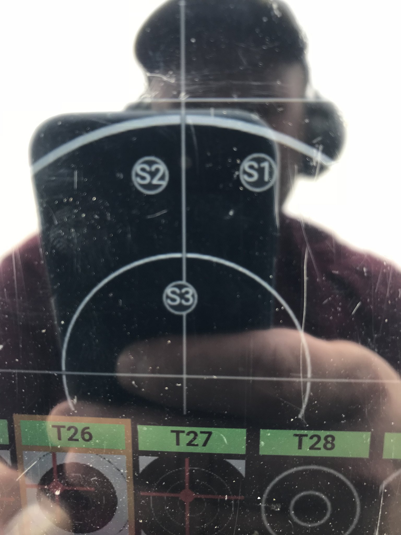

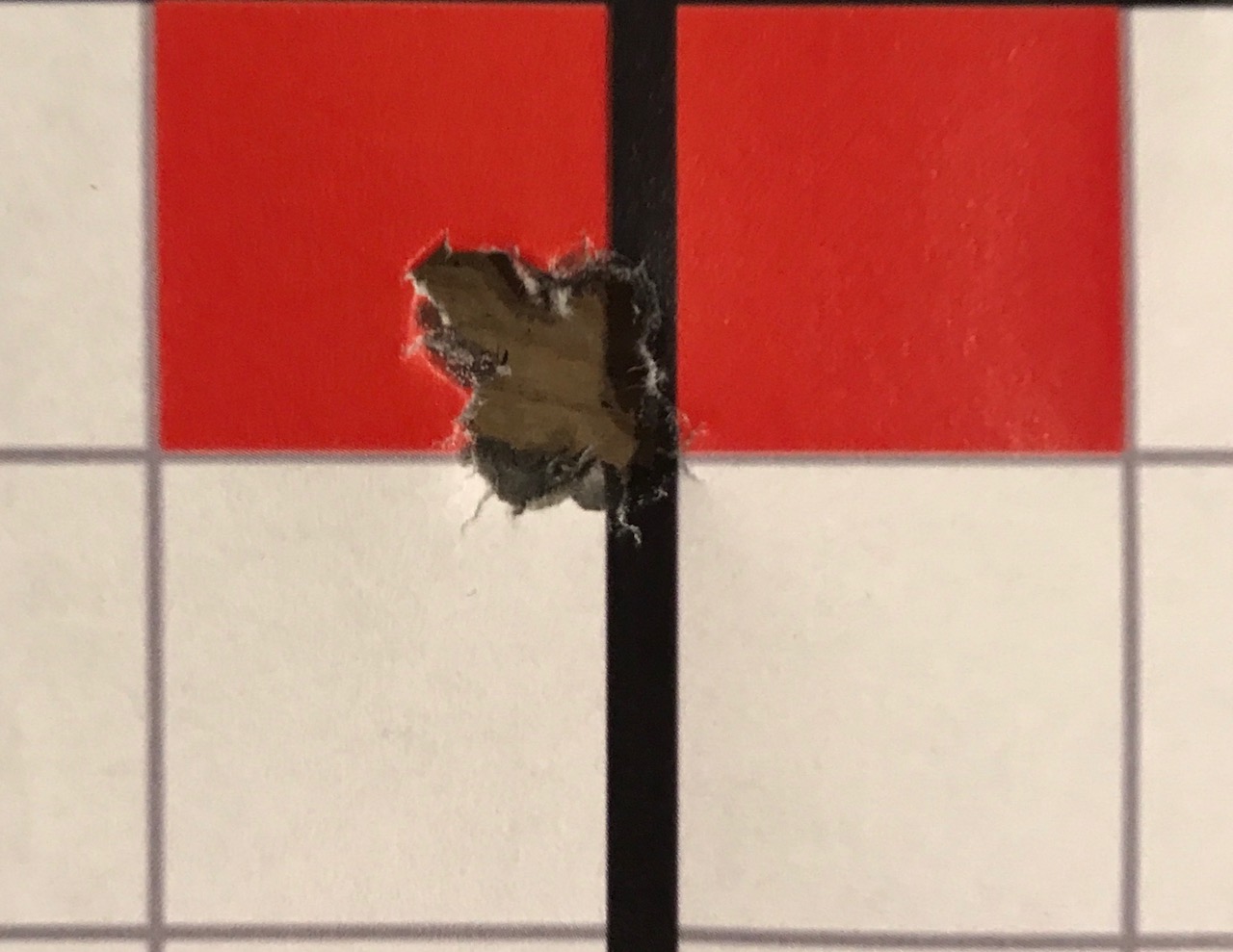

5rds, .31 MOA at 100 yds:
I just need to try it through some fire-formed brass and at distance.

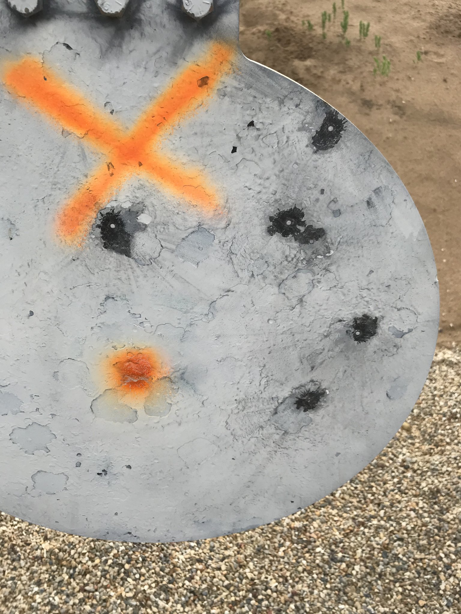

Hornady 225 ELDM at 1160. The bottom impact was from a 6.5 creedmoor. The five impacts just above that are the 225s. That is about 7 inch vertical. I put my 1200 zero on then come down 2 mins. Perfect wind call but just over. Came down another one and half mins. Then went 5 for 5. This bullet flat out shoots.

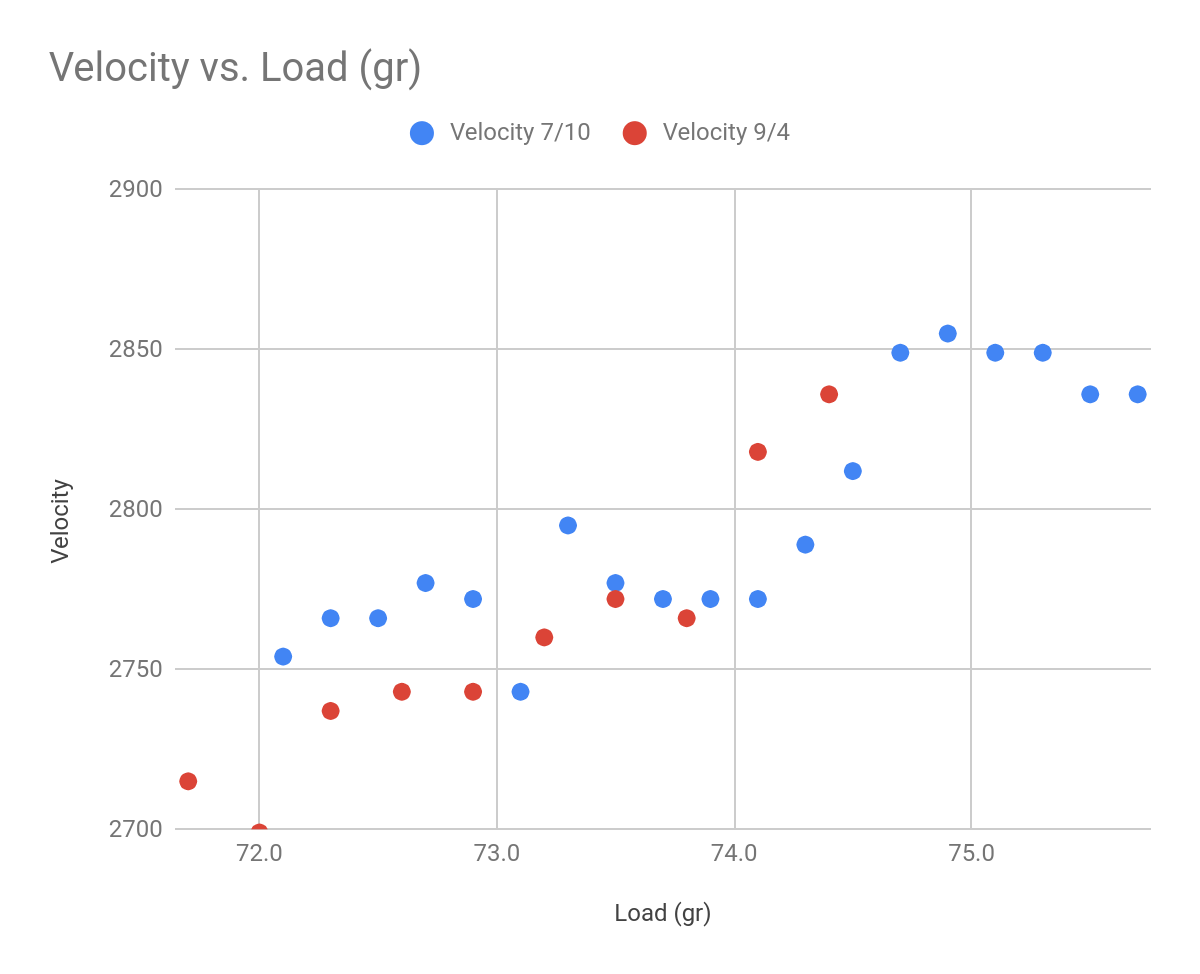

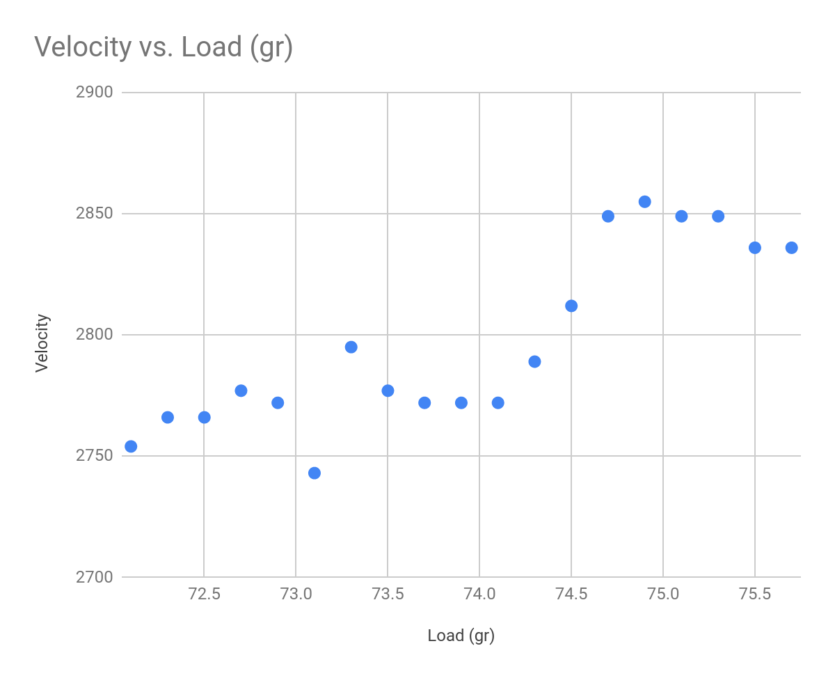

Charge and velocity table below. My bolt started to get sticky above 74.7 grains. FWIW, I tend to favor lower velocity nodes to (hopefully) extend brass/barrel life, so going to load several at 73.7 grains and see how they group.
Not sure if I jacked something up on 73.1 and 73.3 grains, could be my brass I suppose...
7116426
72.1
2754
72.32766
72.52766
72.72777
72.92772
73.12743
73.32795
73.52777
73.72772
73.92772
74.12772
74.32789
74.52812
74.72849
74.92855
75.12849
75.32849
75.52836
75.72836

I added some more data points to the chart I posted above, FWIW. Atmospherics were almost identical on both shoots. Maybe it will be useful to someone out there...
