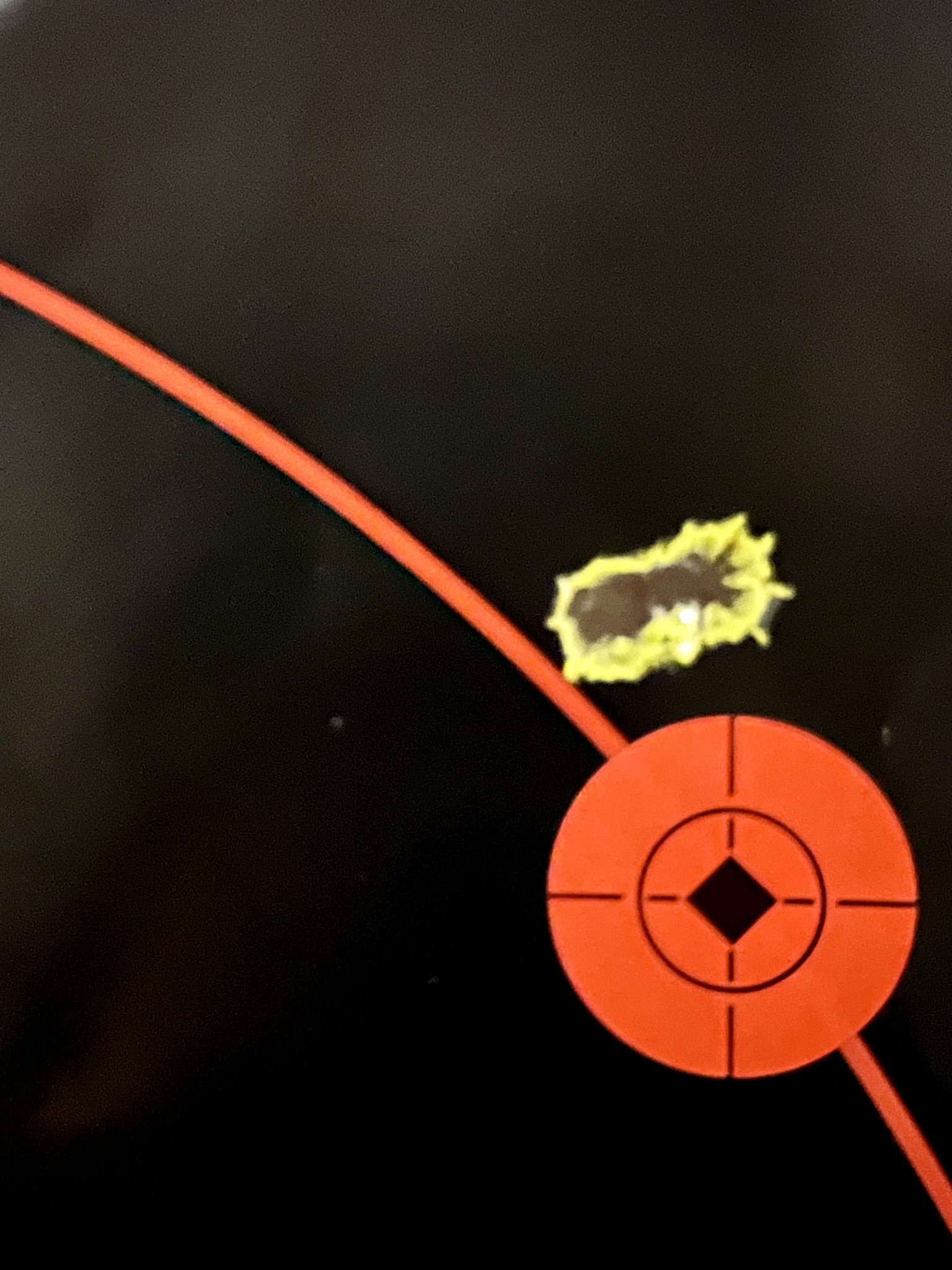

Results with 212 Seneca and 4000MR in a 28” 7 twist 300 WSM (not the ideal powder, good speed, similar to RL-26, but a little temp sensitive):
Hard bolt lift at 2910 fps. Brass had an ejector mark and primer pocket opened up 1.0 thou.
Higher node at 2870 fps. Mid sixties powder charge. Node was 1.0 wide. Brass is ok but expected life would be below 10 reloads.
Lower node at 2750 fps. Lower sixties in terms of powder charge. Node was also about 1.0 gn wide. Long brass life, but giving up some performance.

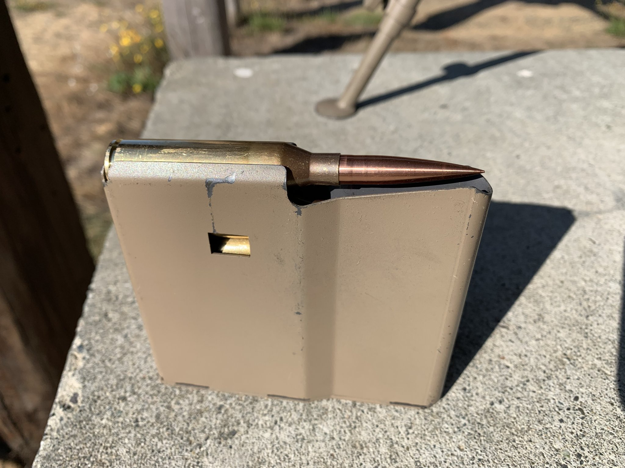

300 PRC question: Has anybody managed to chamber a short action rifle in 300 PRC??
I realize the loaded round will be super long with a 241 Seneca bullet, but if i removed the ejector pin, and removed the bolt every time to load a new round, what would stop that from working reliably?
Yes not very practical, but just curious if that can be made to work! It is a short action switch lug rifle.

Yes you can do that I don't see anything bad about it. But why? What are your velocities with the 300 wsm?
I load in 4.28 long 338 edge in a short action Nuke
I just single feed it like normal
Drop the mag and push it out of the bolt head if need to unload a chambered round.

Got the opportunity to shoot the 212 Seneca / Norma / 4000MR load at 1000 yards in the mountains of West Texas. Great fun and accurate at 500, and we destroyed quite a few rocks. BC held up well, but my Labradar quite on me, so not in a position to do any truing yet.
It was a hot day (80 F) and the load was developed when ambient was between 40 and 60 F, and 4000MR is perhaps a little too temp sensitive, but it produces a lot of speed, similar to RL-26.

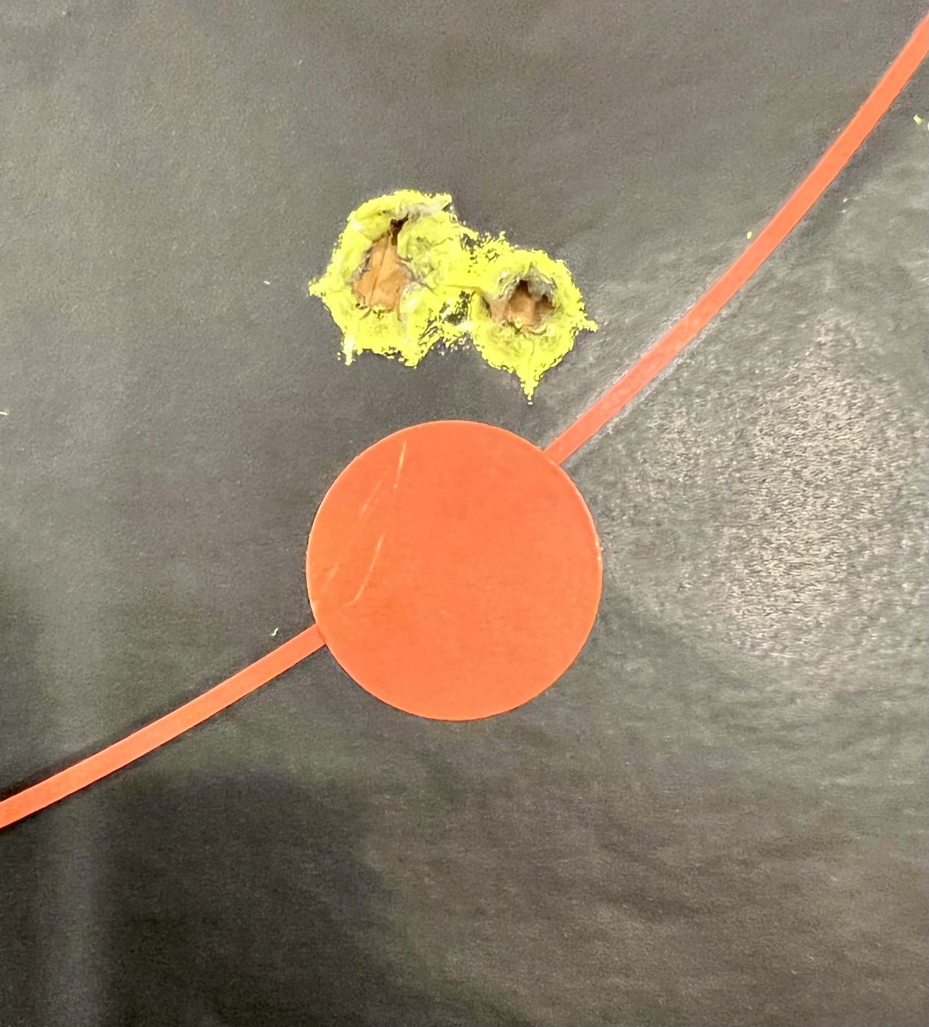

Shot the 212 Seneca out to 1000 yards this past weekend in the Texas Hill Country (mostly limestone rocks). Actual weight range is 210.6 +- 0.3 gn. That stratospheric 0.95 G1 BC seems to hold up: Rezeroed at 100, then shot at rock faces on the mountain at 355, 507 and 998 yards. All high angle shots. Distances were ranged with the Sig Kilo 2400. It shot a little high at 500 (0.5 MOA), and maybe one MOA low at 1000.
But sadly i could not measure speed, as my Labradar has a problem due to a flaky female power socket. So not enough data to do any truing, but based on speed from a week ago (when it was 15 degrees cooler), it seems the published BC is pretty close. [Btw: I used the G7 BC to calculate the scope adjustment, as it is more accurate.]
My forced choice of powder (4000MR) is problematic, too temp sensitive, and it is probably pushing me out of the node when it gets hot outside. [Might have to do a winter and summer load.]
Accuracy was OK at 350 and 500, but not great at 1000. I suspect the ES went way up when the speed moved up (and got outside the node/speed flat spot).
I did not see a repeat of the 0.2 MOA groups posted above at 100, more like 0.8 MOA, another sign that ambient temp pushed me out of that beautiful node.
Now busy trying out plain long kernel H4831 (not the SC version) with the ADG brass. Max speed is slower than 4000MR, probably by 80-90 fps, but the new ADG brass is very resilient (and case capacity is higher), and should help me recover much of that speed loss. H1000 would likely do better, but just cannot find it.

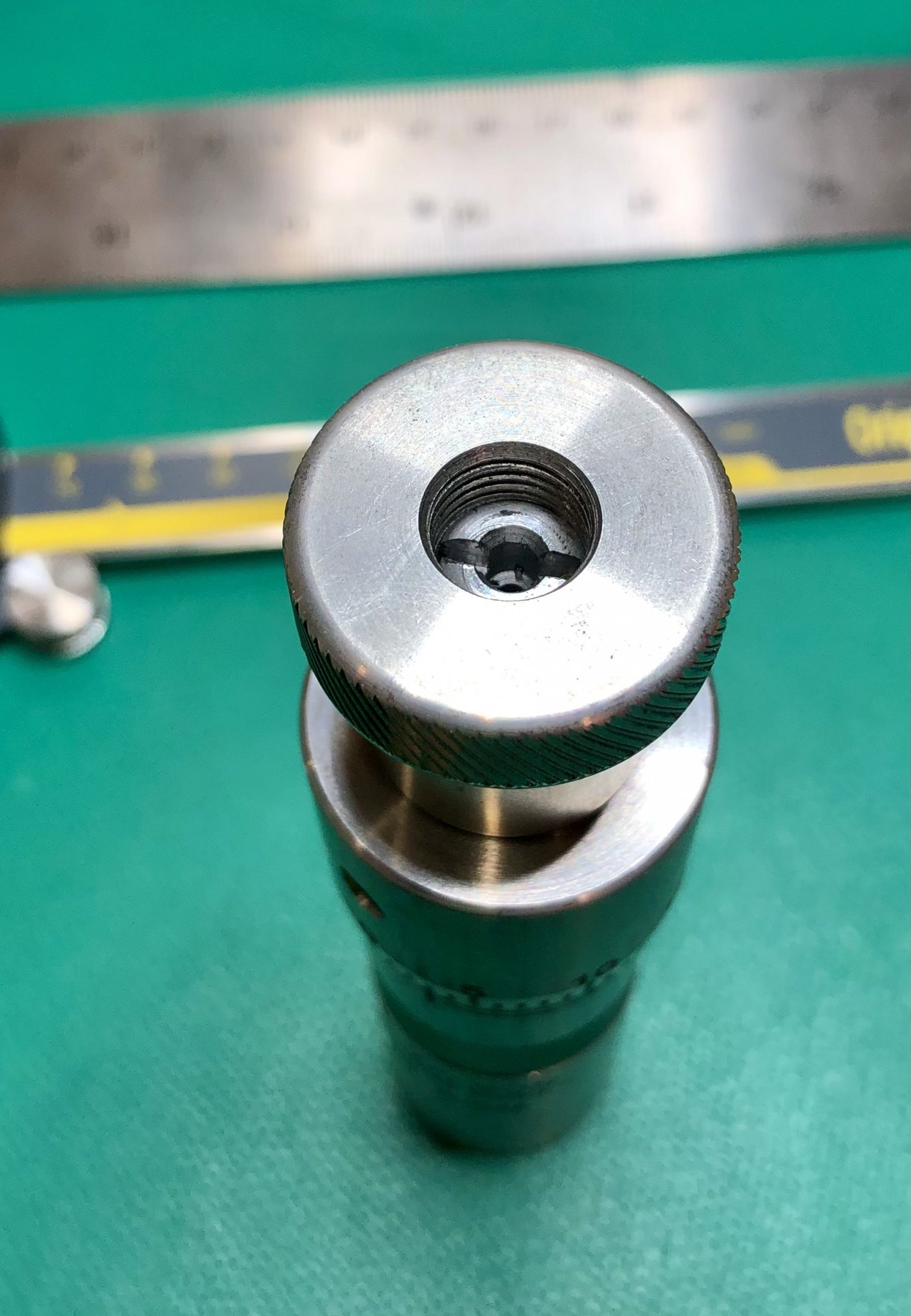

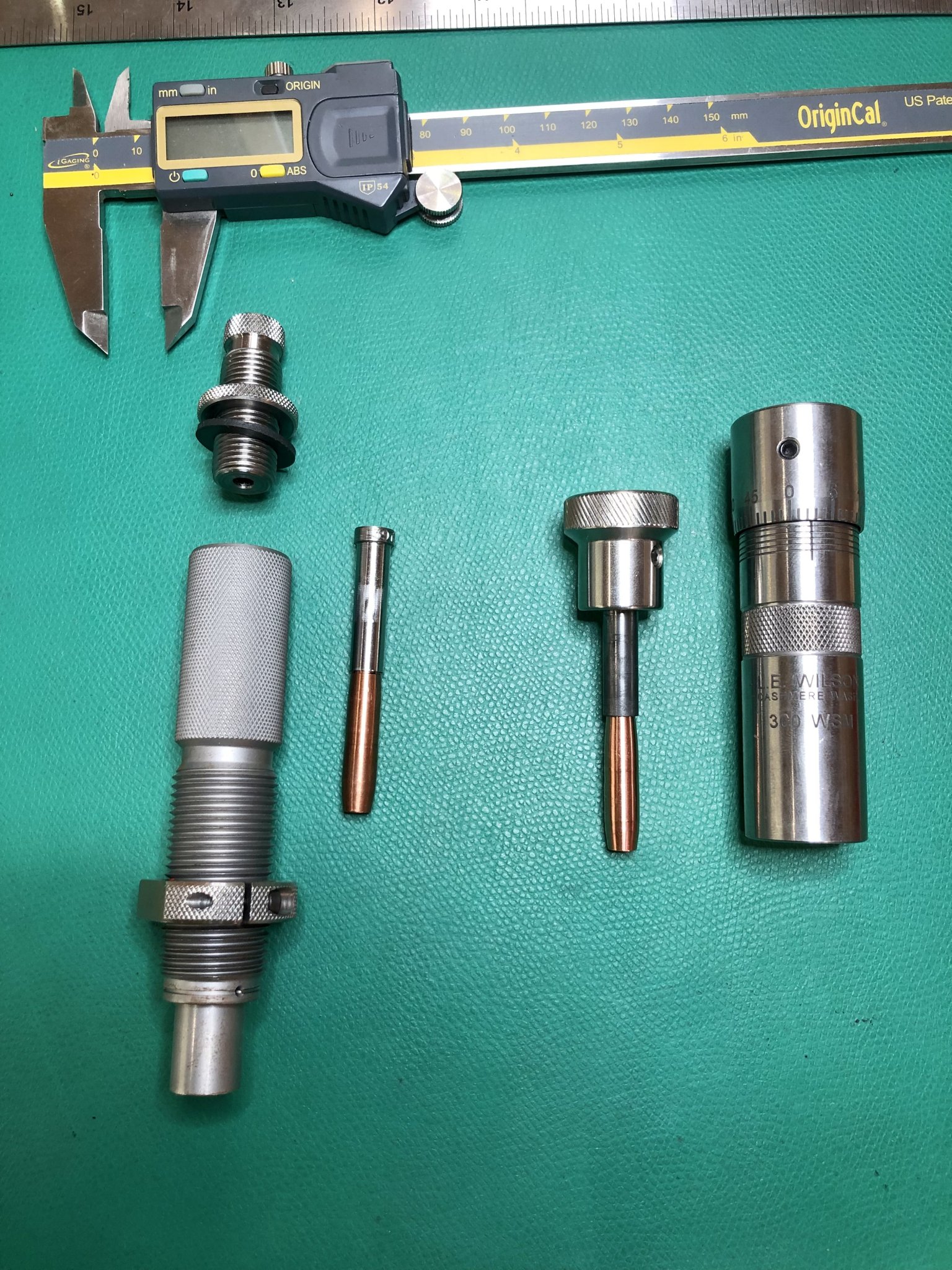

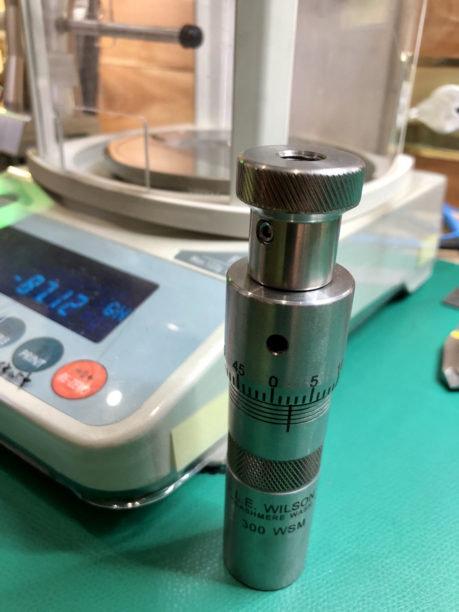

I've got a normal 0.250" freebore on my current .300NM barrel, so I'm jumping them 0.1", which seems nuts, but they're grouping very nicely as long as I load them with tight necks.
Getting ready to test some in my 300NM, but in my AXMC w/AI barrel it's closer to .160 jump. They are so pointy I need to make a special adapter to measure to the ogive. Hopefully they shoot well, will be amazing around 3200 fps.
They’re consistent enough that you can just measure COAL instead of base to ogive. They’re so slender and pointy that they can handle shorter freebore than jacketed bullets.
This would be true if they were shipped in better packing. The ones I’ve used ranged .005” because the tips get beat up so bad. Shipping in a plastic bag that gets tossed around by usps like a hacky sack.
They are very pointy and those tips are fragile. Mail your self a bag and see for your self.

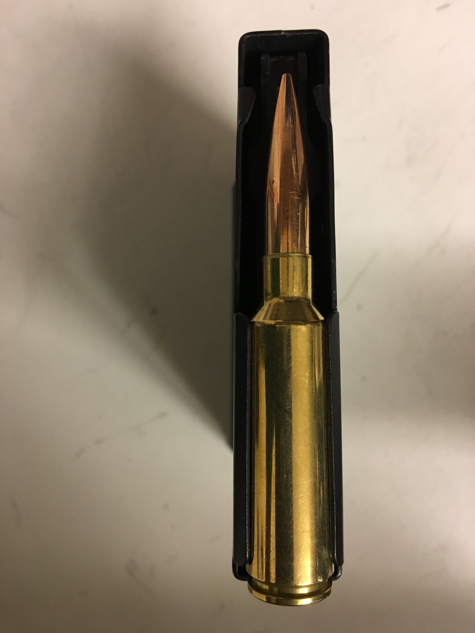

Ended up jumping about .200 to fit in my mag. They didn't like that at all, about an moa was best group with N570 from 2960-3175fps. Don't really like to single feed but might try them @ .020 for local 1000yd f class like comp just to use them up. Got about 80 left.
