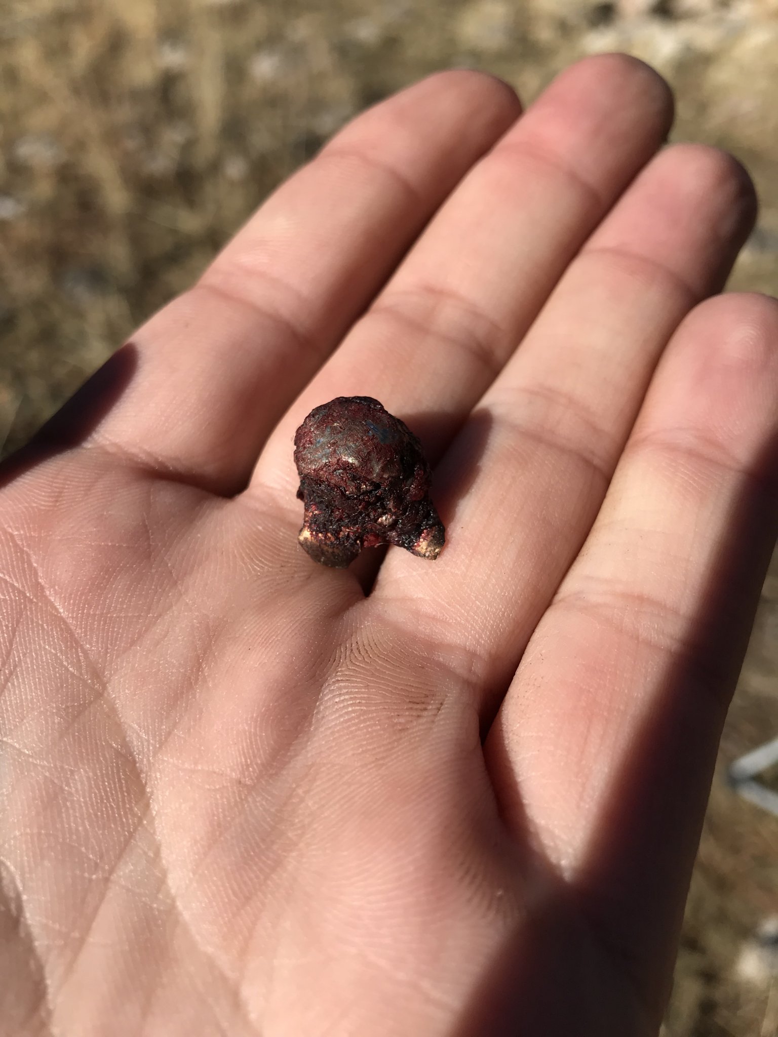

Should definitely be enough for elk. Took 2 big bodied mule deer with it last season. One at 510yds and the other at 260yds. Bullet performed well on both.

The 185vld was a complete pass thru on the buck at 510yd but I was able to recover the one in the offside hide of the buck shot at 260yds, hit more bone. Here’s what was left
