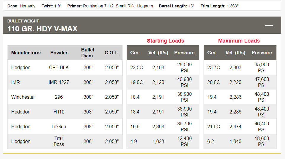

    What powder combo does one need to look at for decent velocity out of a 300blk? Goal is 2000-2100fps with a 110gr Vmax out of an 8.3" barrel suppressed. I was thinking along the line of conventional powders i'd use for other rounds that give a solid velocity bump like 8208 and 2000mr but i'm not quite sure the burn rate will be fast enough in that short of a barrel.
    Hmmm thats a pretty high speed goal for a 8" barrel. I would have suggested CFE BLK right off the bat for a blackout but I think you might get topped out on speed at about 1900 fps with it. Make it a 16" and you would hit your speed goal no problem. I dont think the more conventional rifle powders would do what you want fast enough with a pipe that short.
    Hodgdons site makes it look like lil gun may be your best bet to make your speed htough I would have guessed H110 off the top of my head. A 16" barrel used so a bit of adjustment is necessary but its the only thing producing more speed than cfe blk.

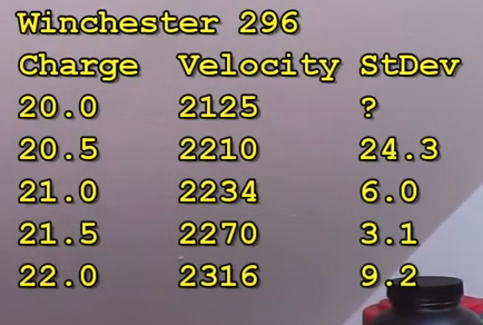

    Are you looking at the Johnnys reloading bench videos on you tube?
    In this the lilgun looks to be nerfed by the short barrel in comparison to the H100/W296
    In this one her gets some more velocity data and says that the H110/W296 brass looks totally fine
    I use W296 in the BLK with good results. I don't shoot the 110 VMax, but shoot the TAC-TX Barnes and have loaded 125s and 130s with the 296 to mid 2100s with a 10.3" barrel.
    I use h110 with the 110gr vmax in my 300blk sbr. Its got a 8.2” noveske with a thunderbeast ultra 7 on the end. With 18.2gr im getting 1970ish.... it could be pushed harder but its accurate and im not shooting 1000 yards with this gun.

    Good afternoon 5RWill,
    For my 9" Ballistic Advantage barrel I am using 19.5g of H110 for about 2050fps with a Barnes 110gr TAC-TX. This was worked up slowly and shows no pressure signs in my gun. Burns clean, but quite a bit of face gas when suppressed which is not a deal breaker for me since it is a hunting only round and not for volume shooting or plinking because those dang bullets are expensive. Using standard gas block, pistol length gas, standard BCG, carbine buffer and spring. Runs reliably with no problems. I am 100% sure the face gas would be fixed with an adjustable gas block but I don't feel like screwing around with that when it works just fine the way it is with subs and supers.
