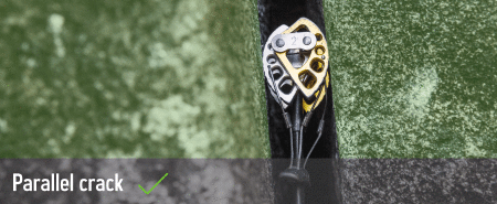

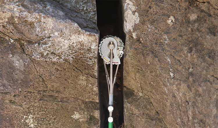

    I'm going to take a stab at this...
    First, tougher brass does NOT change what the bolt face/lugs sees pressure wise. It masks the signs of pressure we are using to know when we are approaching (or more likely past) limits. Tougher brass doesn't flow as easily as softer so the signs occur at a higher pressure. That is why I used the Sig Fury example with the hybrid case design intended for higher design pressure. "I think" that we can get close to that performance using ADG/Alpha brass, etc. The rifle still sees the pressure though so just like an action for that Fury round needs to be able to handle 80K, so would this example.
    As to the straighter walls having less bolt thrust force. Have you ever wedged between two walls, say a stairwell or hallway, back to one wall and feet to the other? You can support your weight with the force applied to the two vertical surfaces. Same idea with the straighter cartridge walls but the forces are much higher than a 200lb man/woman/? Another example is the cams rock climbers use to ascend. Maybe others have some examples.

    View attachment 7832343View attachment 7832369
    I stopped rock climbing a few years before cams hit the market. I was using Chouinard nuts - I still have some and some blades and bongs, some of those postage stamp pitons, and similar stuff. I was more into ice, rigid boots and crampons, and Salawa ice screws. I am very familiar with wedging up a chimney but I don't think it applies.
    I think your concept is that pushing your feet against the side walls is pressure that locks the brass into position and the brass tensile strength restrains the brass at the base and this reduces the pressure on the cartridge base. But does it? Compared to barrel and receiver steel, cartridge brass is soft and has a yield strength one third of steel.
    If you shoot a piece of brass many times you will see the shiny ring of incipient case head separation or, perhaps, a partial or full head separation. What is happening? The barrel is screwed into the receiver. The pressure inside the chamber holds the the upper part of the case against the case walls - unless, as Mr. Green says, there is some incompressible liquid in there. The same pressure pushes the case base against the bolt face and the bolt head lugs push against the receiver lugs. And the pressure against the shoulder pushes the other way. When the round fires those expanding forces elastically stretch the receiver a little, the chamber gets bigger, and the brass stretches just a little just above the case base. When the pressure drops the receiver elastically pops back into its original dimension forcing the brass back together. The receive and barrel steel return to their original dimension because their deformation was elastic. But the brass does not return to its original shape because the brass is less elastic than steel - I think because it has lower yield strength.
    I don't have a mental picture of what happens to make that shiny ring. I keep thinking about a 16 ounce water bottle when you squeeze it along its long axis - one hand on the base and one on the cap, now push your hands together. It sort of collapses like a accordion. I'm thinking that something like happens to the brass after the stretch induced by firing.
