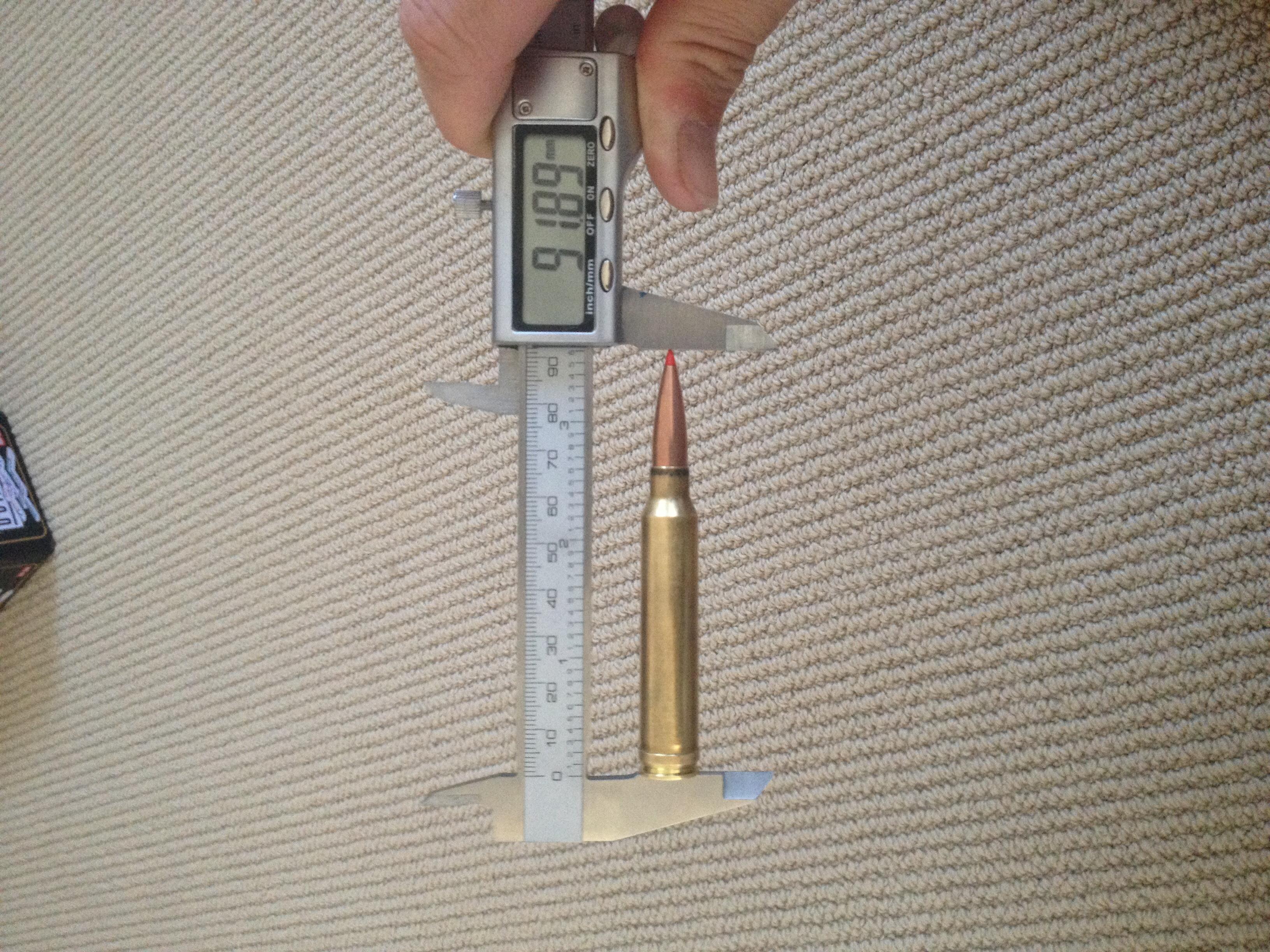

Hey guys, I've read various other thread on this and they just get all jumbled up and the answer is lost in the heat haze.
I've bought myself so 208gr amax projectiles for my 300 Win Mag and was just test fitting the round into a case and noticed it was heaps longer then the 180gr rem corelokt factory rounds, also it is longer then what I found wiki said the length to be. I seated the projectile all the way down and still longer. Is this normal or am I doing something wrong?

Correct. COAL, Cartridge overall length, from base to the tip. You may do COAL of Spec + 0.015" and load for a go-check rd. And your loads has +0.010" over spec. Wait form 2nd Opinion as more gun builders experts are here to help.

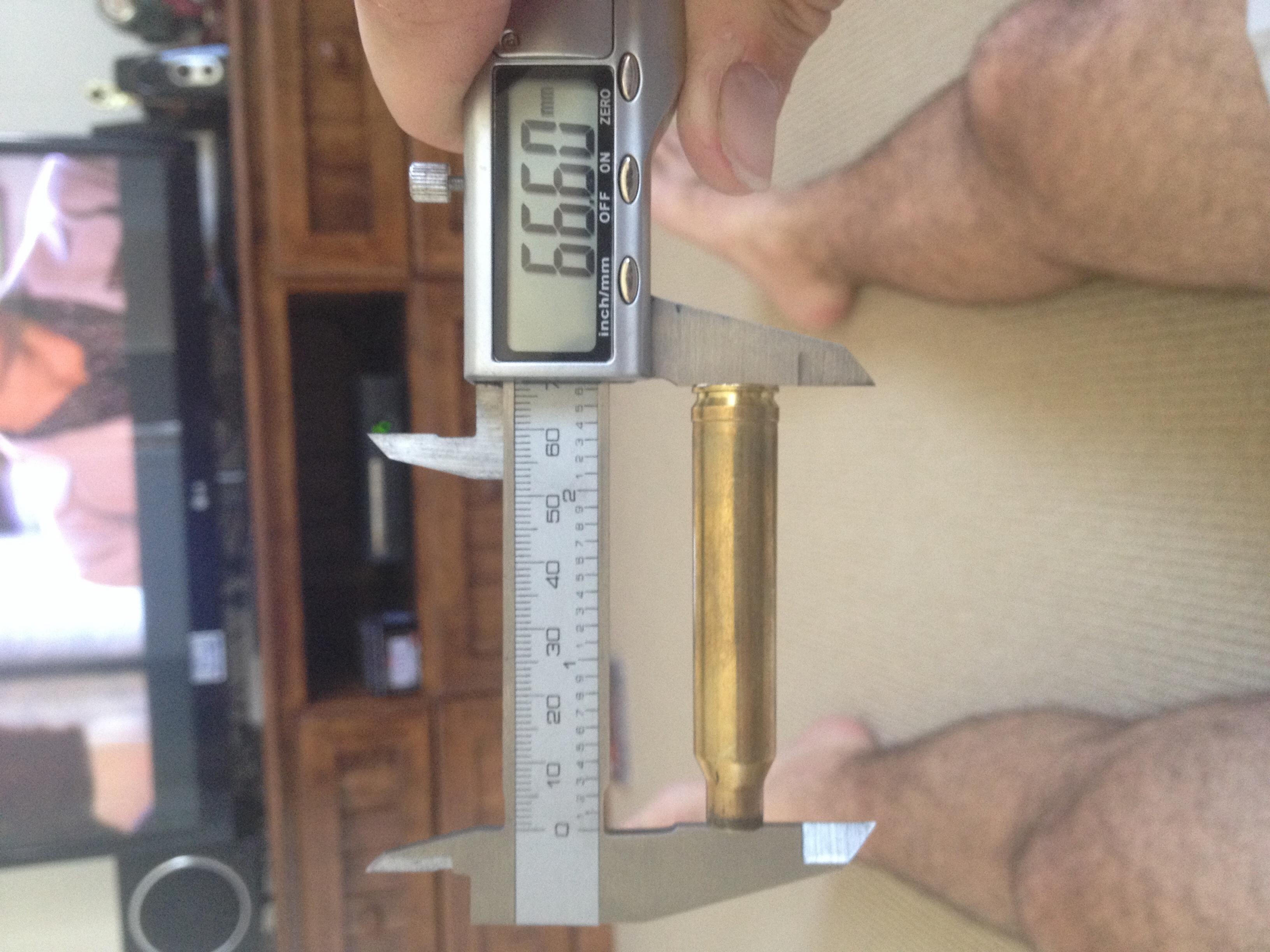

From just looking at it compared to a factory corelokt round it will be approx the red tip longer if seated at max depth. This is using a fire formed case. Once my bench is finished being made I'll use a full resize and see if it makes much of a difference but the fire formed case is 66.55mm (2.620") long which is the spec wiki gives.

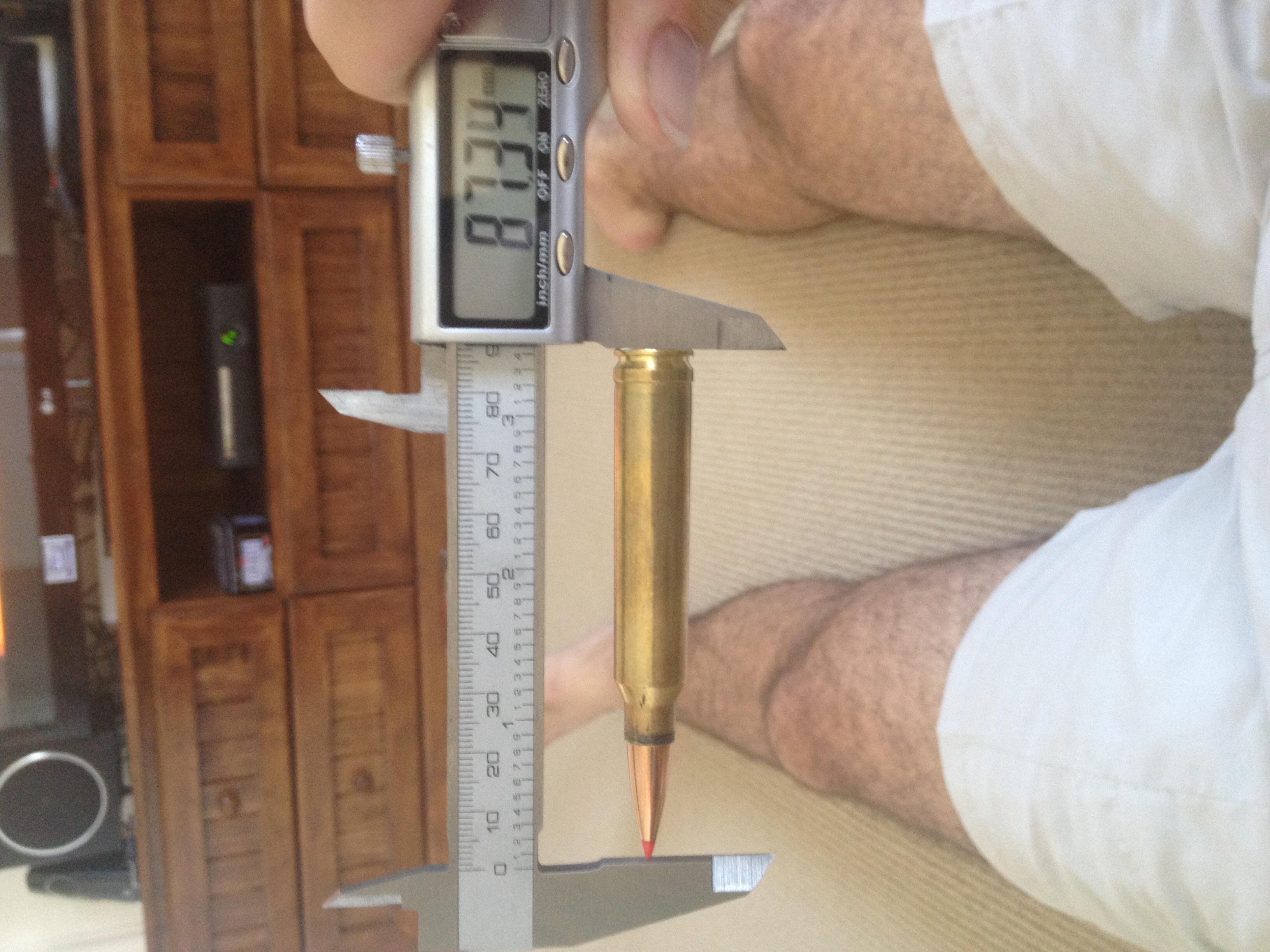

Ok guys, I've done some measuring with the fire formed cases just to show their length and length with projectile fully seated to the point any further it will fall into the case. See photo with micrometer attached
Looking at the picture, it looks as the bullet is seated much deeper than most long range precision shooter load the 208-AMax. Since you're running metric, I can't easily tell where you're at compared to what I'm loading. But if you want to do the math, I'm loading 3.59 to 3.60 inches COAL, that's where my rifle likes them. Now if you have a hunting rifle with short throat, then obviously you will need to run them shorter.

That projo looks sunk in there a bit far. Trim should be 66.40 ish mm, COAL of 86.85, my AI 300 wm magazine is 92.63 MM, these are all within a few tents of a MM as I dont normally use this metric.
I just measured a new FGMM case it is 66.36 mm.

COL is Cartridge Overall Length. You measured it correctly in your picture. I shoot a heavier bullet than the 208 Amax. My COL is 3.460 inches or 87.88 mm. The nominal case length is 2.610 inches to 2.615 inches or 66.29 mm to 66.42 mm.
Based on your bullet and case dimensions, your COL should be at least, 3.387 and no longer than 3.688. Please allow me to explain. The 300 Win Mag has a very short neck. Your bullet has three sections: the tapered boat tail, the straight shank, and the pointy nose part. You want to seat the bullet so that the short neck bears only on the shank, the boat tail doesn't go part way up into the neck and the pointy nose part doesn't go down into the neck. If you seat the bullet deeper than 3.387 then part of the pointy nose is sunk into the neck -- like your picture. If the COL is longer than 3.688 then the shank ends and the boat tail is part way into the neck.

Yeah I see what your saying and understand that the bullet needs to be held by the flat bit. Here is one I've hand seated and shows what you have mentioned.

You seated the bullet with the straight shank part showing. From a barrel life perspective, the idea starting position is with no straight shank showing. As the throat erodes, you can seat the bullet further out. That will maintain the distance relationship between bullet and the throat.
For example: you start with the bullet 0.015 off the lands and the edge of the bullet nose just at the case mouth -- that is the COL is 3.387.
After 500 rounds, the throat erodes by 0.025. You seat the bullets at 3.387 + 0.025 or COL = 3.412. After 1,000 rounds, the throat erodes another 0.025 and you now seat bullets so that COL is 3.437.
