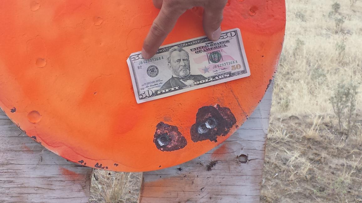

Started at 74.0 h1000 fgm215m at 2.925 to the ogive. At 105 yards it was 4 shots two holes
Went to 75.0 grains and it was grouping very nicely at 495 yards. Made it all the way to 76.2 and found my load. It's running well over 2900 fps and is incredibly accurate. I moved the plate to 235 yards and ..... The bottom 4 are with 75.8 h1000 and the 2 in the middle are with 76.2. I stopped shooting then because I needed a few dummy rounds. Very impressed with the 5r.

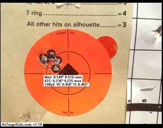

I can't find ant data for the 208 amax and PP4000mr other than a 200 grain Speer. I've got a lot of free bore so I loaded some at 71.5 , 71.8 all the way to 72.4. Coal is 3.615, 2.887 to ogive. Around 10/000 off the lands. With 72.4 r22 the 208 and the 215 berger shoot phenomenal. Rifle is a 700 Ss 5r milspec with a Jewell trigger and a brake. It's the best factory rig I've ever gotten. Was shooting 3 to 4" groups the other day at 900 yards Monday. If this powder shoots like the 2000 mr does in my .308 i will be a very happy man indeed. Will post results....
I had an interesting thing happen which I can't understand other it (71.5) was too low a charge. Pp 4000mr. 208 amax. Rp brass fully prepped fgm215m. . 700 ss5r mils pec. 26" bbl. at 72.4 it was grouping .475". (4 shots at 240 yards ) with absolutely no op at all. I shot the 71.8 loads to get fire formed brass and got sticky bolt and ejector swipes. Alliant lists 72.0 grains max for a 200 Speer. So why it was like that is beyond me.
Also found an excellent load with the 215. 72.5 r22. Running 2940. Same charge weight with the 208 and 2945.
The 208 with 72.4 power pro was shooting running 2950 to 2960. With a zero at 102 yards it had a 4.8" drop at 240 yards. And shot lights out.

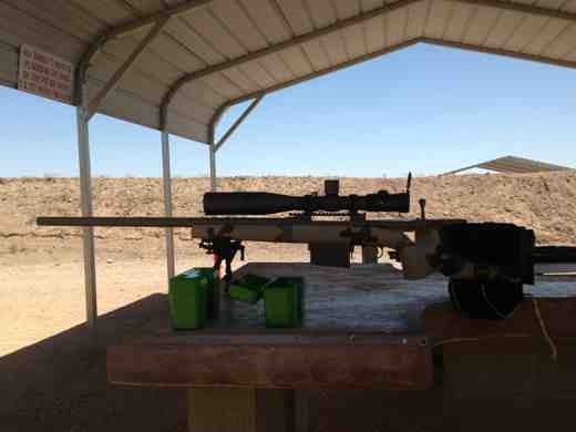

Found a GREAT load with the 215 hybrid. Rifle is a SS 5r 26" bbl in an AICS with a bushnell XRS.
Load is 76.9 H1000 ,RP brass, fgm215m, at 2.952 to ogive (3.715")
Just shot at 970 yards. 80 degrees , 30.03 in/hg, 288 ft, switching winds about 5 to 8 mph.
At 500 yards it's 2.3 mils , at 970 yards it is 6.7 mils. Right at 2900. Maybe just a tad less. Is good to go out to 1850 yards given the right conditions.
