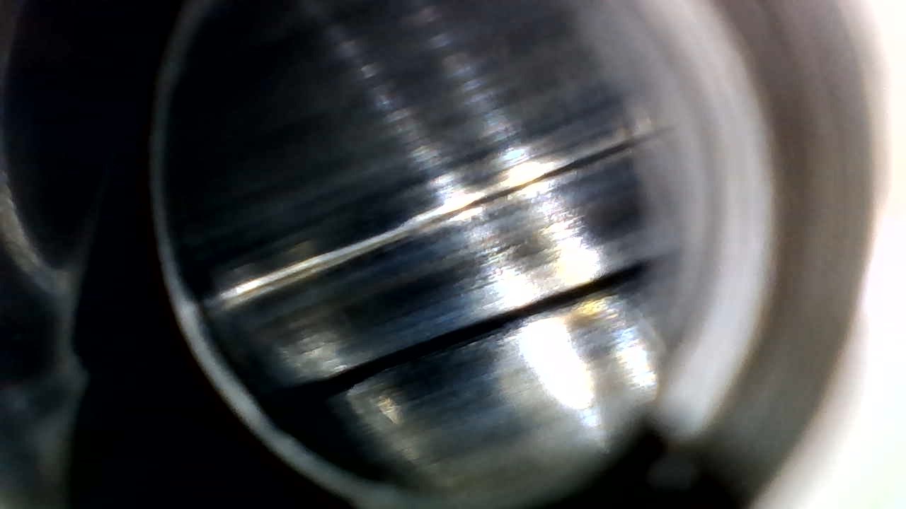

    I’ve been playing with the Warner Tool 160gr bullets in my Sako TRG-42.
    I noticed I had a bit of copper in the barrel, as my patches were not coming out cleanly (without blue/green),
    The barrel has ~800 rounds on it, and I decided to scope it to see what the deal is.
    Interestingly, the first several inches near to throat look like cracked skin (but in steel). There is some light copper build up I need to clean out, but nothing really interest.
    Otherwise, the barrel doesn’t look bad, and it shoots in the same hole at 100.
    What causes that very fine crackeling in the steel? (I shoot suppressed exclusively.)

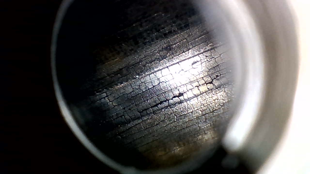

    it could be a combination of the pressure,the heat, and the friction that could be doing that. I've noticed this too with my Savage 300WM.
    I dont shoot suppressed but my handloads are in the upper end of the pressure spectrum.
    Reactions: GBMaryland
    Pressure and heat cause what you are seeing. Expansion and contraction of the metal will wear it down. It will happen to them all eventually, some faster than others. Also depends on how you run it and the caliber.
    Add the harmonics or barrel whip while the barrel is hot. Fire cracking is normal. I have seen it... as little as 100 rounds in my 338 LM AI.

    All calibers can firecrack a barrel. How fast depends on how hot that throat gets. Some of my match barrels are fire cracked in less than 200 match tempo fire rate.
    It doesn't necessarily mean the barrel is toast shoot it until it doesn't.
    I have seen 300wm throats with 1" worth of throat rifling gone and still shooting under 1 moa.

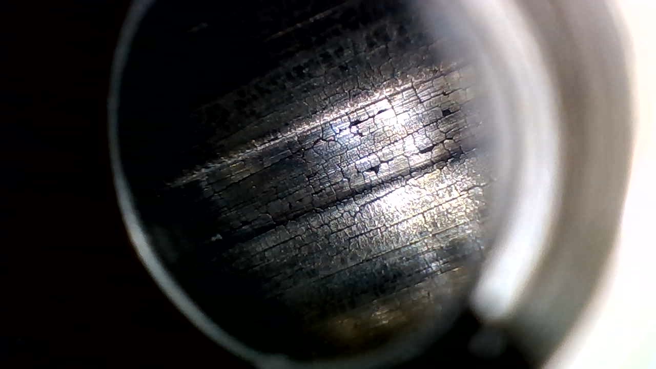

    win_20200707_11_03_37_pro-jpg.7368572
    Up the bore... toward the last 1/3...

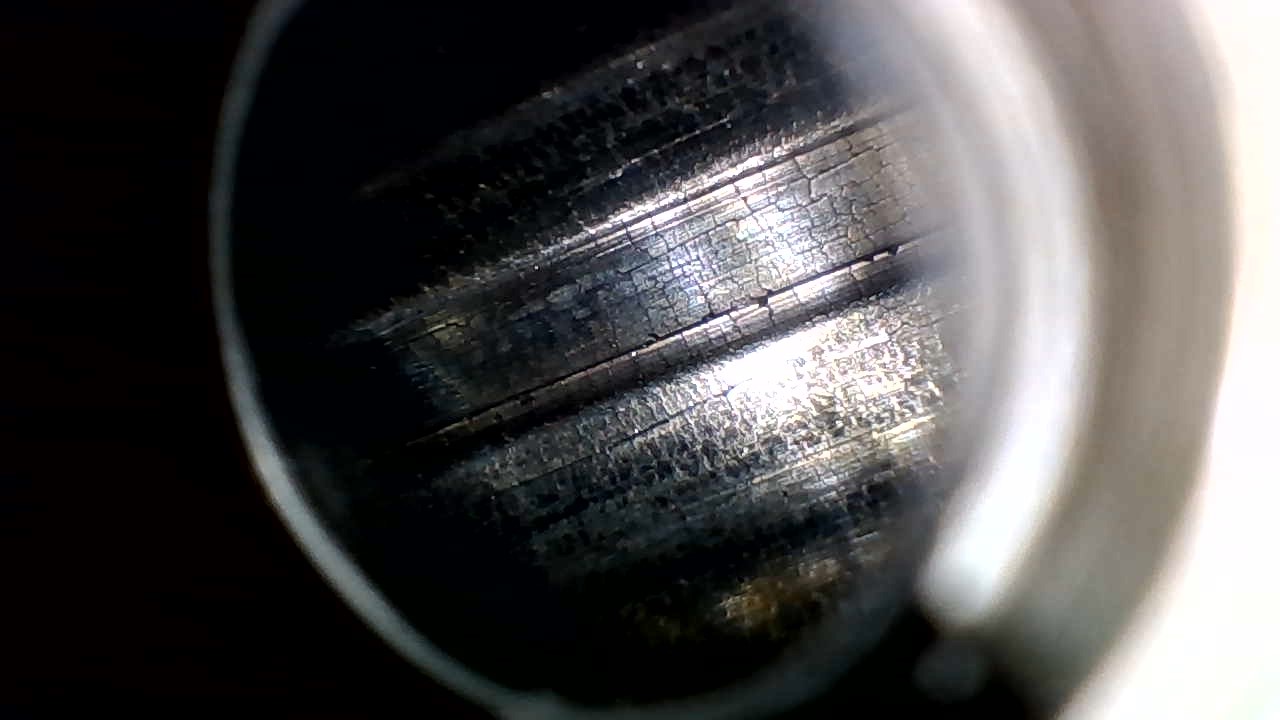

    Followup: Are there types of steel that are less resistant to this?
    Its shoots fine... it's becoming a pita to clean the copper out...
    I literally had to plug one end to and soak it in bore shine to get it this clean...

    Looks like a 300 wm that's not a safe queen. The fire cracking is inevitable but as long as it's not throwing flyers.... Shoot it....
    I fire cracked a 300wm barrel in less than 50 rounds lol

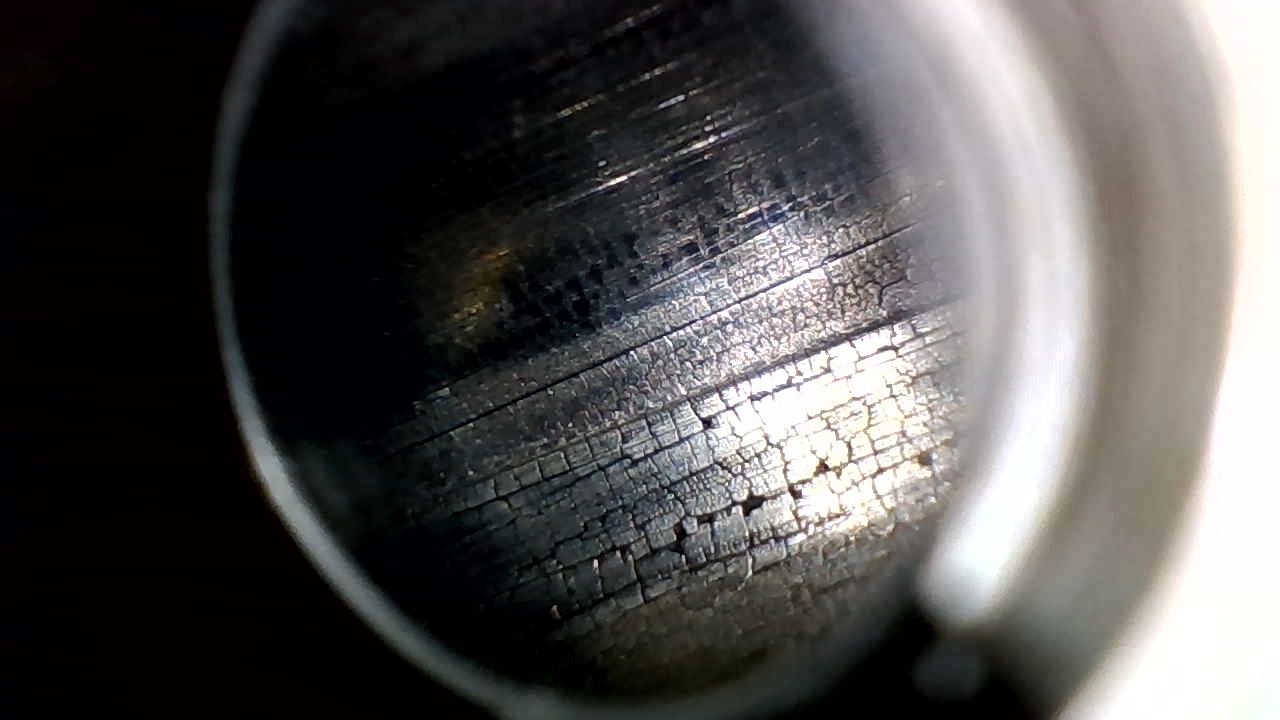

    I also have a 375 H&H magnum that I put about 400 rounds through after purposely building it to see how far I could shoot using that massive round. (The answer is roughly 600 yards depending on the bullet... and no, when when I was screwing around with this crap all we had were the BTBT bullets from nolers.)
    So the other day I decide to see what the bore looks like...
    It looks freaking fantastic compared to my 300.
    Until I get to the end of the barrel… There are literally craters at the end of the barrel... and never had any rust and I’m at a loss as to why.
