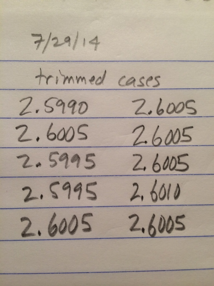

Ok, so just to make sure...too short is ok, too long is not. So SAAMI says 2.600. These are the last I trimmed. They are all ok to stuff? I just want to make sure due to obvious danger factors. Thanks! ImageUploadedByTapatalk1407969179.675072.jpg
This is a great read on case prep and talks about trimming. http://www.snipershide.com/shooting...and-loading-long-range-1-brass-case-prep.html. This is a sticky at the top of the forum, there are 4 others as well. If your trying to load really accurate ammo I would read them all. If your just looking for plinking ammo then you can just trim to book specs.
