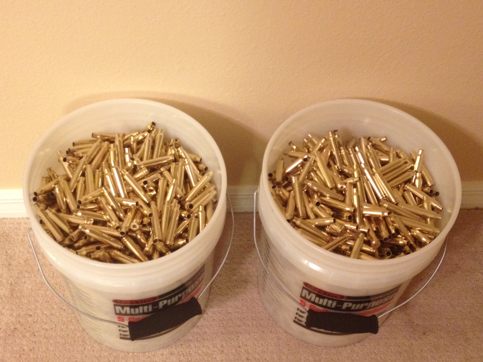

How do I know? This is all FC 07 mk248 Mod 0 brass and it is exactly the same weight as the gold medal match brass coming off Federal's line.
i hate you. . . . :) nice find.
i hate you. . . . nice find.
Last year when 223 and 308 ammo was non-existent a guy I knew won a couple of those government auctions and these were mixed with the 308 brass he got.
I bought them by the pound, ended up with just over 3000 of them, paid about .15 each. 2500 ish of them were FC 07 and there were about 500ish made by Winchester. Every single one of them was perfect and 100% reloadable.
It was an AWESOME score.
