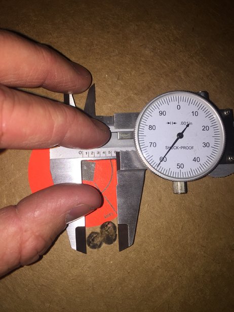

Went to the range tonight to double check speed over chrono got 2550 again over 9 shots. Best group was .252. Hornady brass varget 2.815" Swfa 10x. Been playing with Winchester brass and the 208 amax but not happy with that either.
