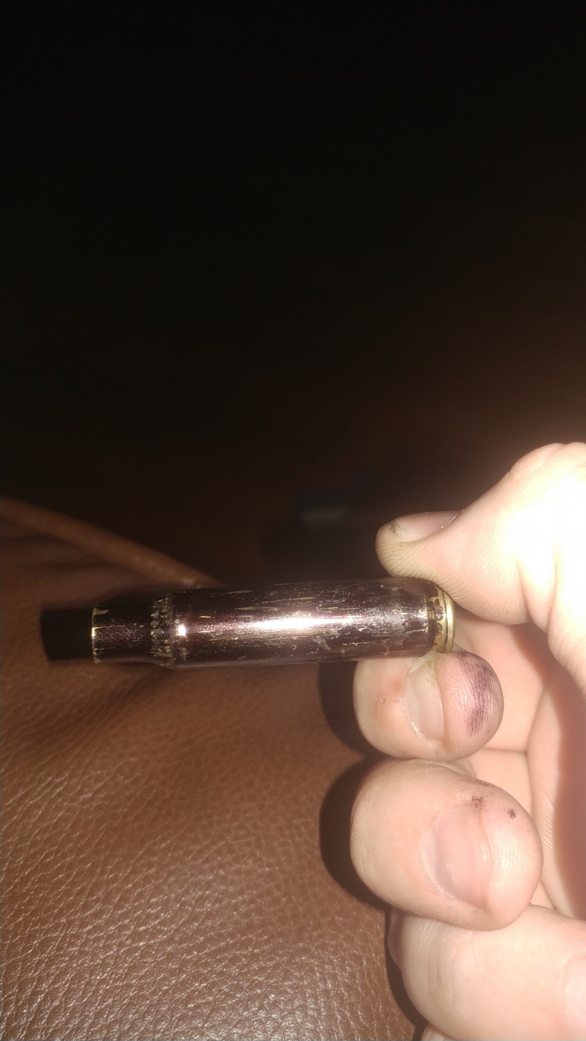

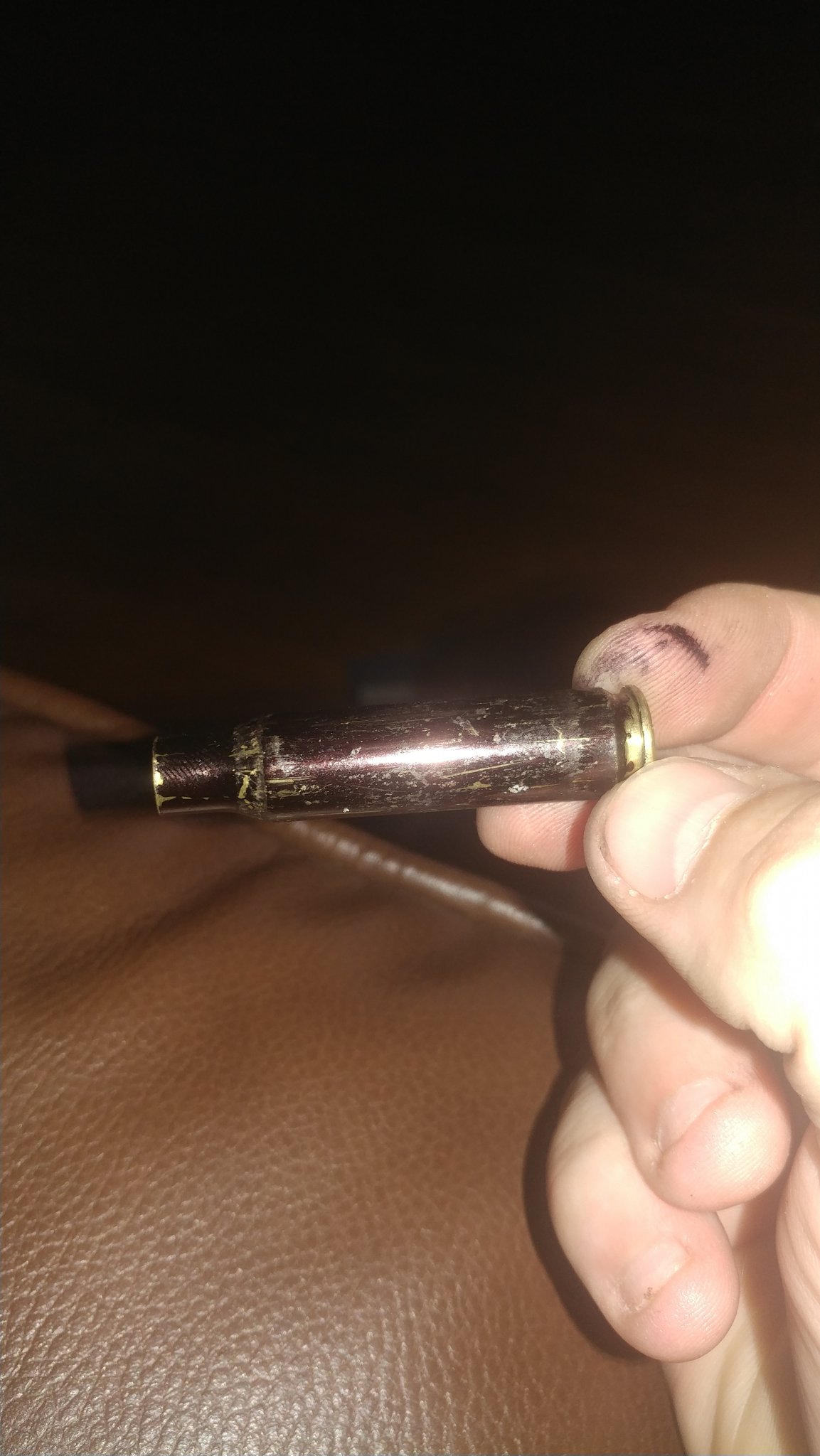

Color a case in sharpie and see where its getting rubbed off.

What you guys think? Ran them back through the resizer and things are going fine. This one wasn't ran through it yet though

Looks like the shoulders have pretty consistent contact all the way around. The base has contact but its not actually rubbing it off so maybe youre getting by alright there.
