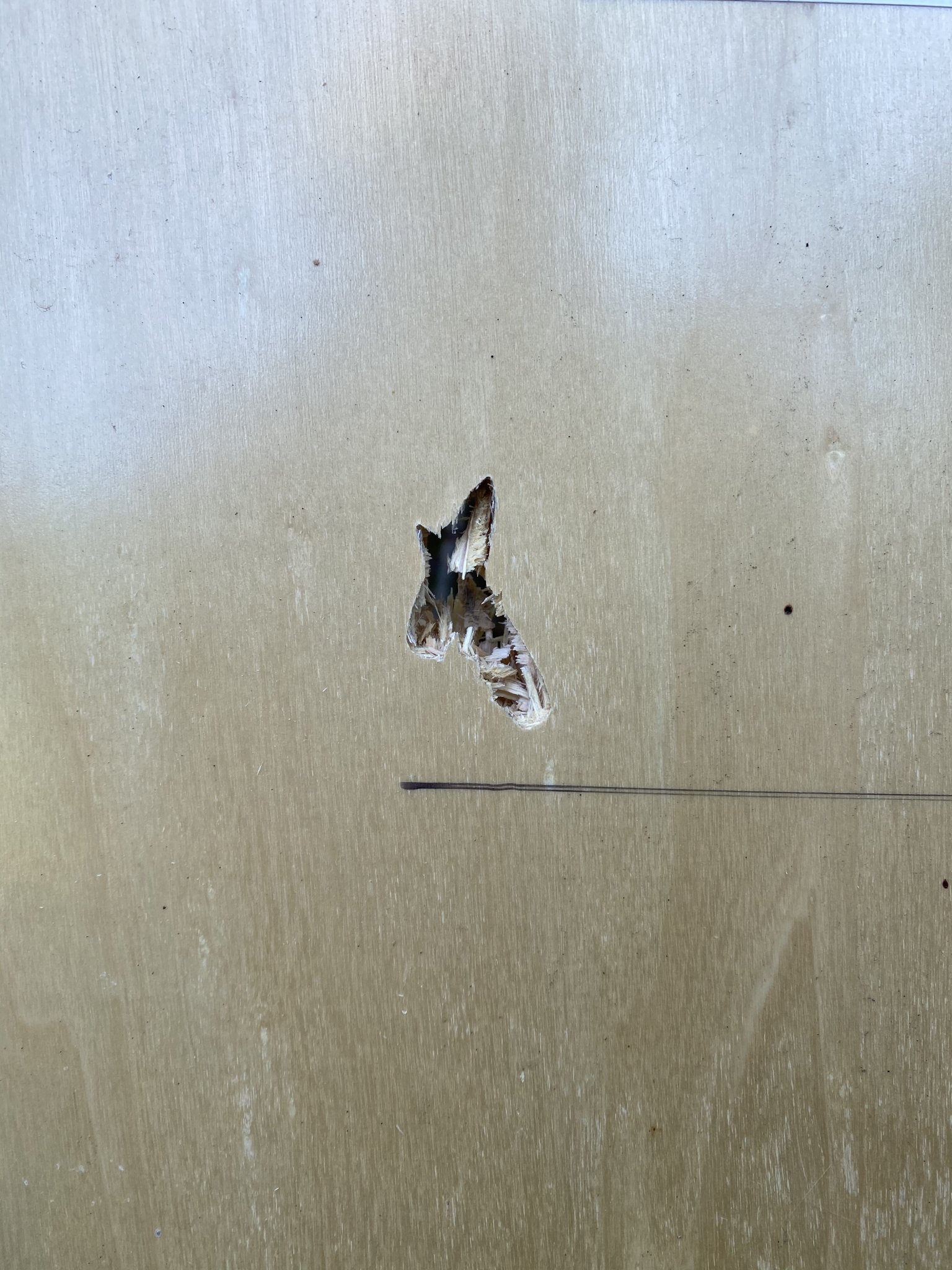

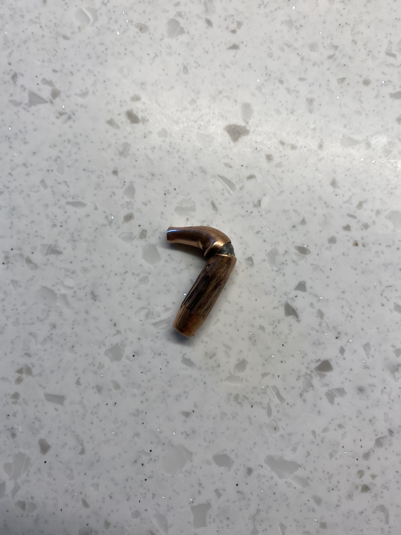

ok so I was doing all this through my savage 10 .308. 20” stock barrel 1-10 twist. Scratch all of the data! The rounds do not stabilize, thank god I was doing all of this before I tried them through my suppressor. 60yrds. Back to the drawing board.
I checked my twist calculator on my computer, I guess I could have saved myself some time and effort. But the specific gravity with all of my variables calculated in is .93! I need to have 1.5 or better to be very stable.
