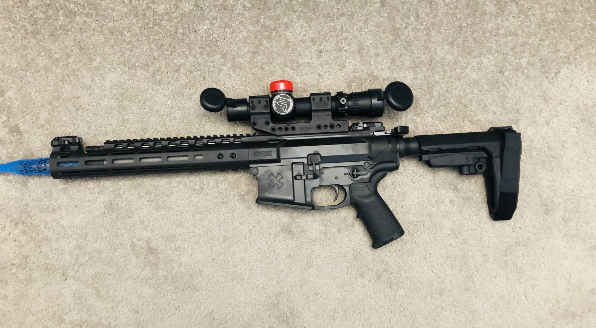

My newly arrived pistol. It needs to be field tesed to make sure its a keeper though.
Noveske N6 Leonidas
