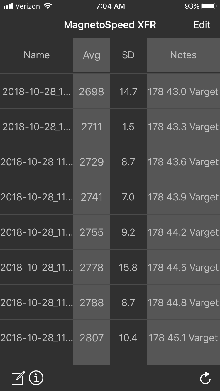

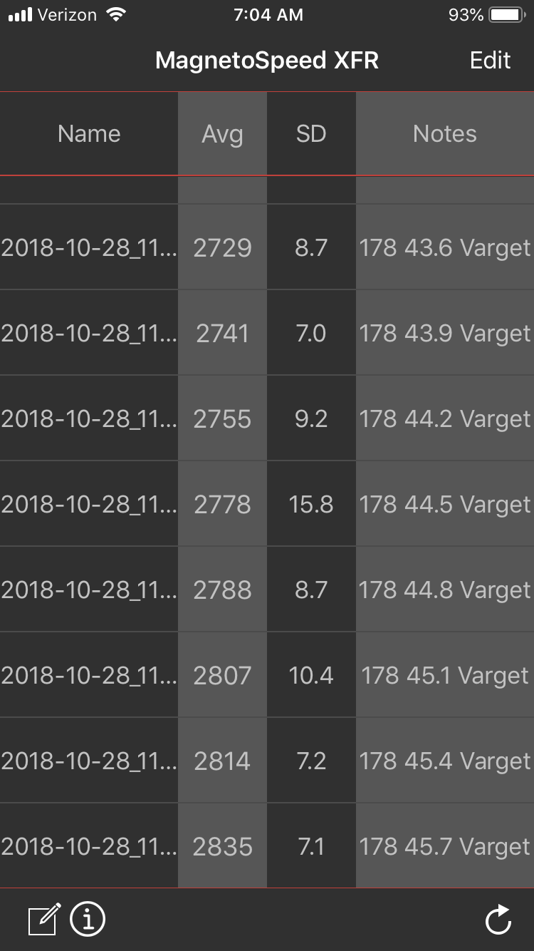

Here is my Magnetospeed data with the 178gr ELDx, Varget, Lapua Brass and a 28” barrel. They were loaded with a long COAL.

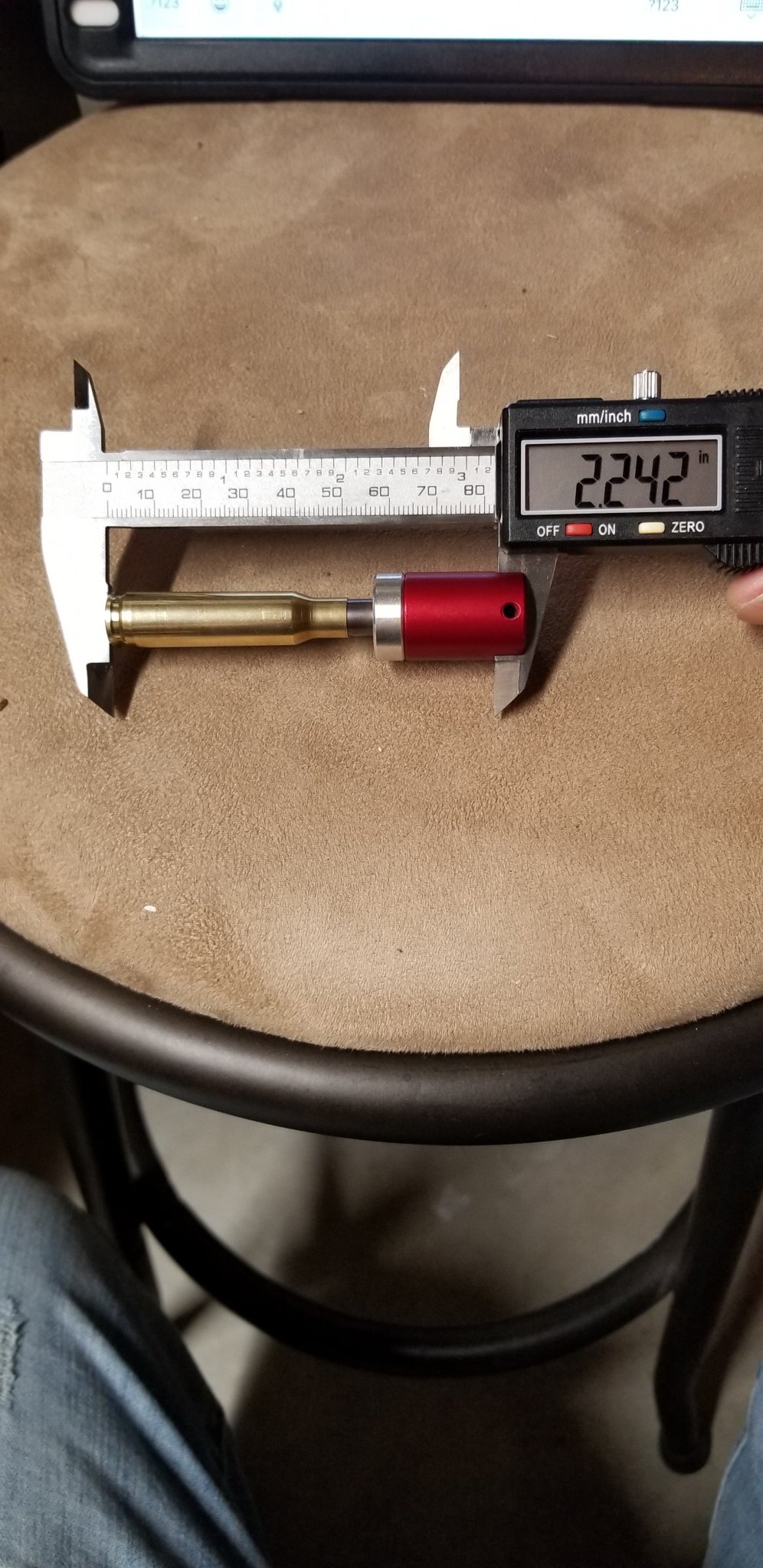

In my AX308 with a 20. I have finally settled on RL-15 (44.0 to 45.5) with the 168 ELD-M, lapua, 210m,
OAL 2.242 with V=2751, ES 13 and SD 6

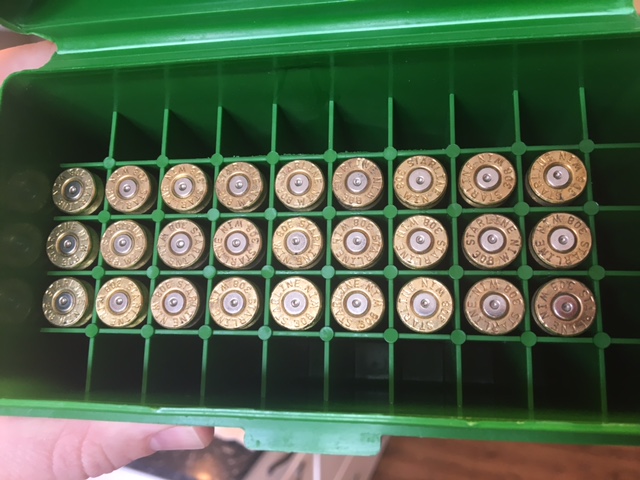

Just worked up a load for my ar10 and I can't really tell if is it too hot or not. Virgin brass not many rounds down the tube like 87. The 168 eldm's shooting off a pretty shitty rest were under 1moa and the best being around 3/4" The hotter i got the better they were grouping like 2 touching and one "pulled" or just a touch off the group. My last 3 groups were 41.7, 41.9, 42.1. The 41.9 was the best group just not sure what to do first time loading for a gas gun. I was in the 2500-2530fps range.....ejector swipes on the brass....a couple hard to extract with the charging handle (adjusted block seemed to help).... bunch of sooted brass.
aero m5 308 20" tbac 7
starline lrp
imr 4064 (seemed really dirty)
fed 210m
168 eldm
Just bought a headspace gauge and the hornady brass to measure the chamber. If anyone has any help im all ears. Trying to figure out if the 168 is the ticket or if I need to jump to the 178.
Dirty brass is from the suppressor, if you're getting ejector marks maybe back the load off .5gr. I use 42gr of 4064 in my M1A with a 168 and I have no issues, even with LC or other NATO brass.
Thank you i will try to clean them up and get a good picture to post.
Tried to get enough light. From Left to right 39grs-42.1grains of imr 4064. They were also setting in the sun for most the ladder I moved them in the shade for the last 9 as the sun was beating down and probably 60F
All of your primers look fine. I would say adjust your gas system until it won't cycle and then back until it will and see what happens there.
Yeah that is how i started off the batch and finally had it halfway open (6-7 clicks) half way through. I have a headspace comparator coming as well. that had me a little worried. My die is set at 2.800 but they were seating at like 2.805-2.810 or a little more. I was thinking about measuring the chamber to make sure im not in the lands.
