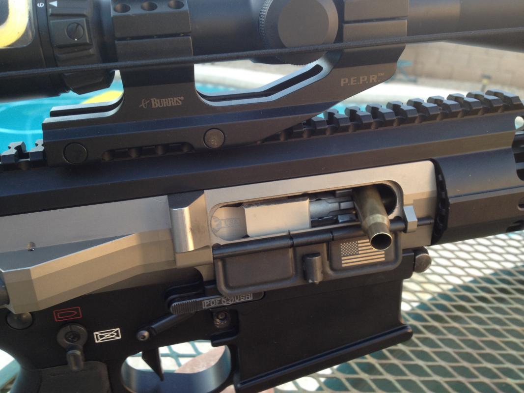

Having some issues with my .308 reloads "stovepiping" 20% of the time on avg
NO issues at all with factory ammo
Using once fired LC and WIN brass, sized trimmed and chamfered to specs per my Speer manual, using RCBS AR series small base dies
CCI 200 primers, Varget and H335 powders, speer 150gr,168gr and Nosler 165gr projectiles.
all powder charges were measured one at a time at different levels from 41g to 46g (Varget) in multiple test batches of 10 rds.
Rifle used is a POF P308 20", again NO issues AT ALL with factory ammo, so the issue must be with my skills or equipment.
Best description of the malfunction would be.. round fires, spent case gets caught by the bolt cycling forward and partially chambering a fresh round.
I'll try to post a "simulated" pic
I have had no issues with my 9mm and .45acp reloads as well as my .223 reloads

No sir, no evidence of damage to the case rims from the extractor.
I had assumed I was under charging, so I stepped up the charge level .5gr at a time with the same results
suspected an out of spec die, but sized case measurements are in "spec" but a few thousandth's larger than factory new ammo
I am going to assume your gas system is adjustable on your POF P308. Try turning your gas system down so it does not eject a round a round and start turning it up till it does. When I started loading for my JP 204 Ruger this was recommended to me so I was not over gassing the system.
Have you tried making three or four dummy rounds and cycling them by hand? Do they drop into the chamber and come out easily? My be is your bumping the shoulder back too much on your sizing an changing the headspace. This will cause a tight chamber fit and slow ejection. Small based dies are just that, smaller. They can be finicky to set up for sizing. I had some that dropped into and out of a Wilson case gauge easy but were bumped back just enough to cause extraction problems. When I tested them in my bolt gun they where hard chambering. Readusted the die and viola!
MtnCreek, thats what I originally thought but charge levels made no difference. No chrono yet and mixing brass with same loads.
Danco, I did that when I set up the die 6 months ago.. I need to do it again as I really think it may be the issue.
caveman, no dents on the brass. In fact some of the spent cases dont even make it off of the bench
It sure may be something else, but as NICETRY said give that suppressed setting a try and see what happens.
