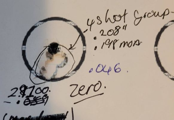

Any of you tried Barnes 175gr Match Burners?
I am currently using them for F/TR but looks like it would be good for PRS.
I have had consistent sub 1/4 MOA groups at 100 yds
Savage 12 FV 26" varmint contour BBL
175 gr Barnes Match Burner
44 gr IMR 4064
Win Brass
S&B LR Primers
COAL 2.91
2750 fps
168 gr a max
42 gr imr 3031
3.8 in c.o.l.
2700 fps 18 inch ar 10
Vortex diamond back tactical 4x16x50
5 shots in one hole at 100

As a follow up to what I ended up with for load I'm attaching a couple of my test targets. I do a full work up with my Labradar data along with the target to show SD, velocity, load data and group. I don't mess with chasing zero until I settle in on a load and then tweak zero setting. Attaching a couple of my data sheets for reference.
