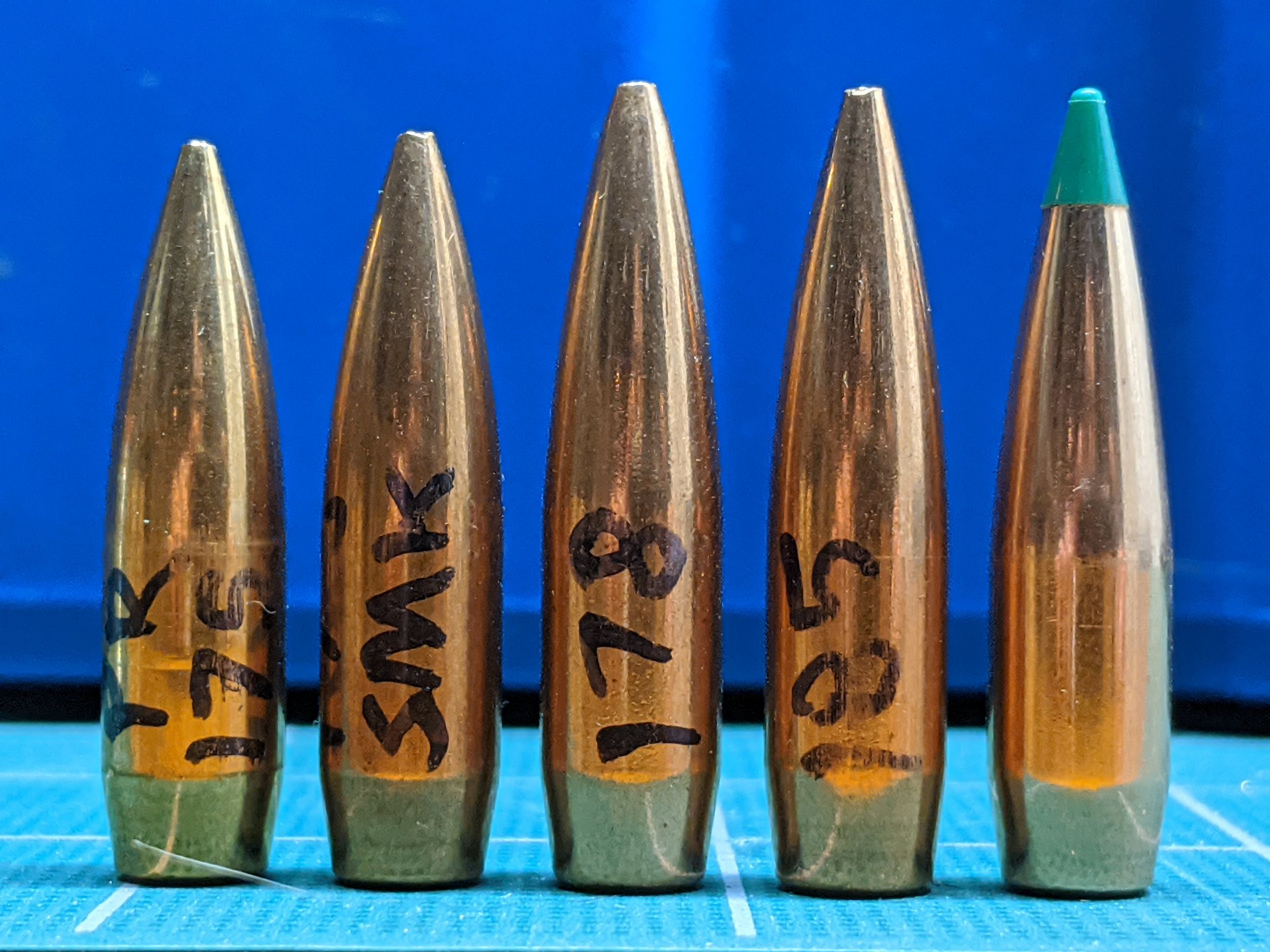

    IIRC, 175 Prime was @ 2595 and 175 FGMM was @ 2625 in my .308. The prime bullet is also not a Sierra SMK, it's a Norma 175 pill IIRC. I was using a .24 G7 trued bc to fit my dope. YMMV, etc.
    L to R: prime 175, smk 175, 178 bthp, 185 jug, 168 tmk.
